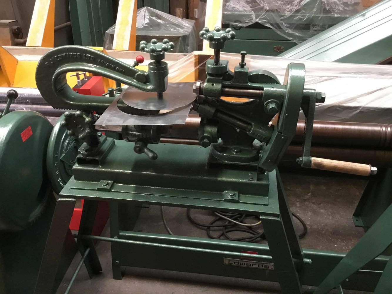

F J EDWARDS Manual Circle Cutter - WNS - W. Neal Services Ltd
Used 6" Cutting Throat 11" Bowed Throat 1.0mm Capacity Mild Steel Manual Operation c/w Stand Quality Design & Build Traditional British Design UK Manufactured Spare/Additional Blades Available 3 Months Warranty* Part Exchange Consideredwww.wnealservices.com
these come up for about 150-200 on occasion.

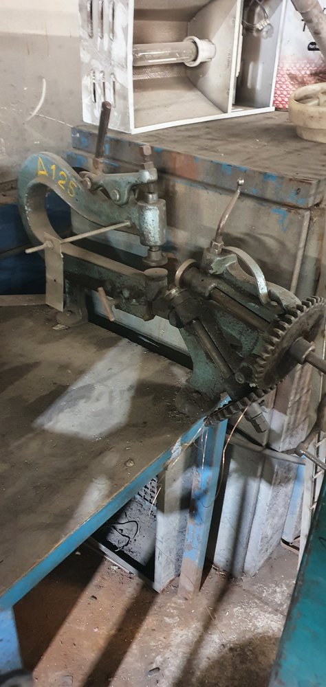

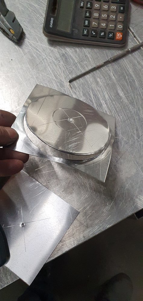

View attachment 386002 this is lying in work I tried it once but made a mess I'll dig it out and have another go,
shame ,,, you just want it to be betterView attachment 386082 smallest cut is 116mm wheels need sharpened I'll get a proper look sometime this week but as it is it won't do
I was thinking the same looks like a bean can lidshame ,,, you just want it to be better
Yep ,,, but it is an Edwards bean can lid ,,,, lol . I was expecting a sort of spun like appearance , all nice and sort of Fred Diphna hand made in England look , Mind you if those boys had a laser those steam engines would have been knocked out in half the time ,,, thats progress I guess. Just when you get the gear to make building stuff easy , no one wants the stuff thats easy to make.I was thinking the same looks like a bean can lid

thats basically what the Edwards one is ,,,, like a tin opener only bigger ,,,You could make a circle cutter attachment for a bead roller.

I'll have another look at it, wheels definitely need sharpened and a few other bits need looked at it should cut a lot better than that, I only plan on cutting 1.5mm aluminium, too many projects at the minute I wonder can anyone on the site sharpen the wheelsYou could make a circle cutter attachment for a bead roller.

That's a better looking one we had one like that in the last place with measurements and a wheel to wind it in and out, this one has been beat with a hammer, these old machines are brilliant when looked after but in their lifespan you'll always get some monkey putting something in it that it wasn't made forView attachment 386232
when you zoom in this things doing what you think it should ,,, same ad , jus a different picture ... must be the wheels are blunt or just not set up for the thickness
o thats the truth ,,, I know where there is the most beautiful old folder sitting , but the farmer who owns it tried to bend a new spring eye with it in a land rover leaf spring ,,,, the cast side broke , it was only meant for 1.4mm steel , not 8mm springs ,,, I look at it and could weep .....That's a better looking one we had one like that in the last place with measurements and a wheel to wind it in and out, this one has been beat with a hammer, these old machines are brilliant when looked after but in their lifespan you'll always get some monkey putting something in it that it wasn't made for
