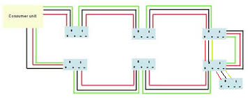

Ive put a new kitchen in and extended some of the old sockets that were hidden behind the base units to inside the units but now it trips the earth leakage circuit breaker if I plug a kettle in, the radio works fine though.
I've done 2 sockets in total, 1 of them also has a spur off the original which works fine.

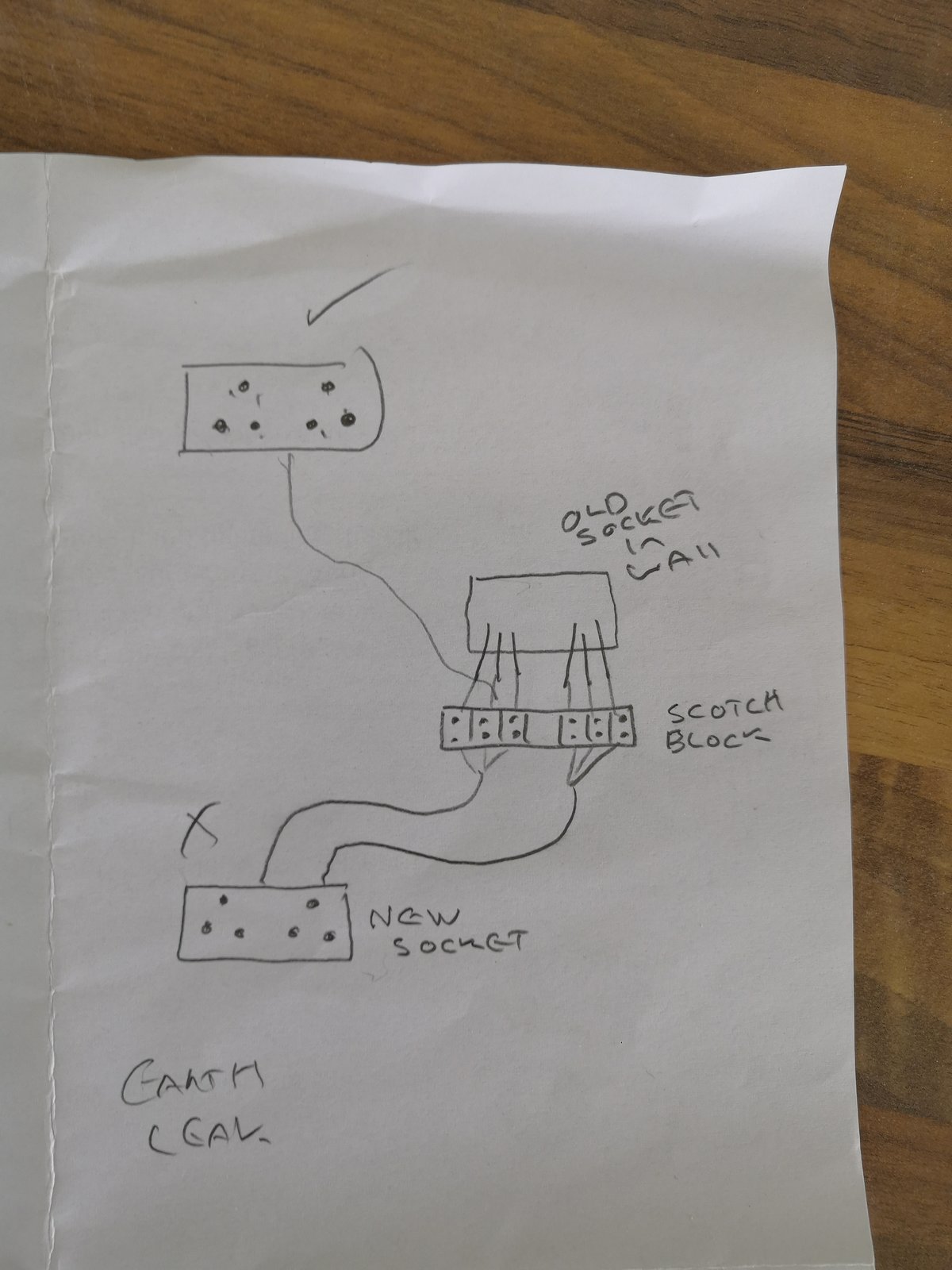

I did it as per my diagram with a chocolate block connector pushed into the wall box and wired in 2.5. The wall boxes now just have blank face plates attached.
It seemed pretty straight forward but I seemed to have messed it up.
