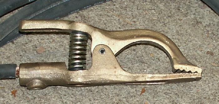

shenion Tool Pack Rat Messages 7,582 Location Stone Mountain, GA USA Jun 29, 2008 #5 You can get better clamps. The Clarke one is ok, but the clamping force is weak. I like the Lenco style claps. They are solid bronze/brass with a real strong clamping force. I have 2, one actual Lenco and a Chinese clone. Bothe work great. I got them off ebay.

shenion Tool Pack Rat Messages 7,582 Location Stone Mountain, GA USA Jun 30, 2008 #9 Here's the Lenco style clamps I have. They work well: It is a 300A clamp. Almost takes 2 hands to compress spring to open more than 1" They werk well.
