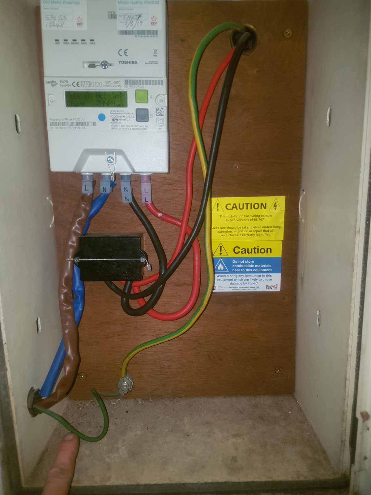

the mains tails look to be single coated instead of double insulated bet you wish you never asked nowHere we go. 10mm is my cable to the cu
Oh man does that mean it will not pass a safety.checkthe mains tails look to be single coated instead of double insulated bet you wish you never asked now
It almost looks as if the meter fitter has sleaved them with something to identify new colours, not seen it before strange.the mains tails look to be single coated instead of double insulated bet you wish you never asked now
your responsibleOh man does that mean it will not pass a safety.check
I have some off cuts from a 3m set of tails they will be long enough if I have too.just replace them if its picked up on report
