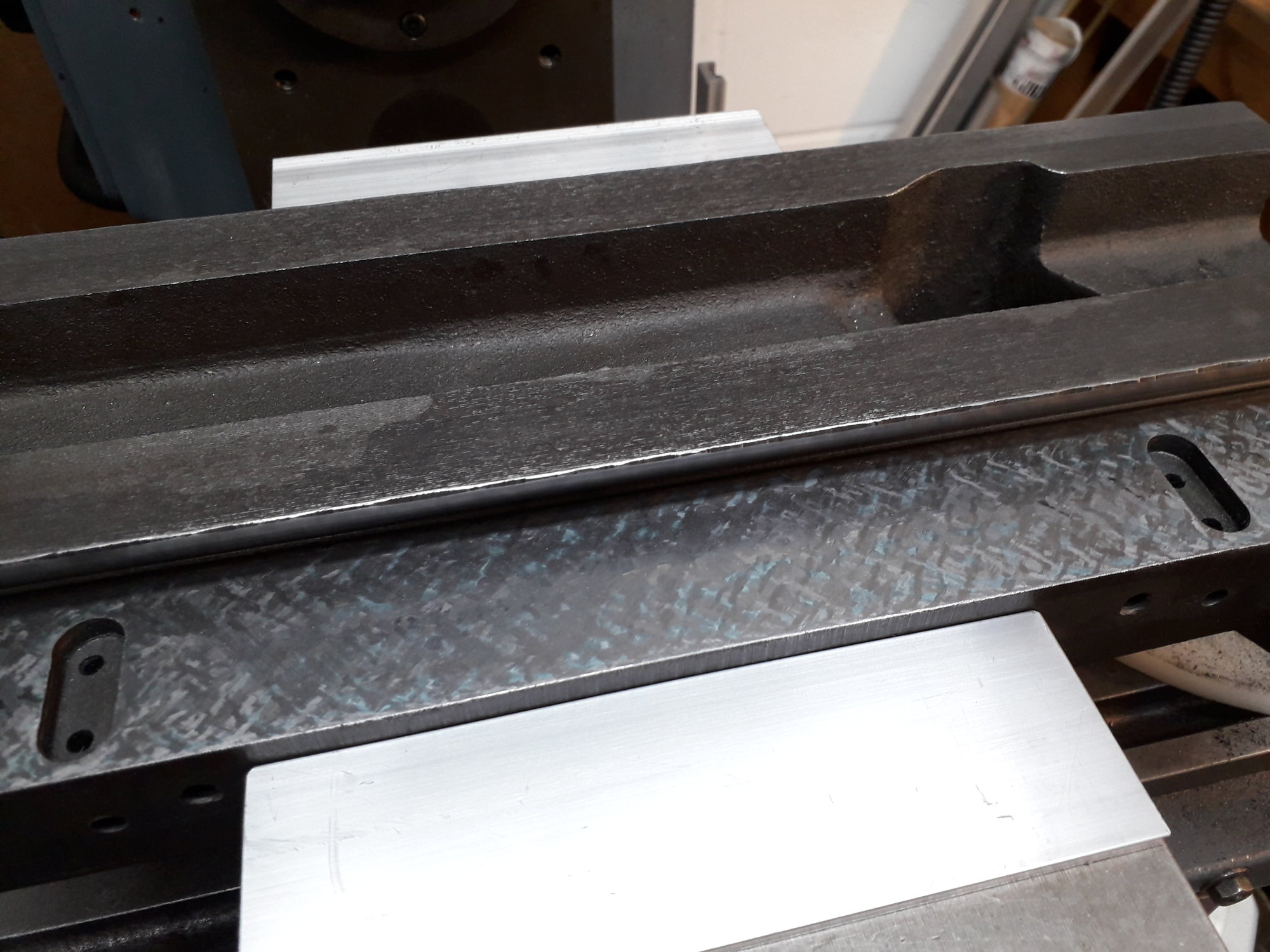

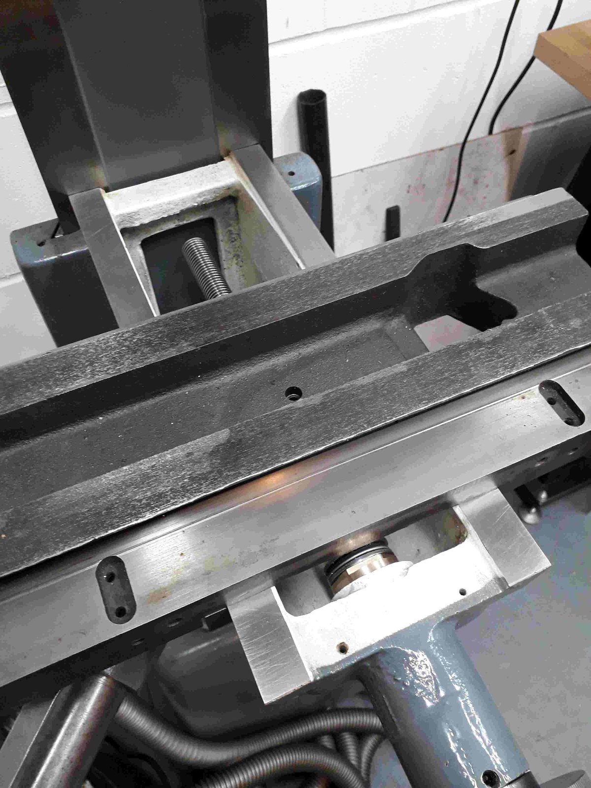

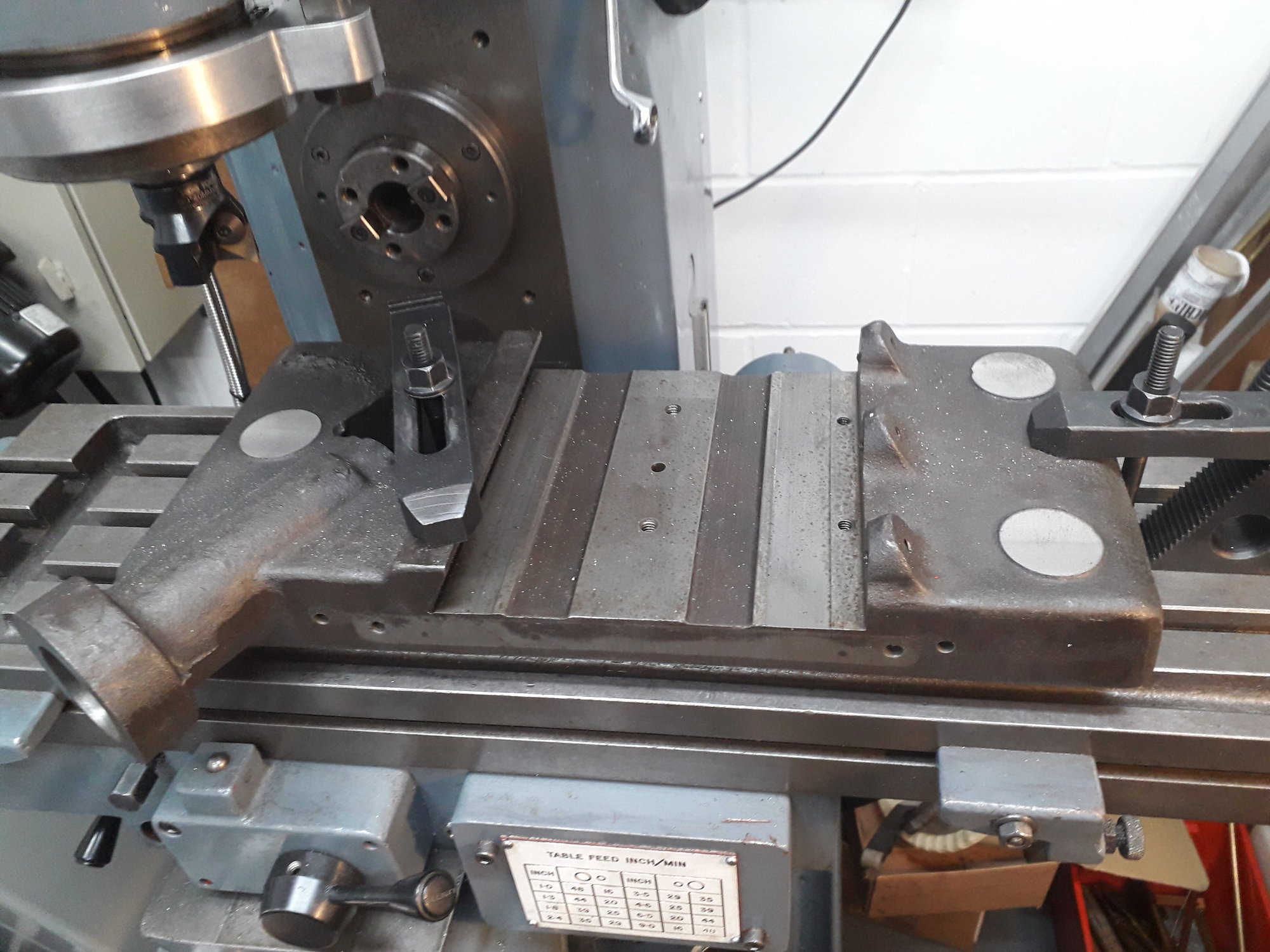

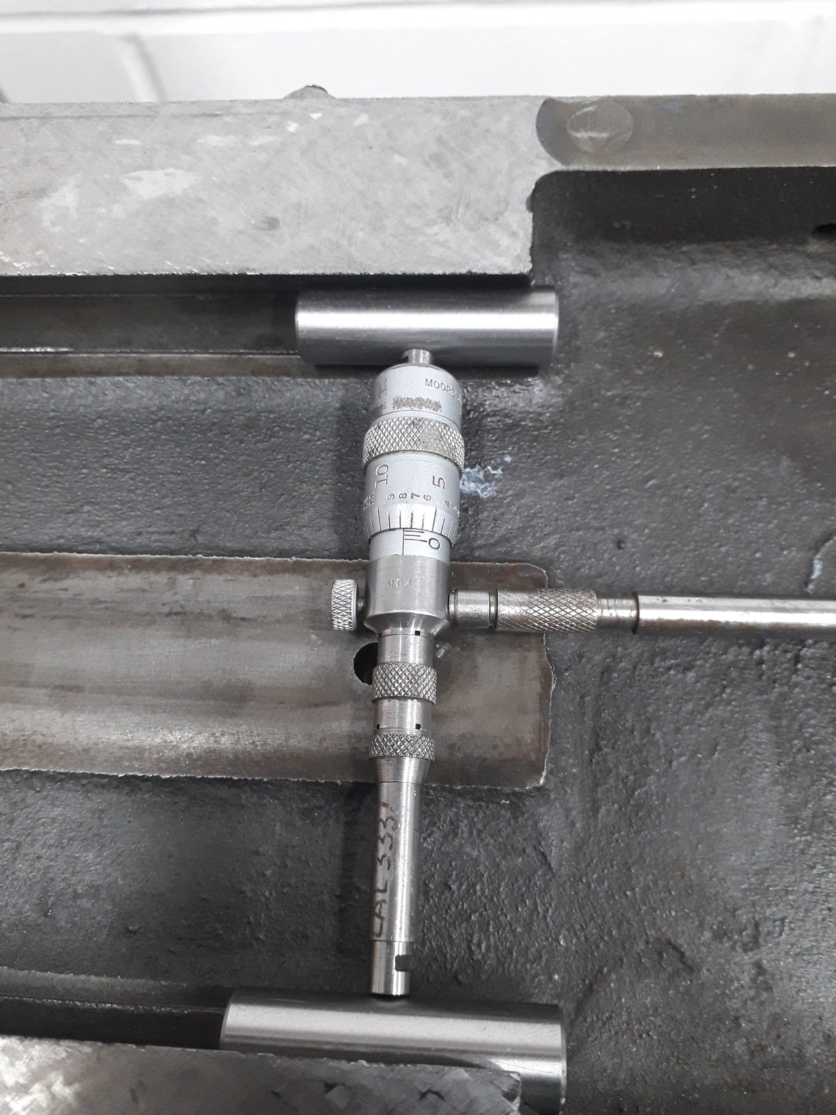

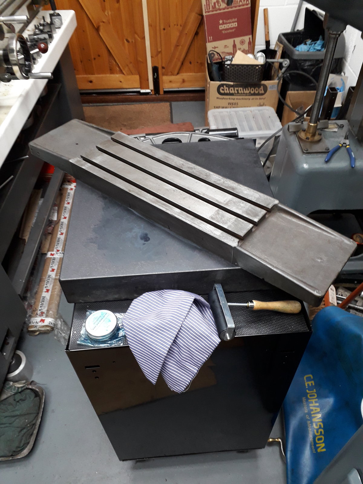

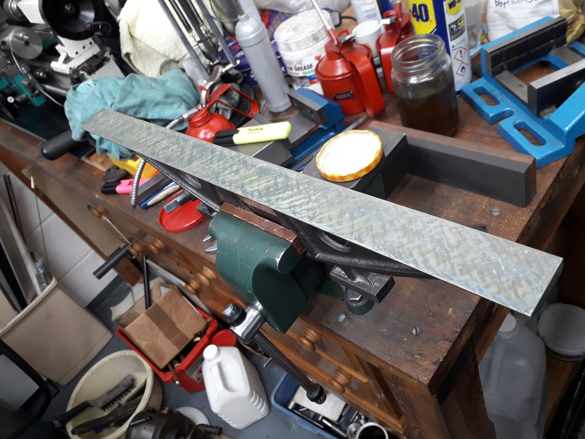

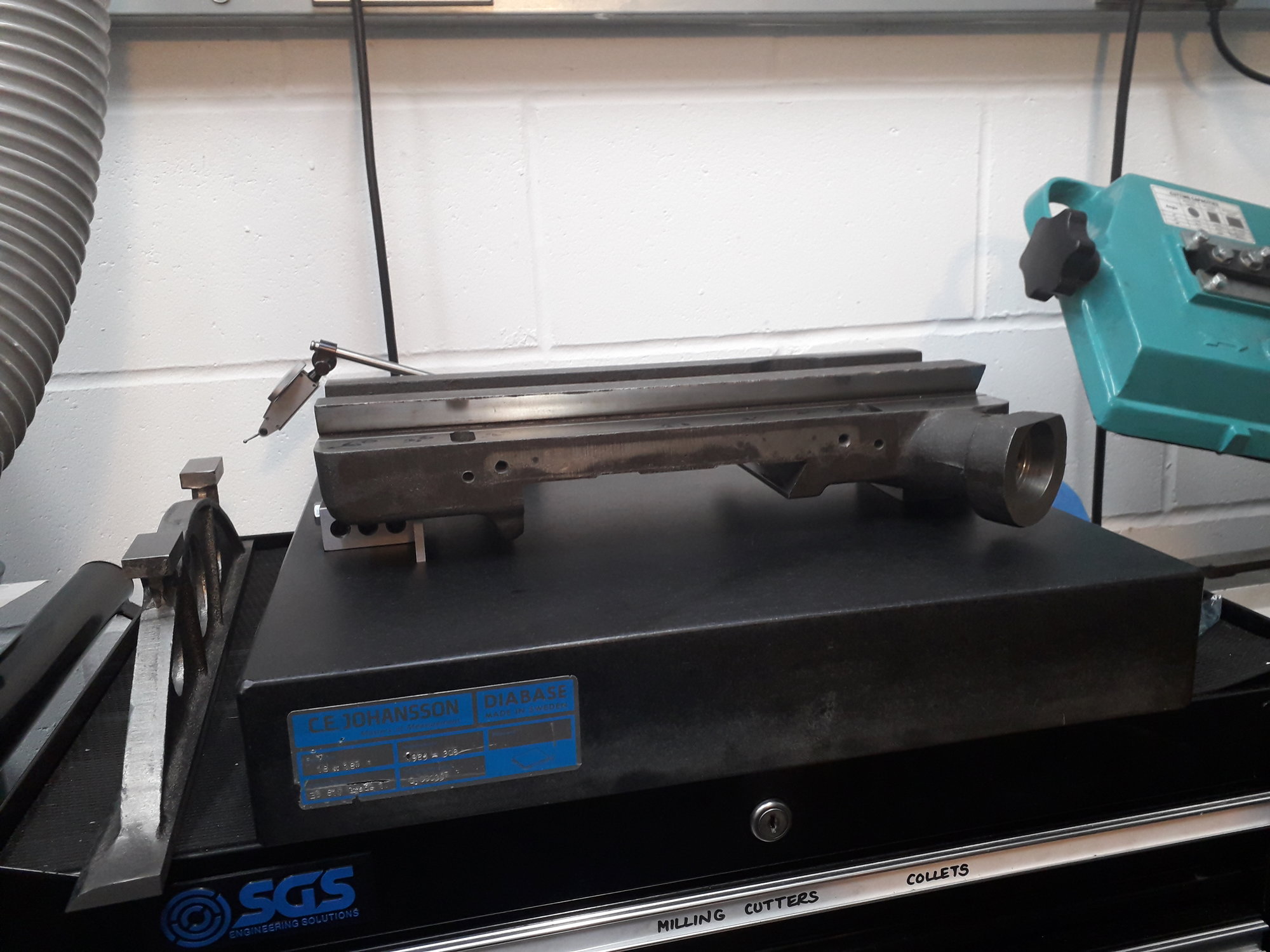

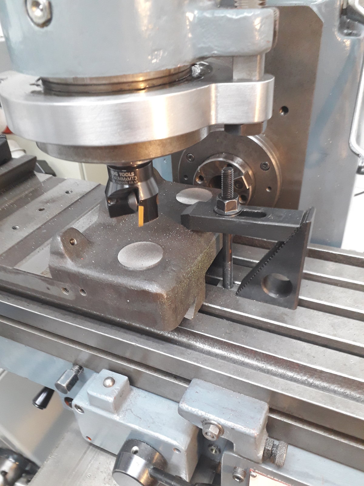

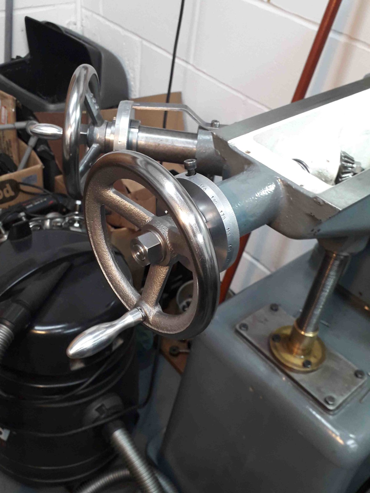

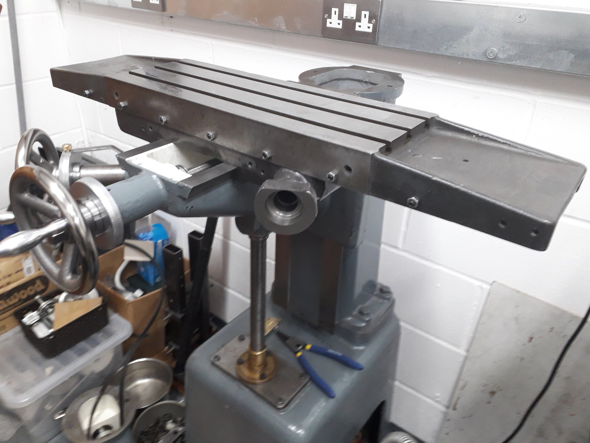

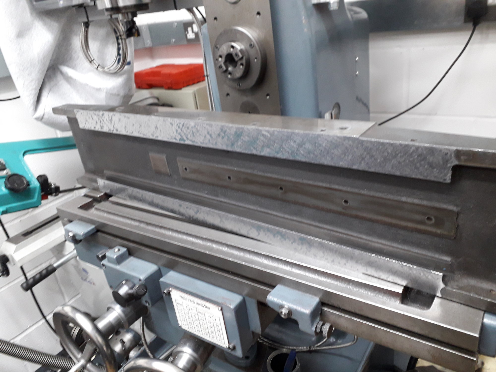

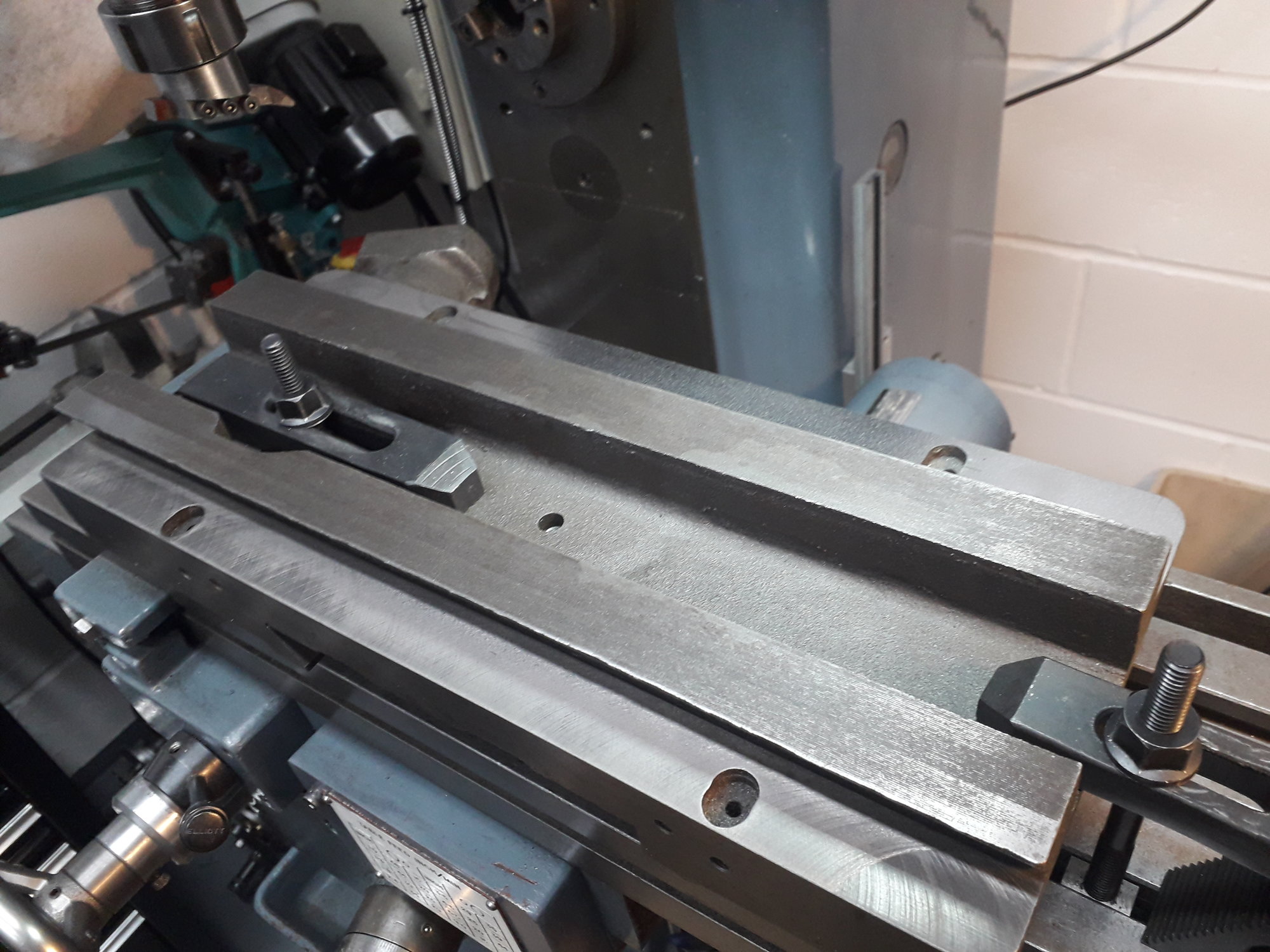

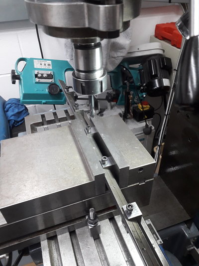

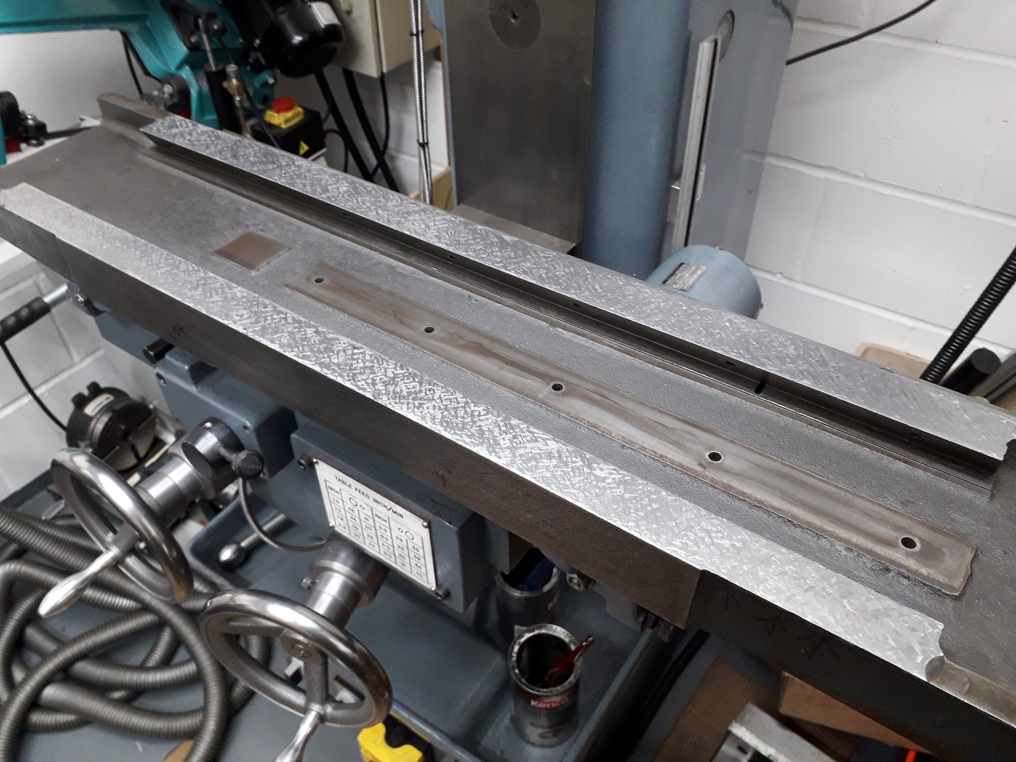

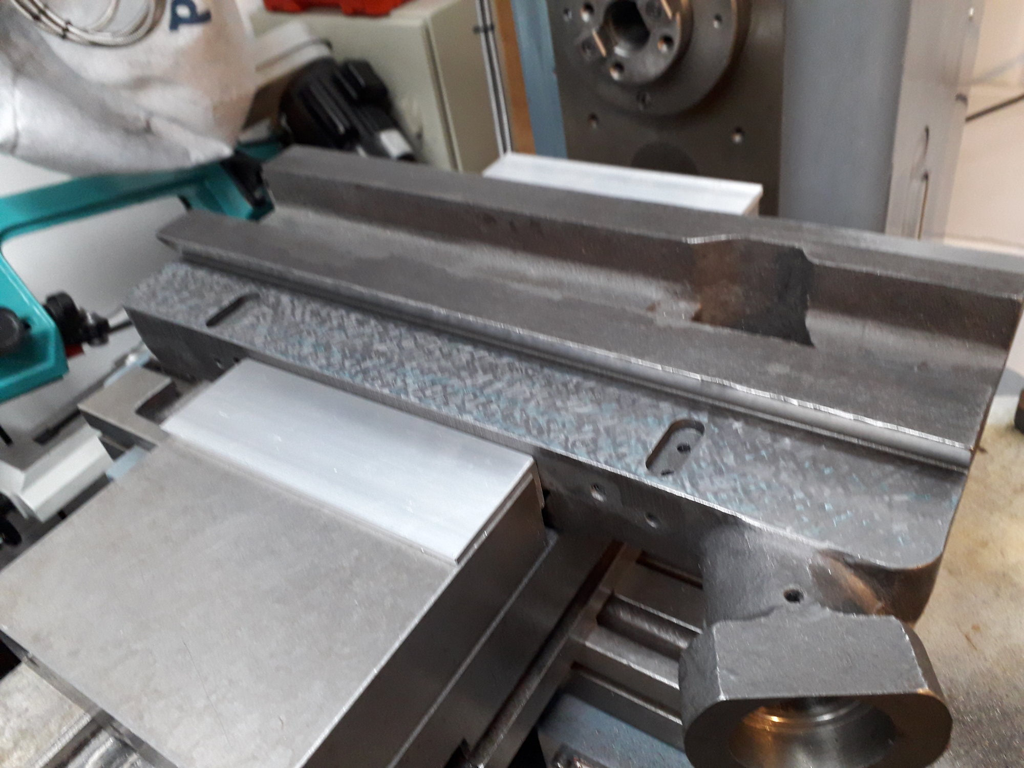

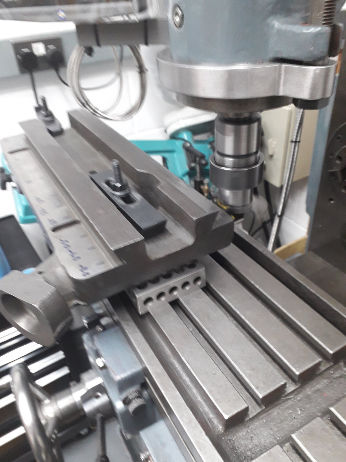

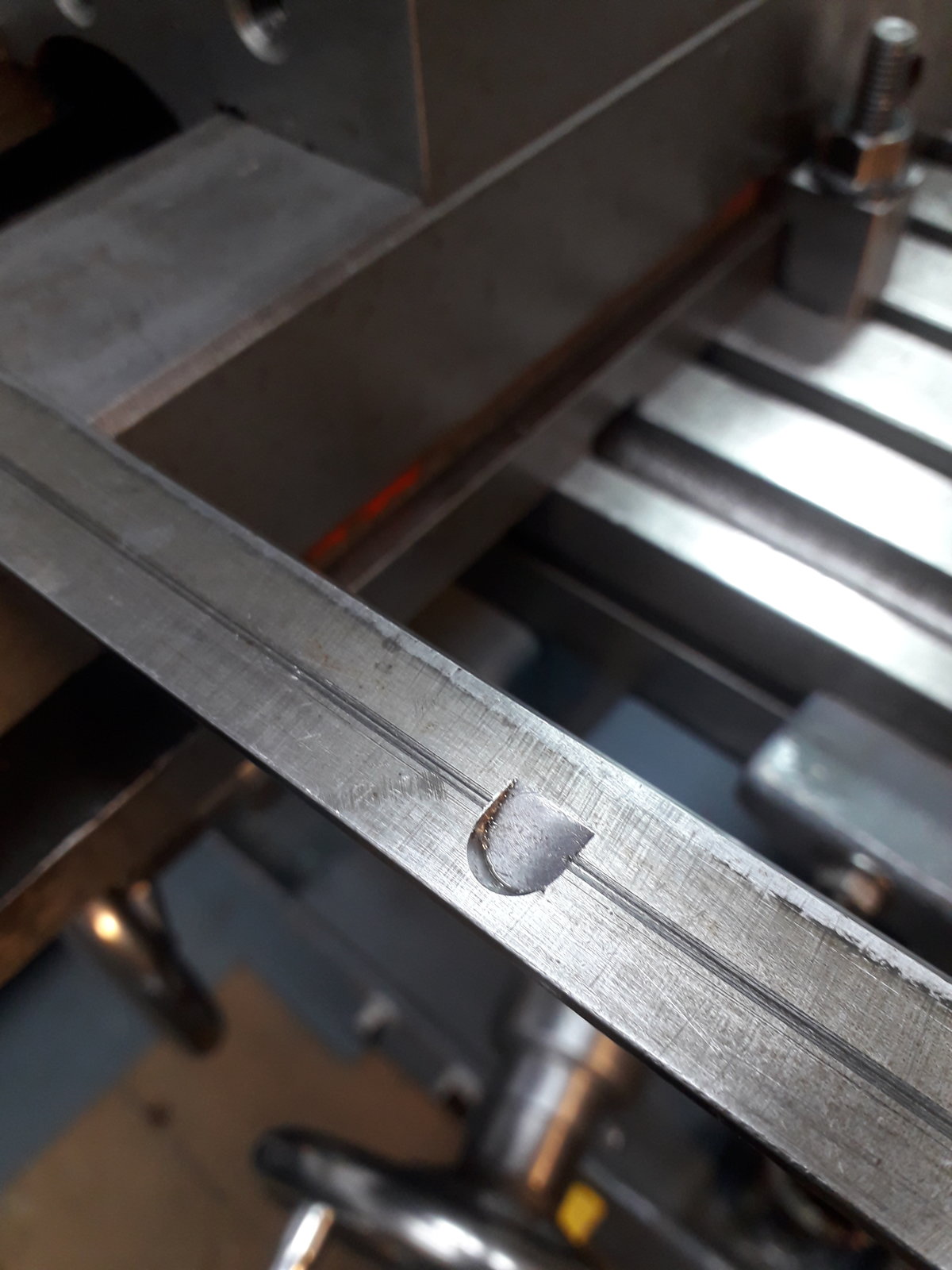

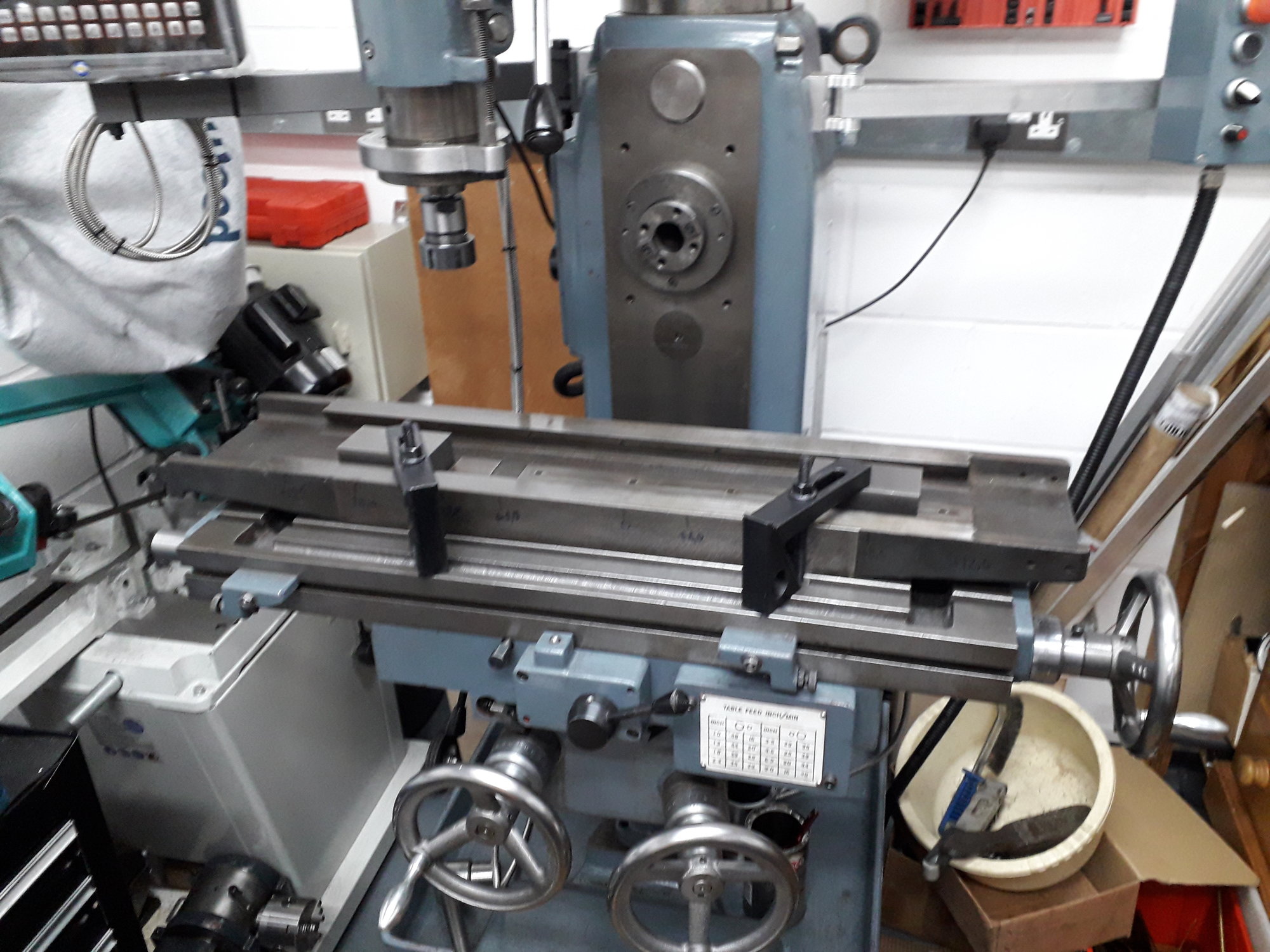

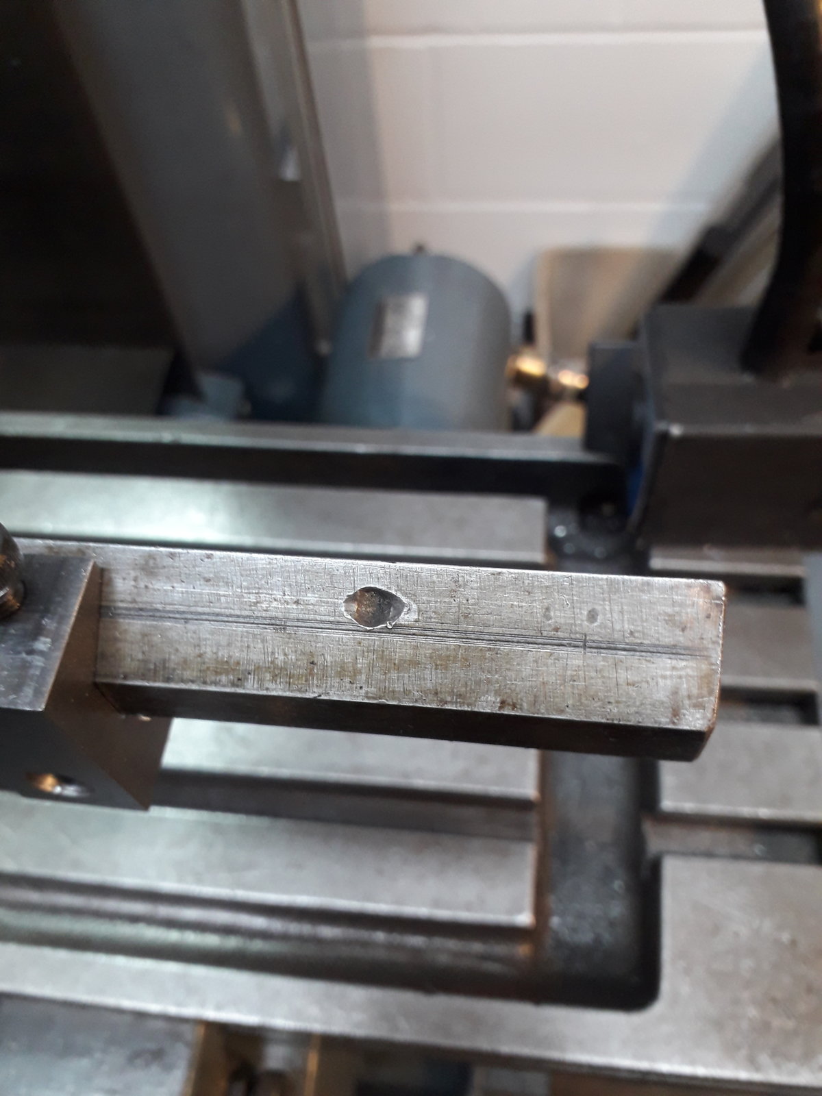

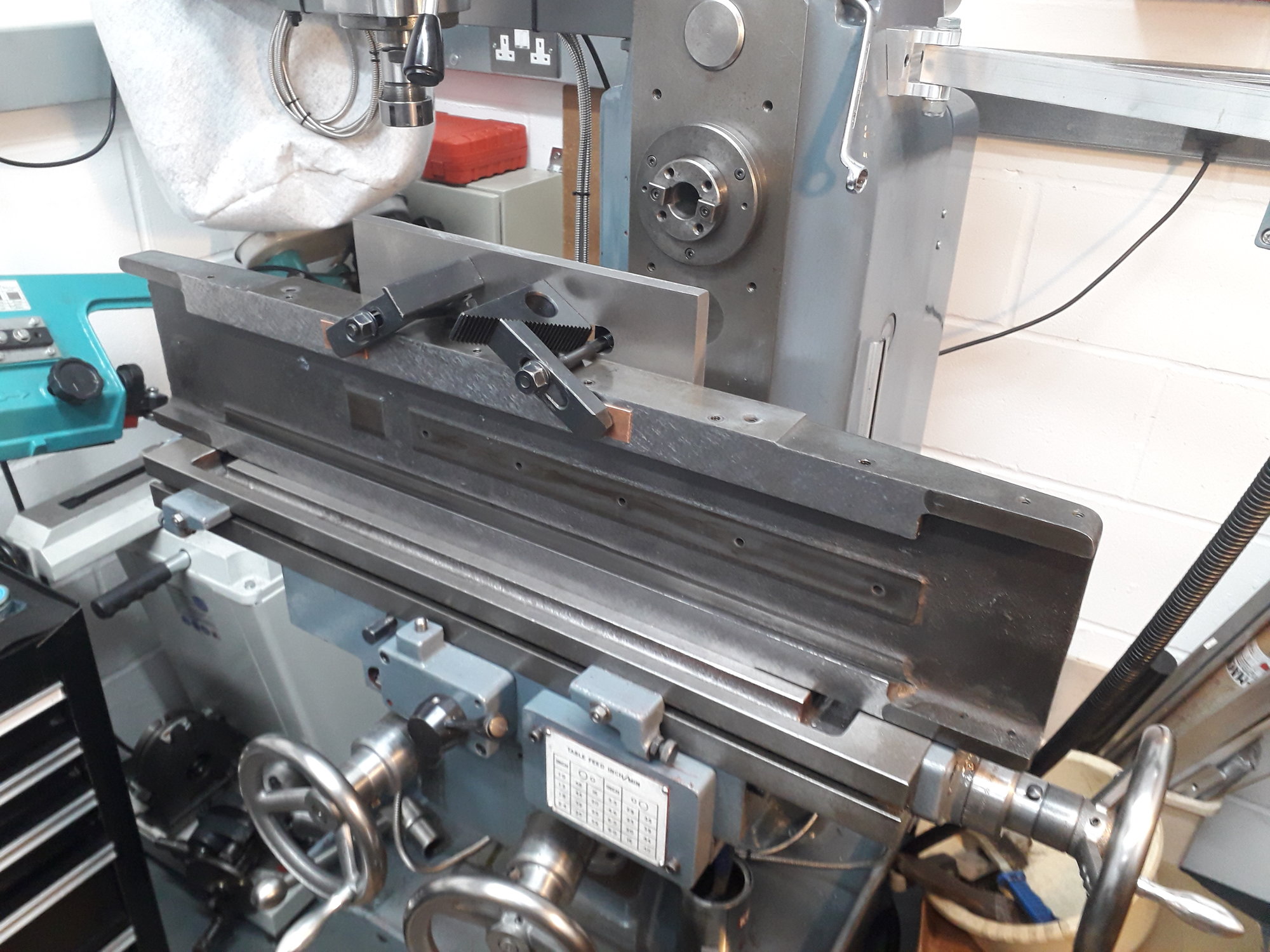

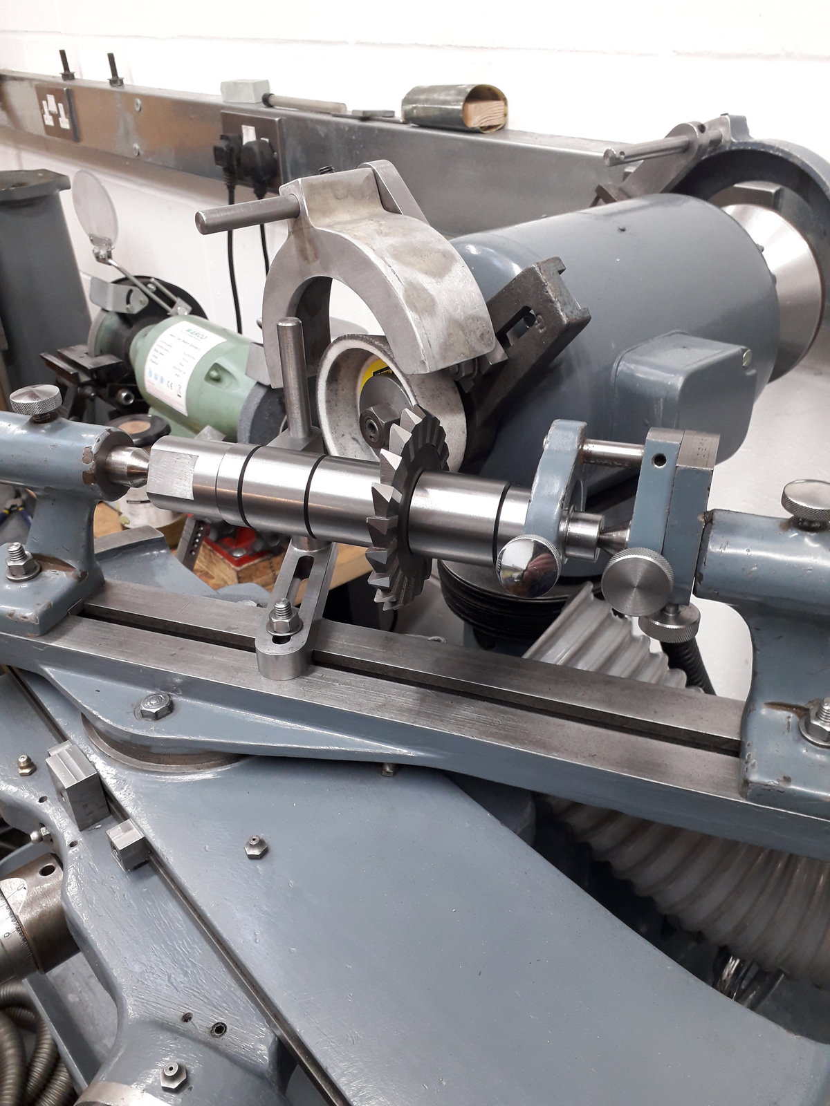

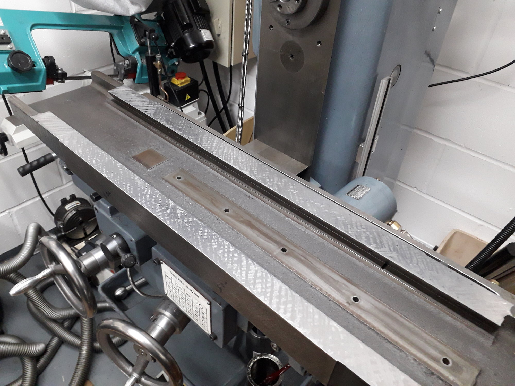

I decided to teach myself how to scrape. Not having the time (or money!) to do one of Richard King's courses, I've had to use Youtube as a source of guidance, followed by the usual trial and error. So, for any of you experienced scrapers out there looking at that and thinking "that's not very good...", in my defence this is my first attempt at this sort of thing and I was quite pleased with the result.

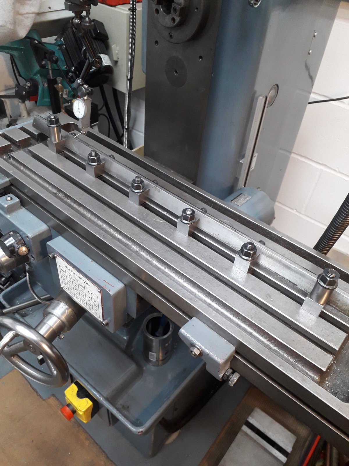

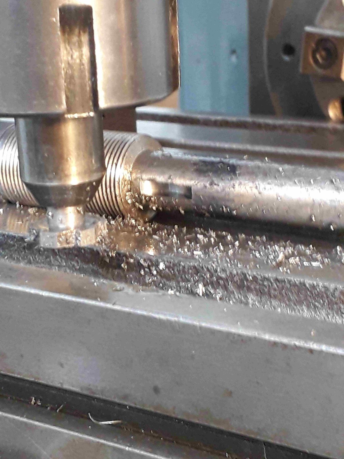

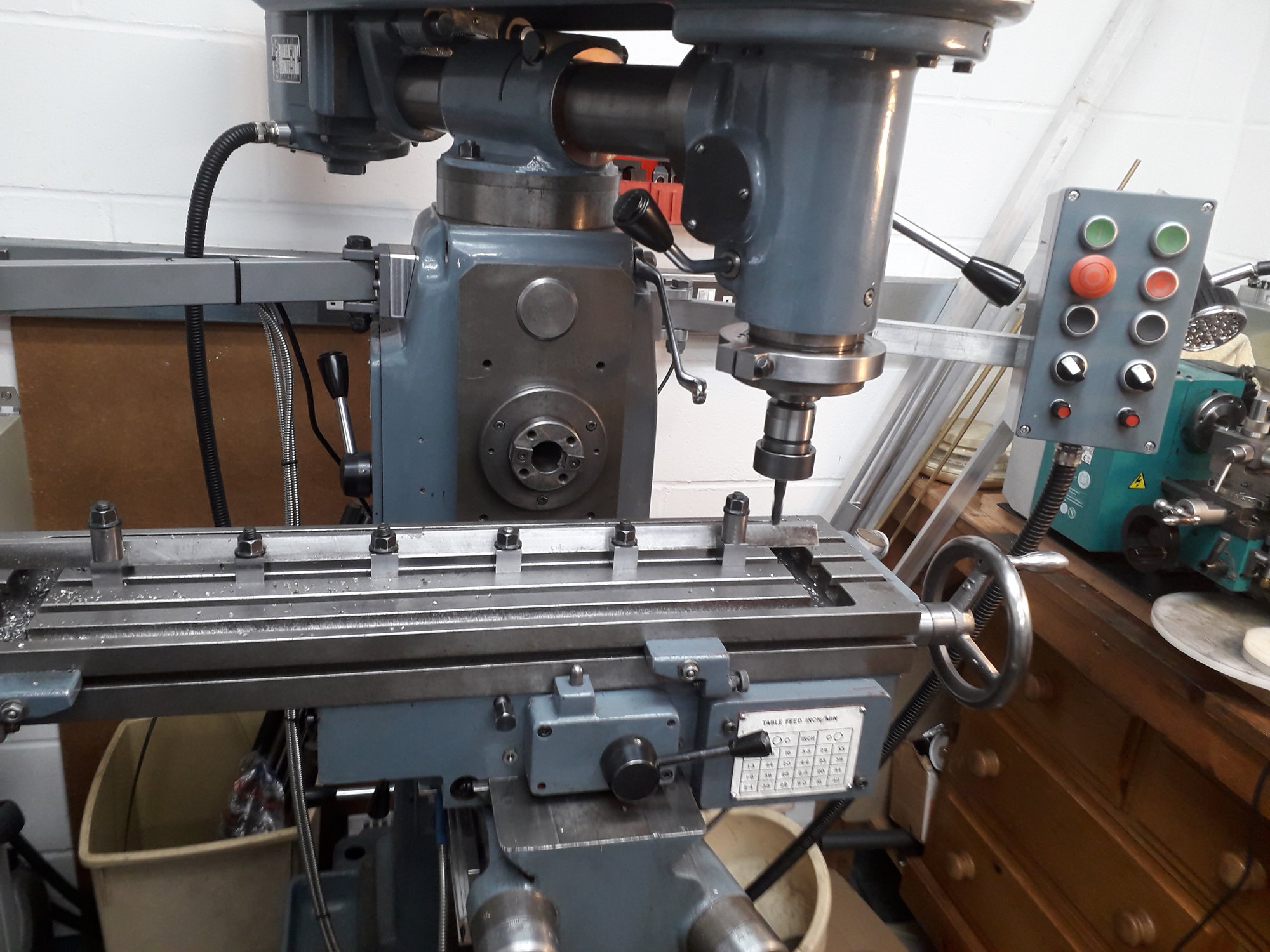

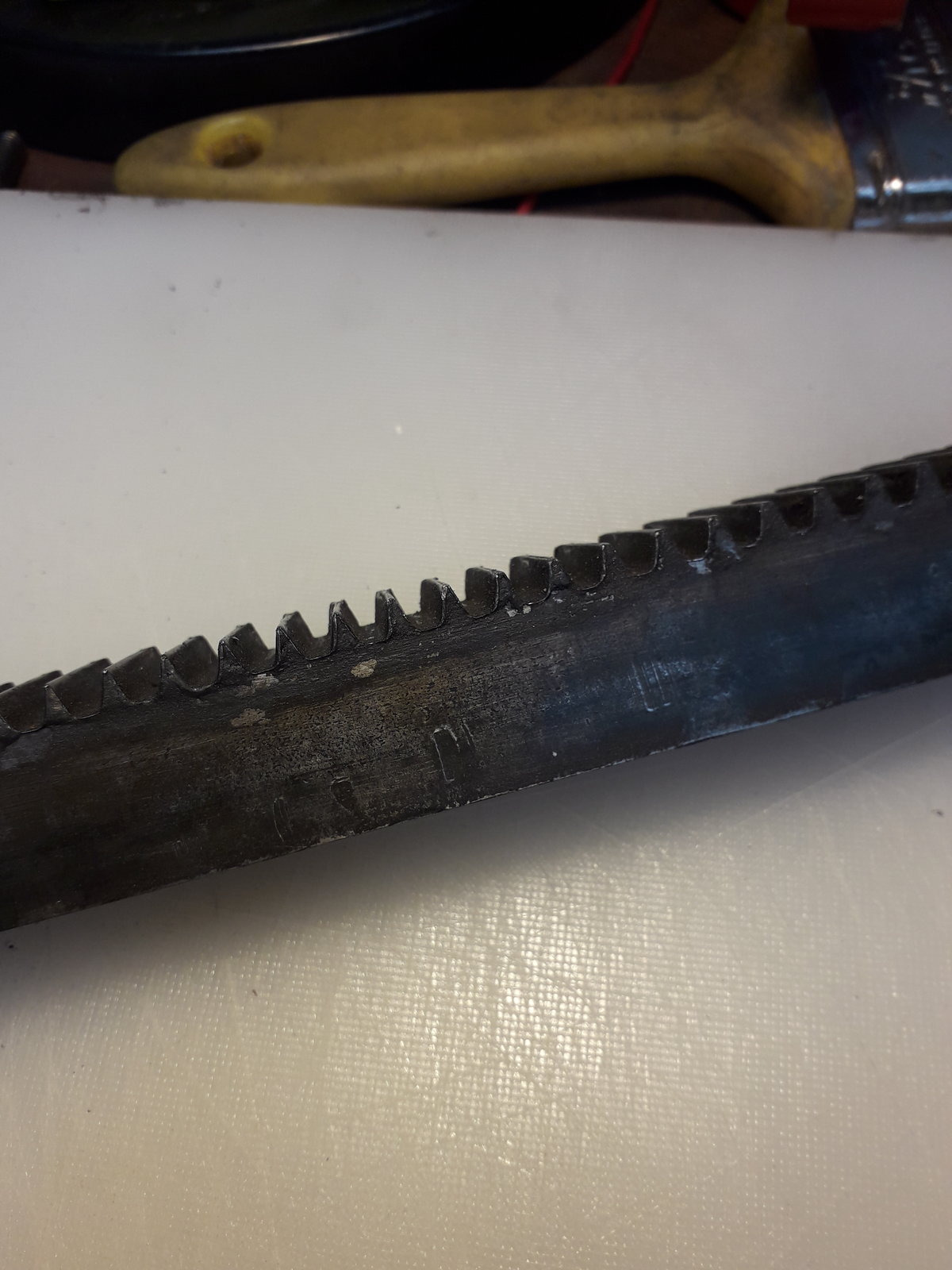

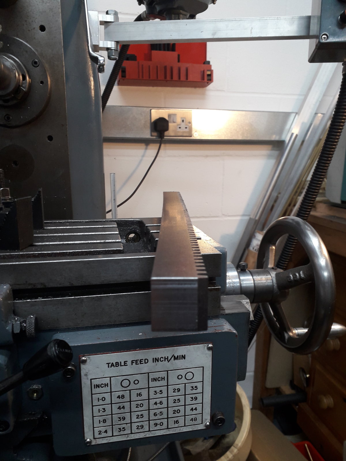

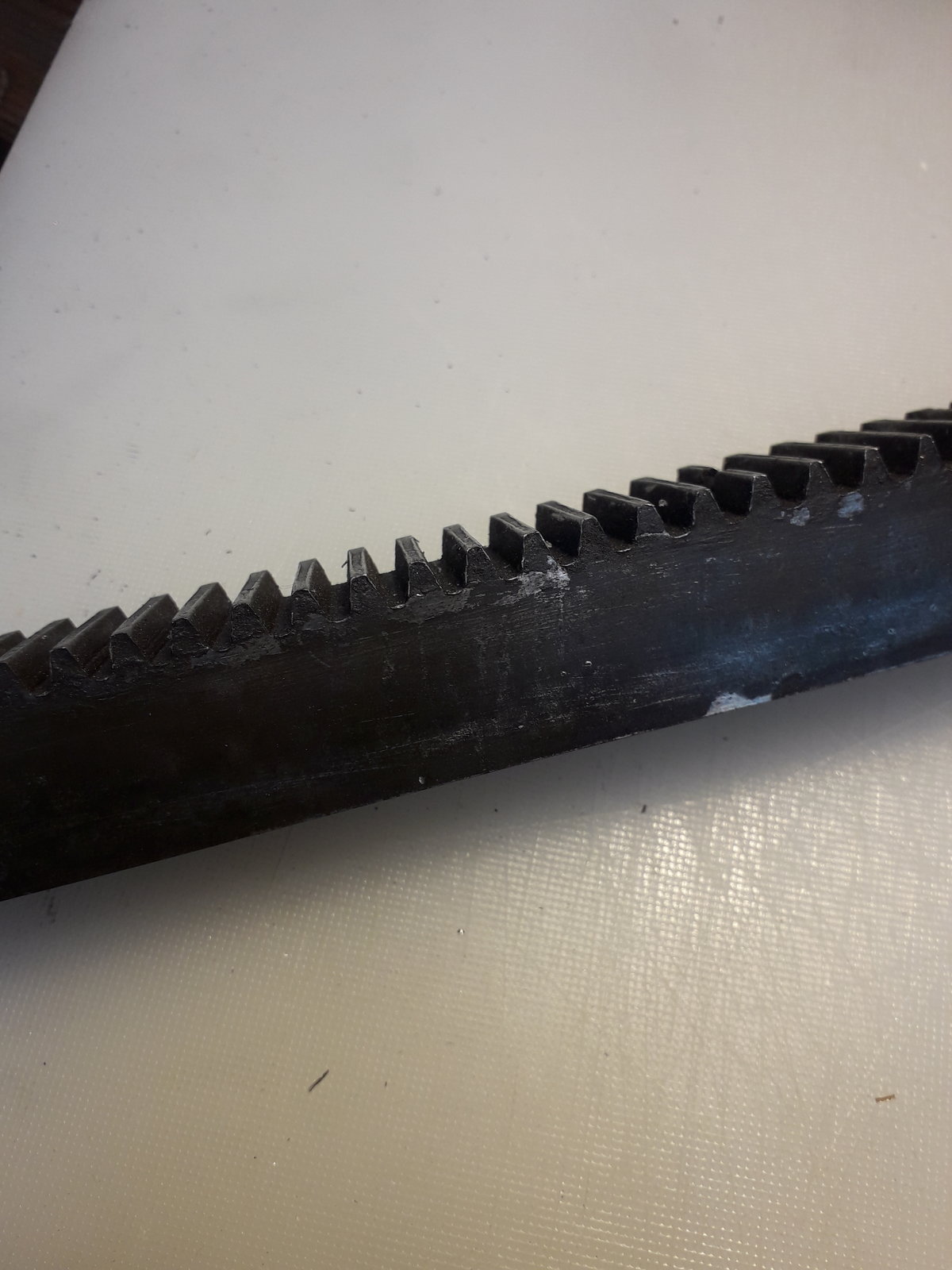

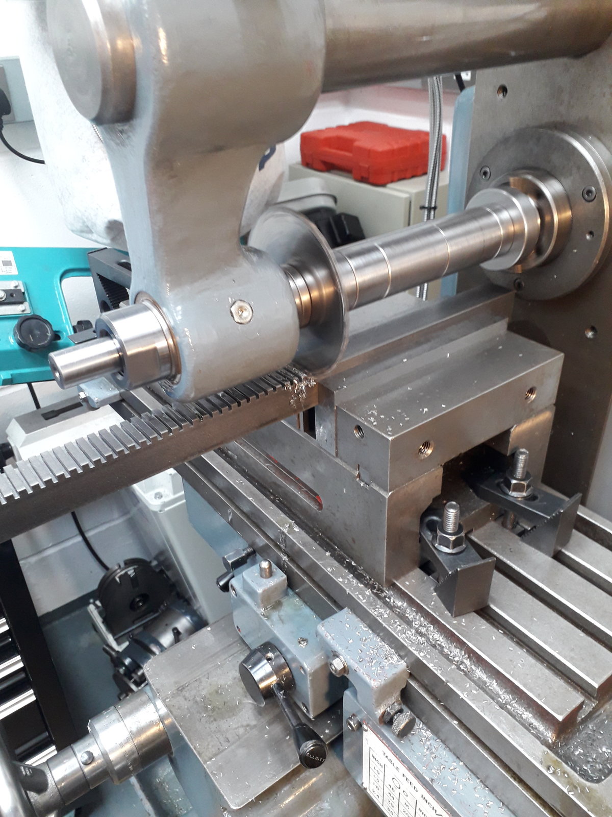

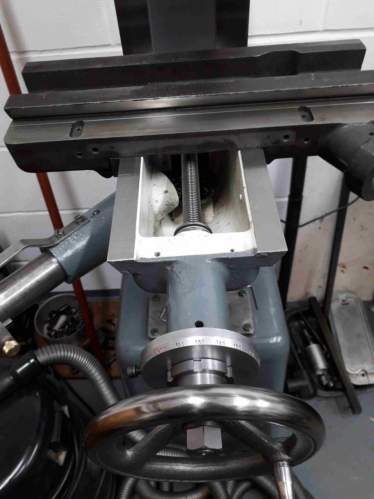

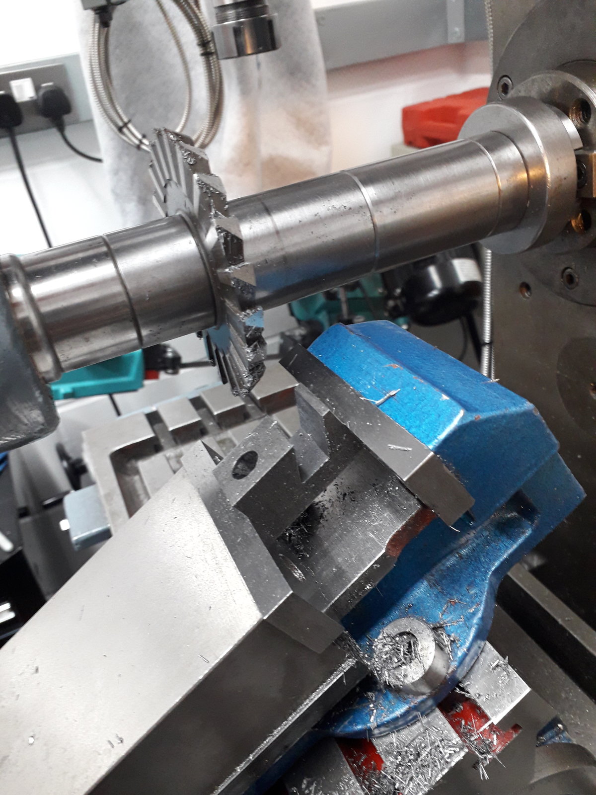

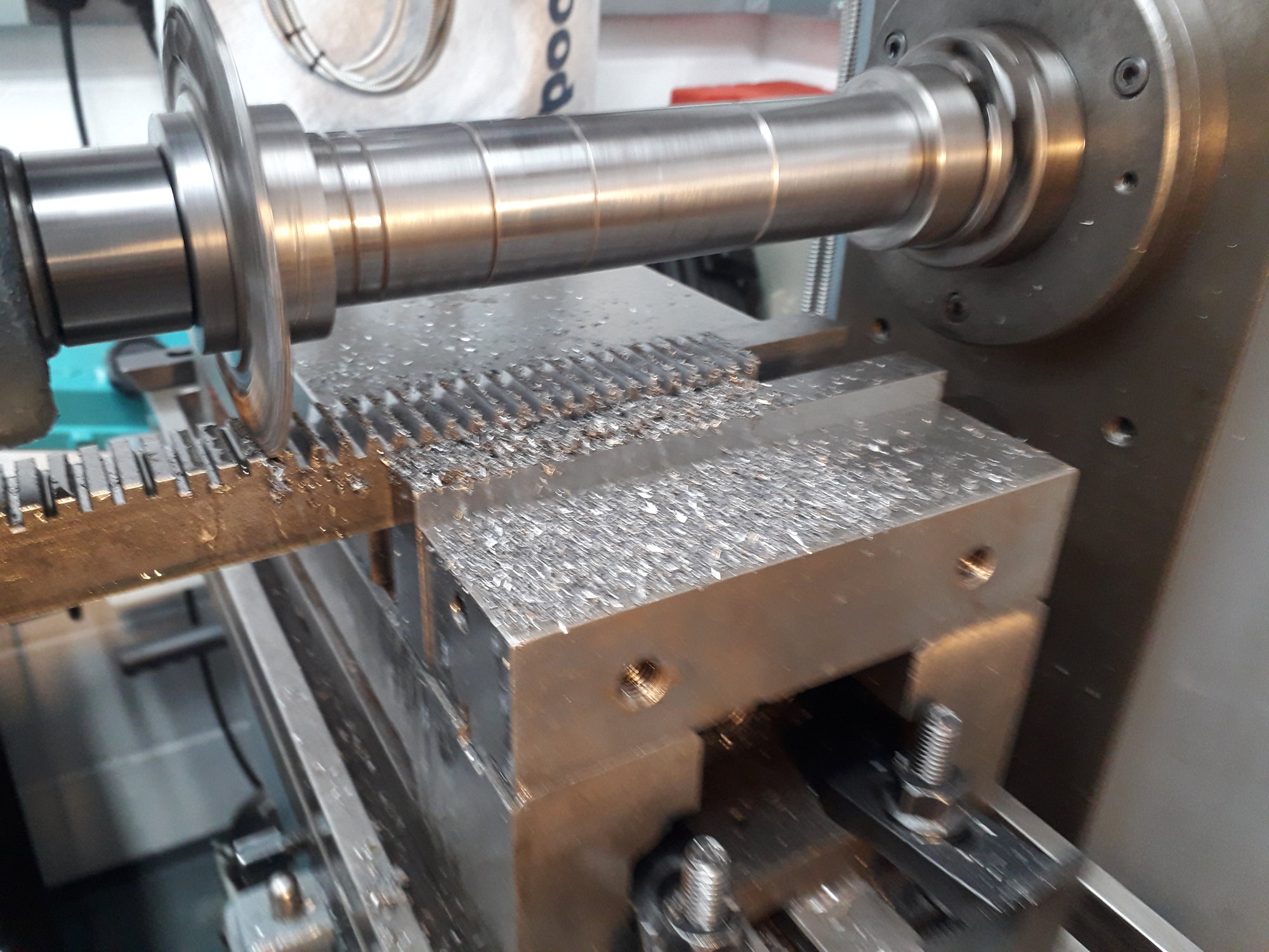

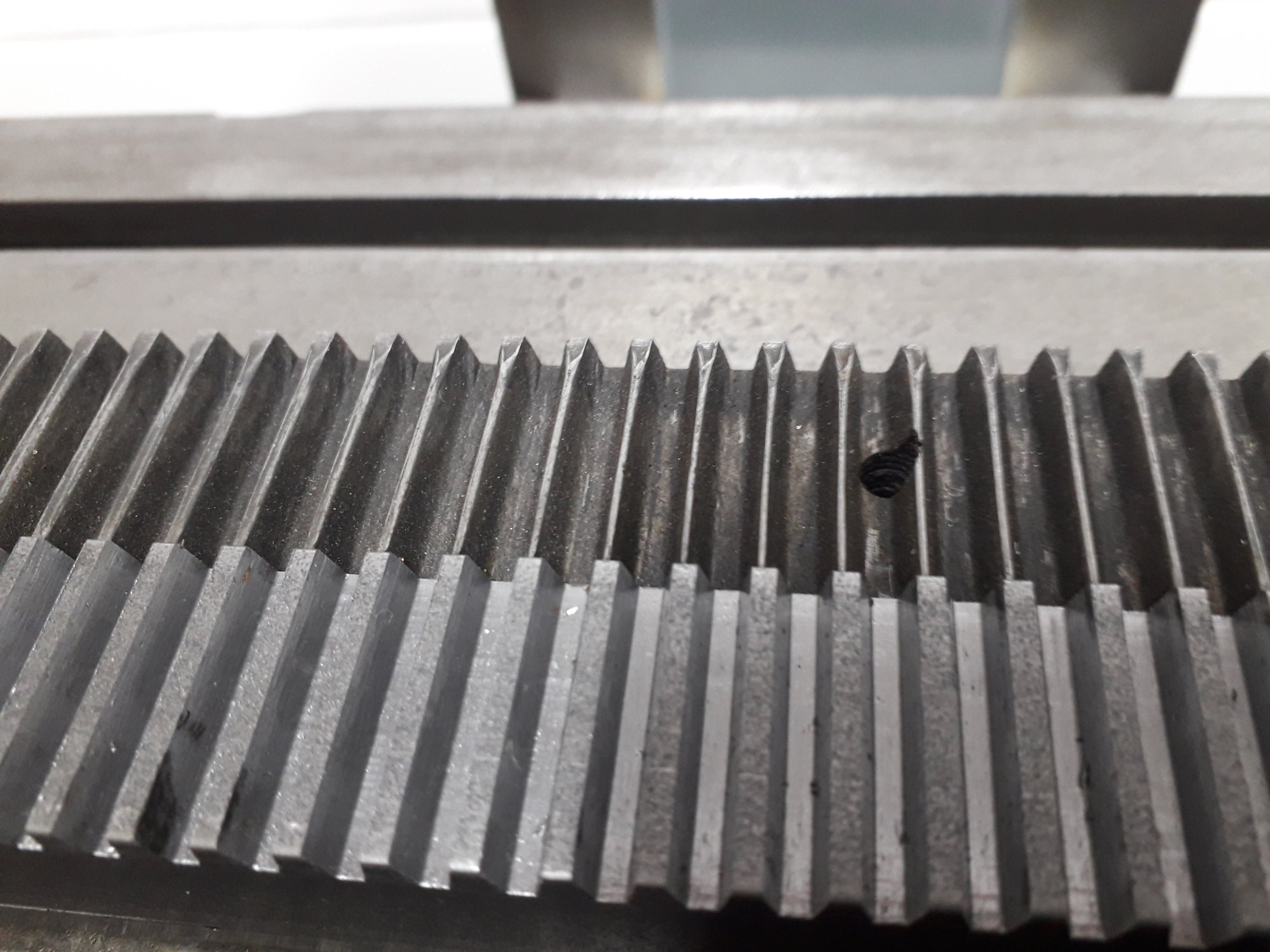

One other thing that puzzles me about the rack. It's an imperial machine..., so why a MOD gear?
Definately not 1/4" CP. I measured over about 14" of the rack. If its 1/4 CP the teeth should line up every 1/4" on the scale, but they gradually misalign, so I'm convinced its Mod 2.
