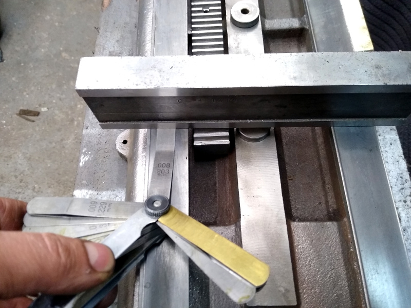

First impressions are that the ways seem to be in fairly good condition. The table ways have the most wear, which is expected. The cross-ways I haven't been able to inspect under the bellows but the rise and fall ways seem to be very good. They'll all be getting scraped regardless. Thankfully all of the ways apart from the table have been protected by the still-intact leather bellows which may be salvageable but I'll have to read up on how to revive the leather.
