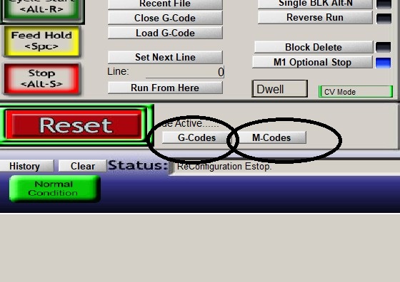

G20 in your code will tell Mach to run in antiquated measurements, sometimes also referred to Imperial or Inch
I changed the unit of measure in Mach3 to mm and everything was 25.4 times bigger
. Have not since then tried to be smart
