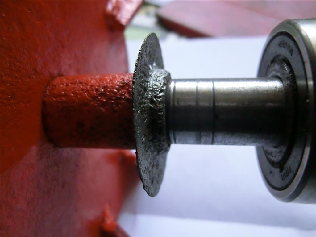

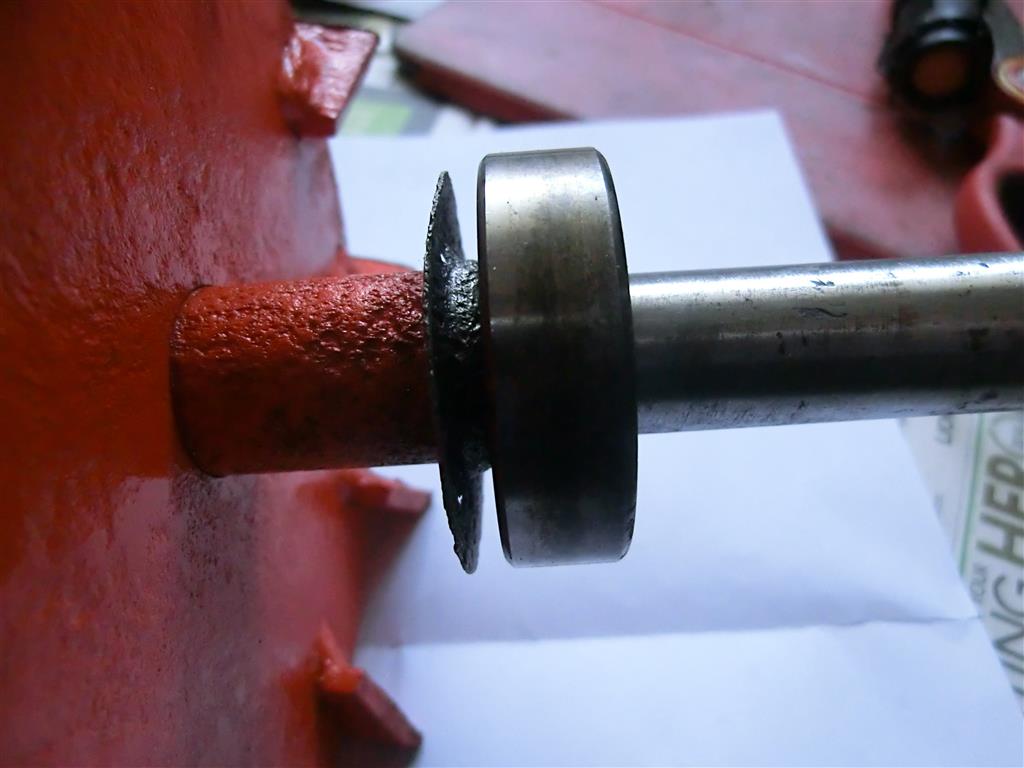

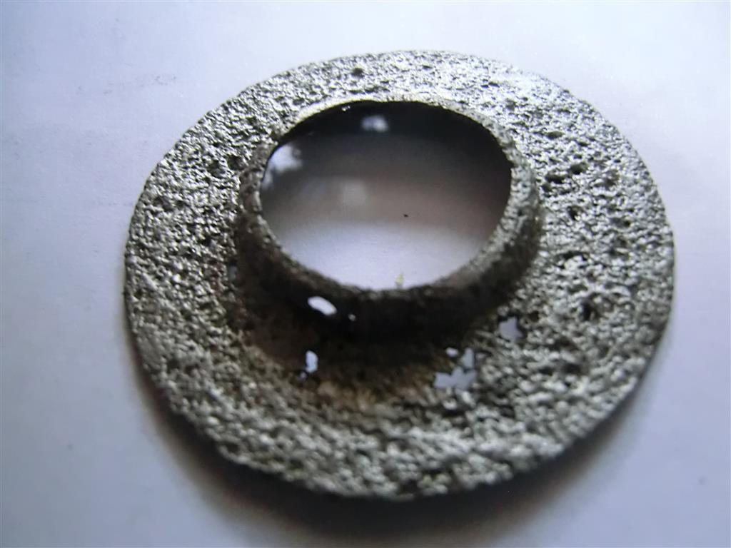

This moth eaten item is a tin "seal" for the cutting cylinder on a vintage lawnmower and is long since not available. My question is whether its practicable to reproduce a few in the home workshop - I do have a 20ton hydraulic press but no lathe to make "tooling" but know someone who has.

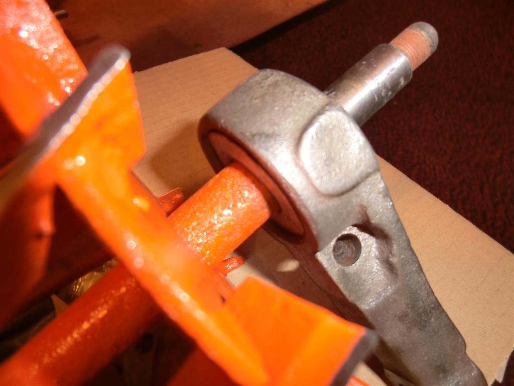

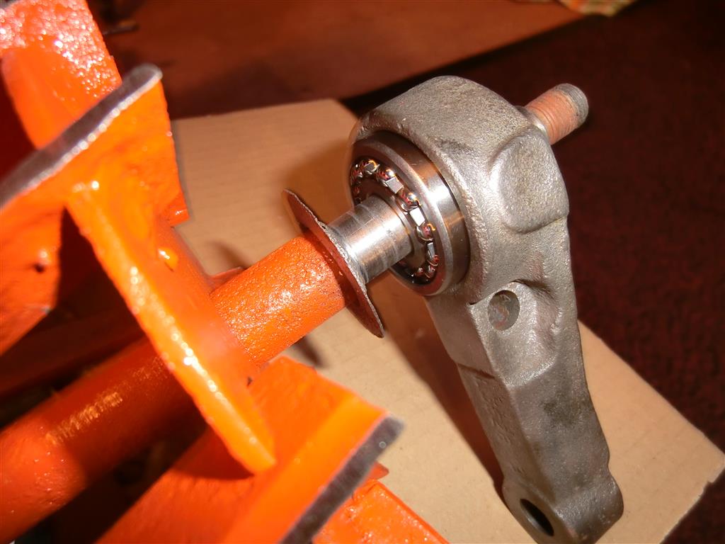

The simple answer would be to replace the unshielded self aligning races with rigid sealed ones which would be ok other than the fact that the adjustment of the cutting cylinder (moving blades) to the fixed bed knife is independent at each side so it's desirable that there is some flex to accommodate misalignment.
