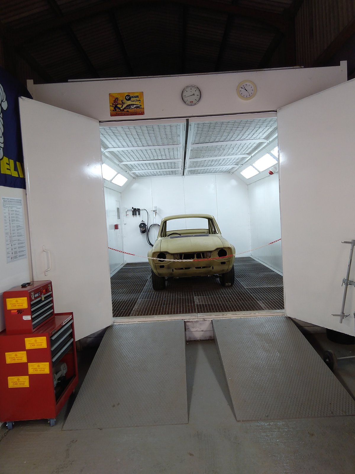

It's a lutro downdraft initial push then when up to speed pull. Everything was cleaned though not laboratory clean. I'm running -6 on the manometer and all the filters and seals have been renewed and tested. The smoke clearance is about 3 minutes. I'm not expecting to have zero dust but first jobs I got some significant nibs.
