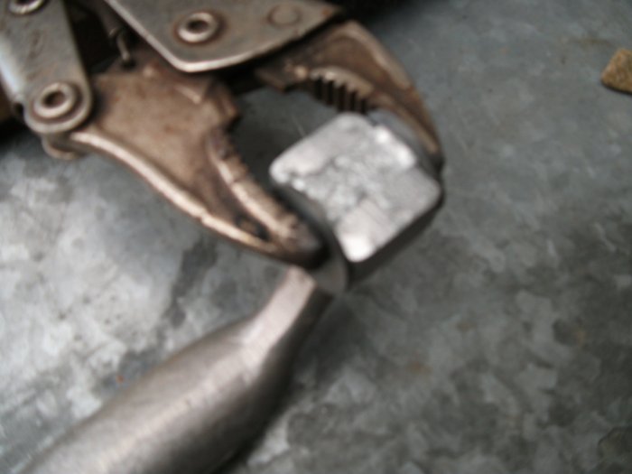

what is the melting point of tig rods?? melting point of aluminium is 660.37c the melting point of easyweld is 389c therefore if u are using a propane torch and heating the whole job up theres no chance of melting the article u are repairing or welding togetheri'm wondering if a propane torch would work with tig rods and oxy acetylene flux, might try that out.[/QUO

u can use o/a torch but it isnt necesary a standard propane torch is ok heres the one i usedi'm not talking about doing it out of necessity, i was just wondering if it'd work at all cause i've never tried melting aluminium with a blow torch, i have tig and oxy acetylene.
