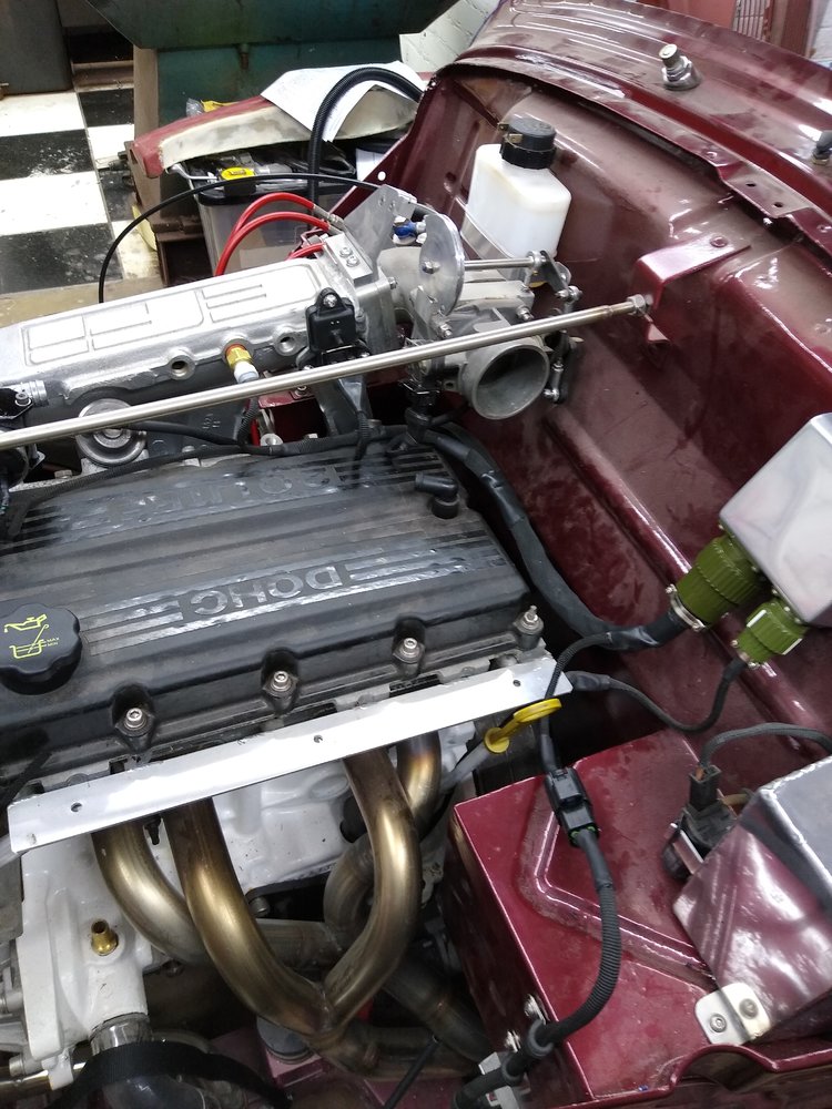

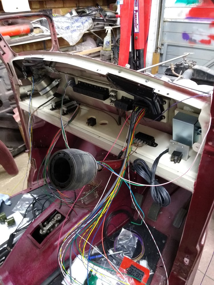

First off is a picture of the engine electrical connections. This was during wiring up. The left hand connector is the injection loom, the right hand is anything else.

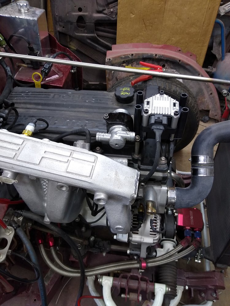

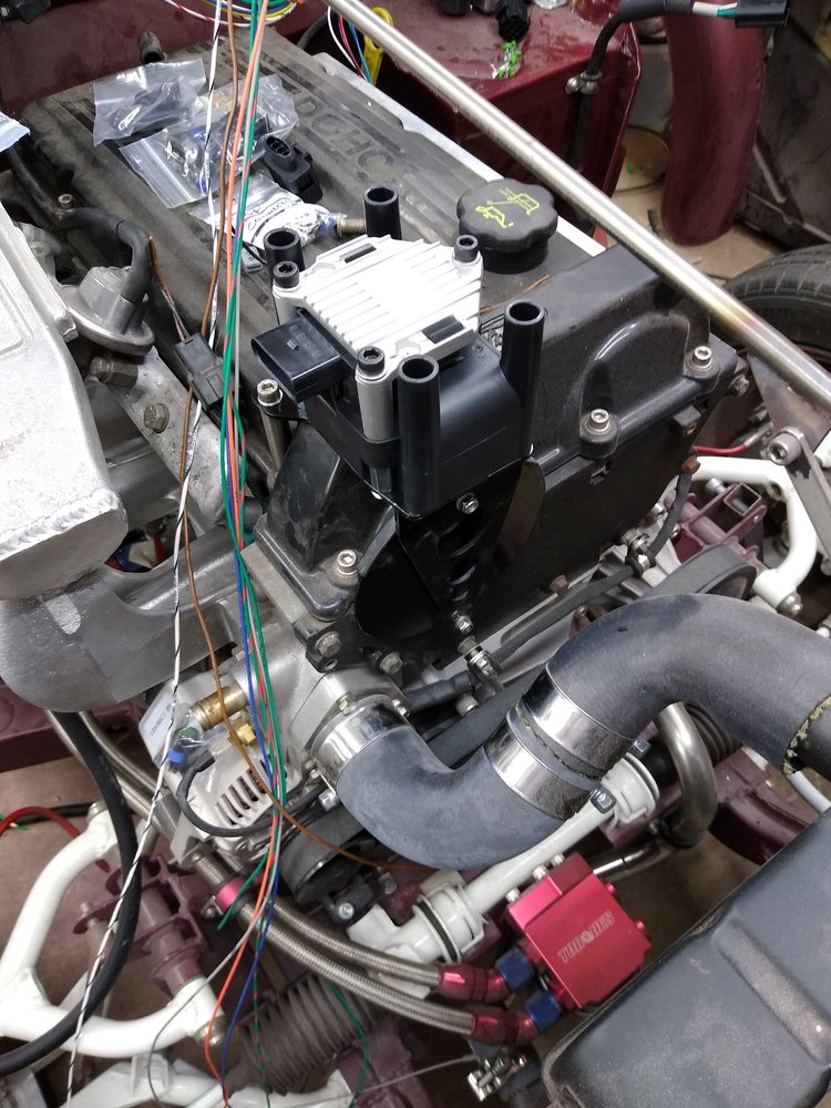

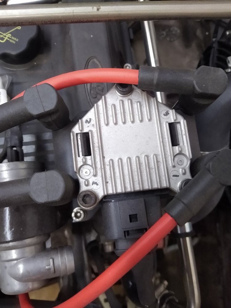

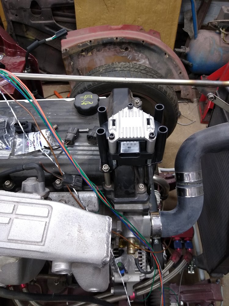

This is the front of the engine, again early in making the loom. This is where the coil was mounted above where the distributor was. This is a simple remove and blanking plate. The alternator is a small Denso unit as the Ford one was huuuuge. Note the modified intake, more later.
Another view of the coil and mount.

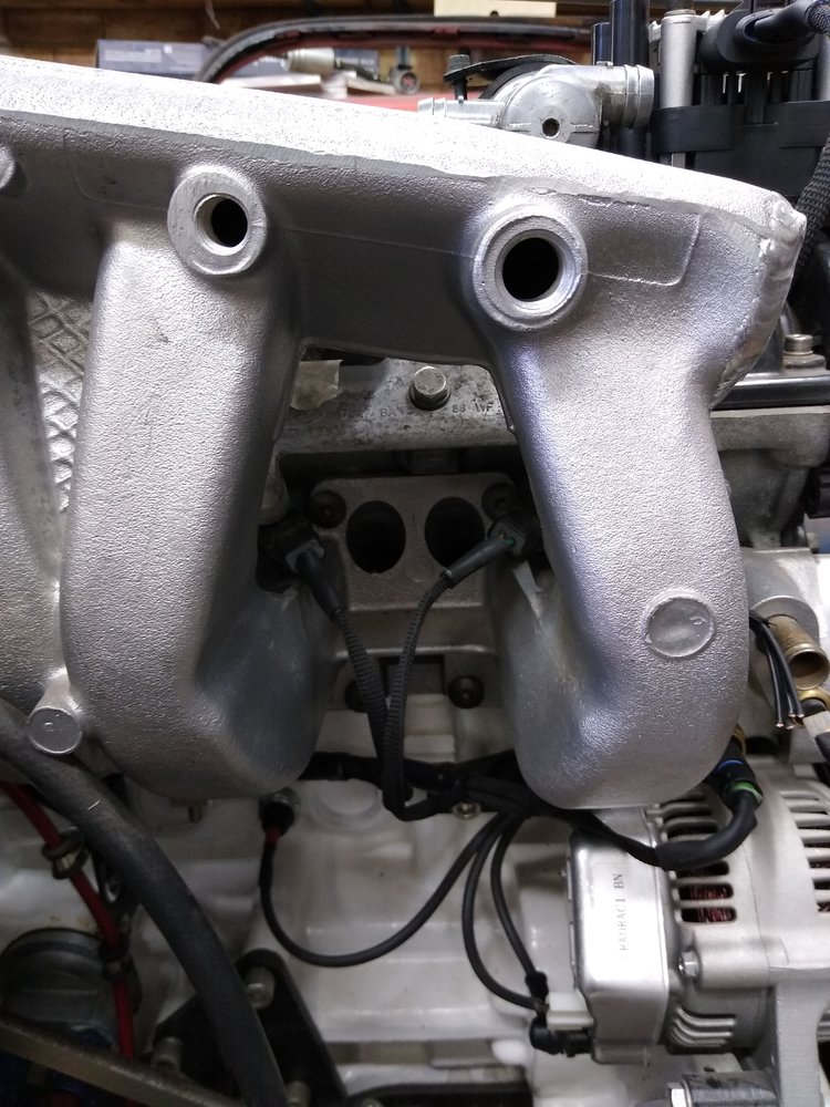

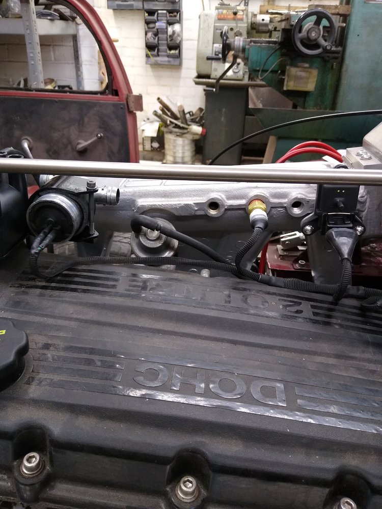

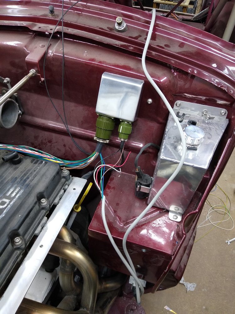

The idle air valve was mounted here. You can also see the completed loom. It's fairly minimal but has all I need to pass IVA.
