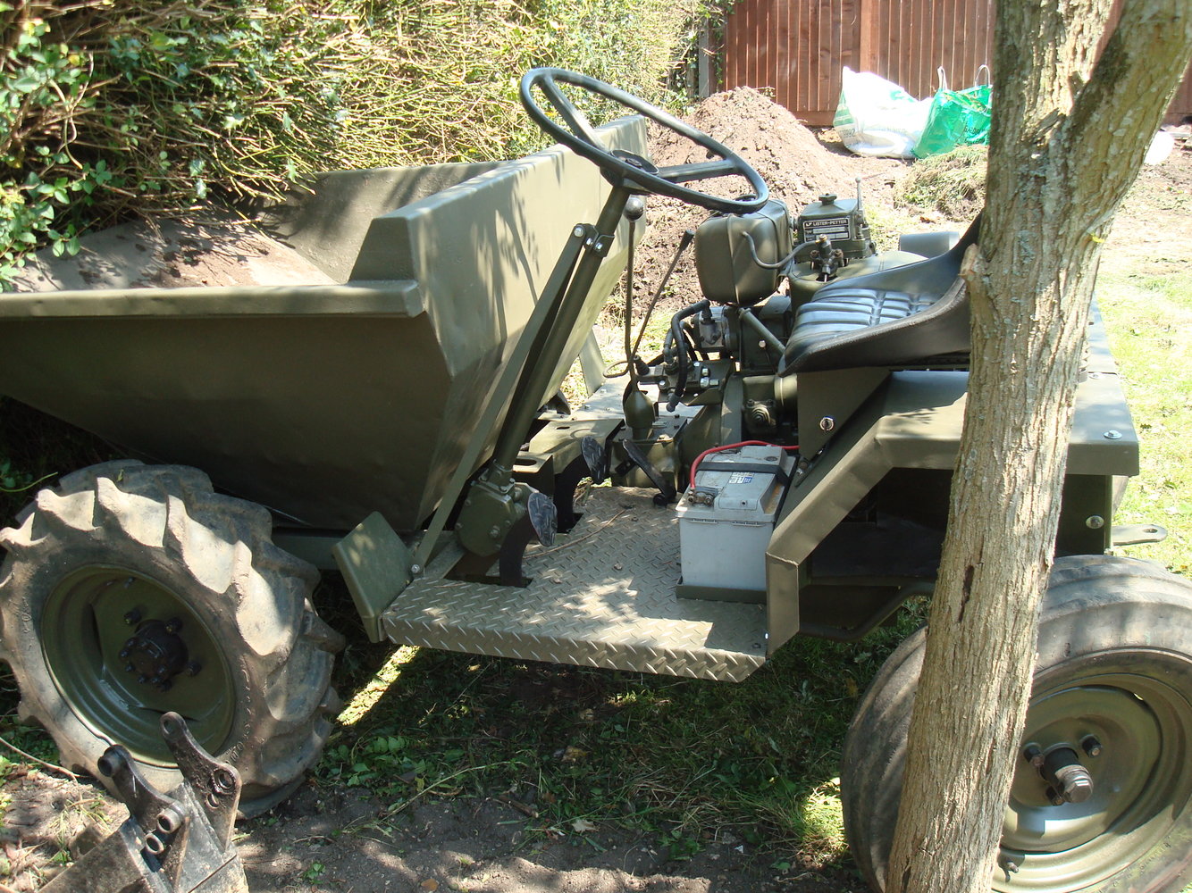

Ok so been on here a while and looked at some of the other mad projects on here so decided to actually document one of mine (there are many)
So ive had this dumper for about 12years now and its never let me down ive used it on loads of projects for friends and family and its paid for its self many times over.
What made me buy it intially was it was simple and had a PH1 petter that i am familiar with and had hydraulic tip that really is useful , its also quite compact so I can get it on a 14ft ifor williams with my digger too.
The first thing i did was convert it to electric start using a dynostart from an old american lawn tractor that i had lying around which to date has made it much less effort to use.
Its a Thwaites orline 2500 so basically 1 1/4 ton but im pretty sure ive put more than that in it , it has a proper dumper front axle with internal hydraulic brakes rated at way more than you could put in it
heres the beast

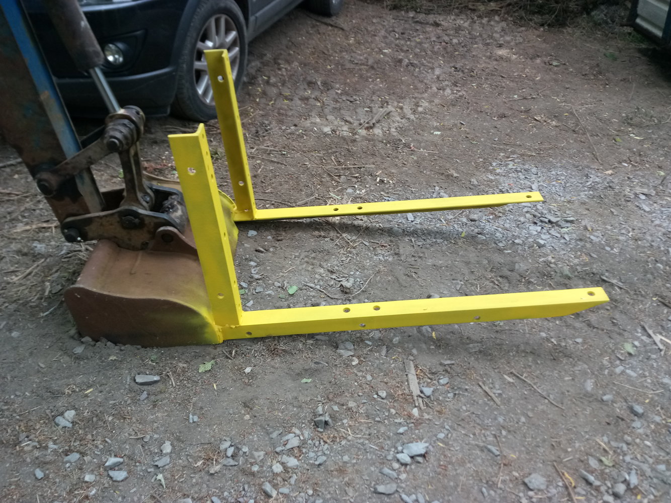

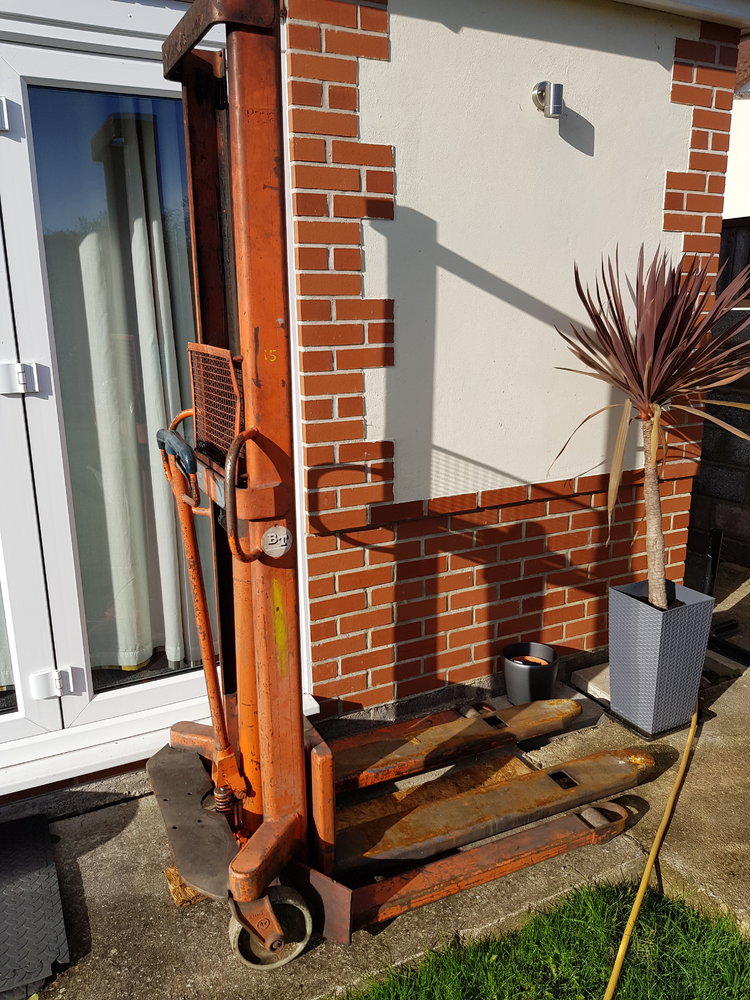

So i had an idea of taking the skip of and replacing it with a Jib of some sort that could lift the bag high enough and would bring it closer to front axle so much better weight distribution, and then my neighbour gave me this so I thought ah a forklift would be dead handy too!
The idea is to use whatever scrap I have lying around so it will only cost discs and gas

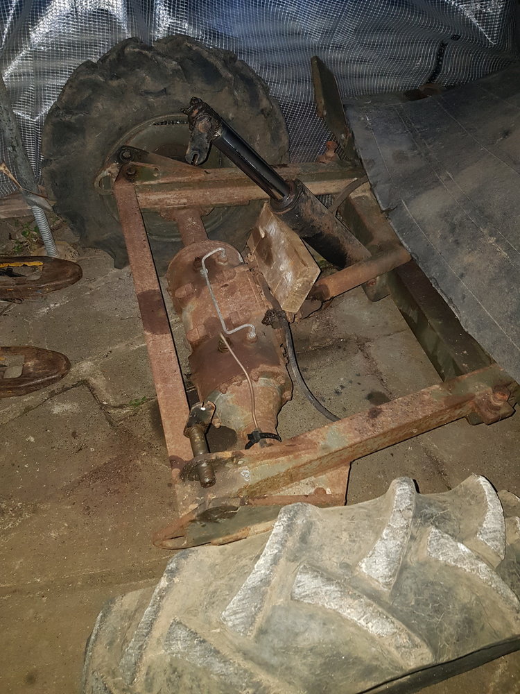

with the skip removed (need to weld on lifting eyes as sketchy) this is the area its all going to happen, i figure the ram should be more than powerful enough as its about 5" round and has never struggled tipping anything.

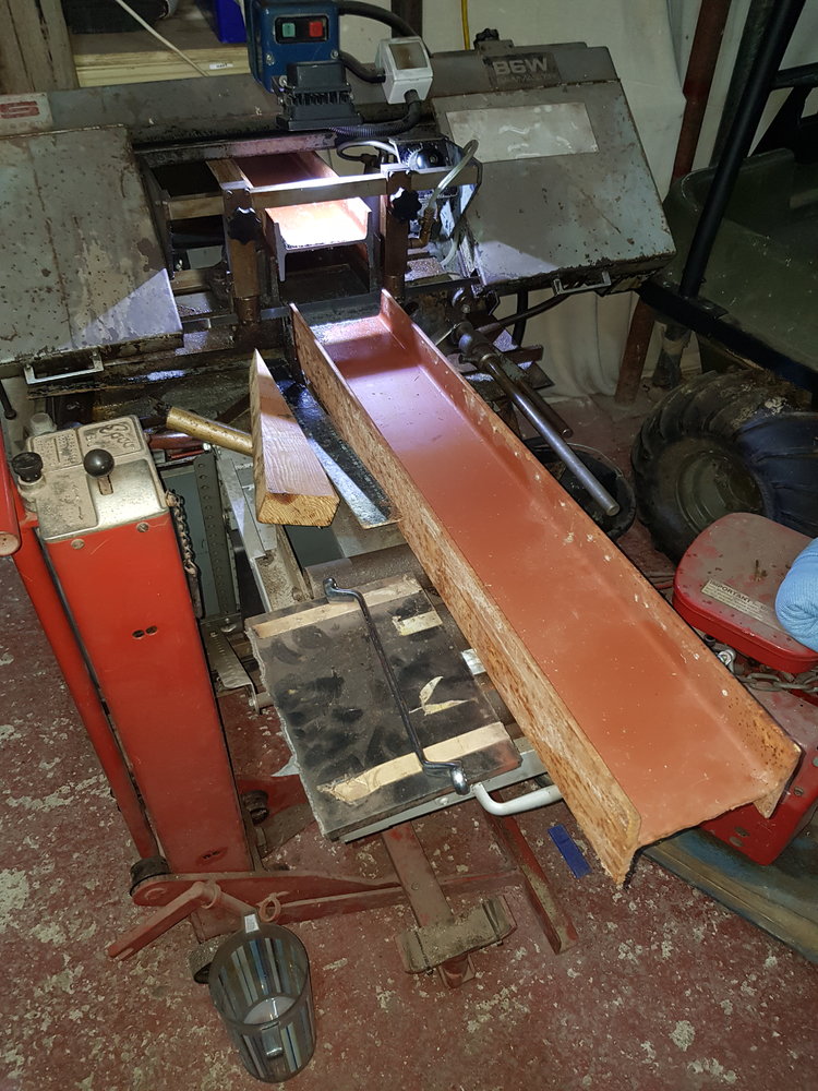

Next a spare RSJ thats never had a use yet 150mm by 90mm should be plenty
good test on how square bandsaw was cutting and it was pretty much dead on

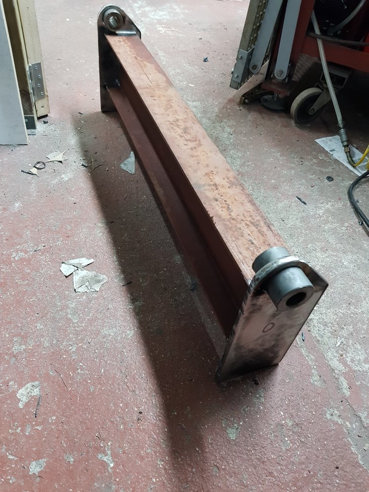

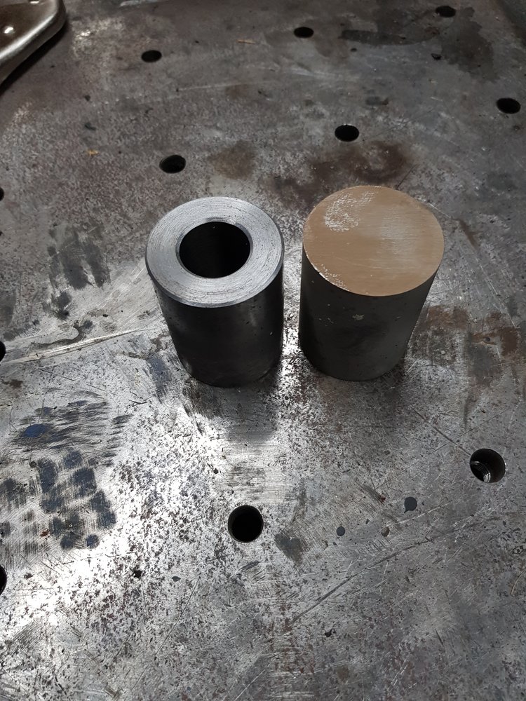

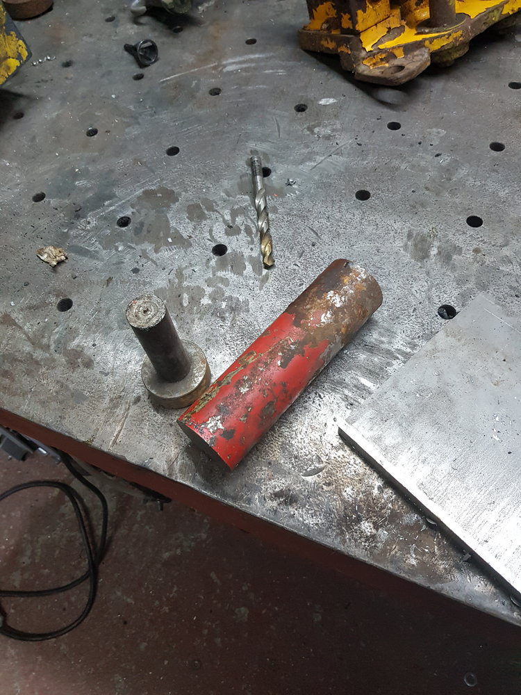

Then make some bushes

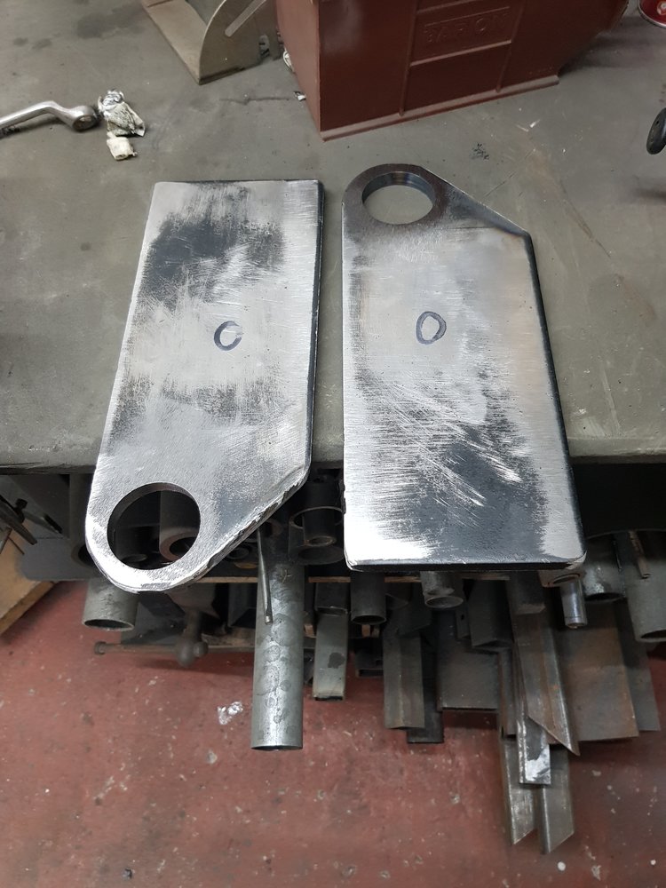

Then make some side plates then weld it all together in the vain hope it all lines up
I did tack it all in place and actually lined up after !
