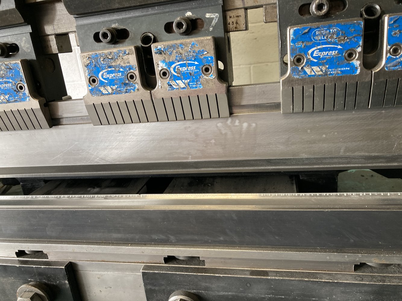

so I run a 2.5mtr promecam Pressbrake which has an adjustable intermediary like so in effect you undo the two Allen bolts and tap the wedge to adjust.
When I first got the Pressbrake I had it serviced and the guy stripped all the tooling and placed a dti on the base and then could reference and adjust as needed.
I’d really like to be able to do the same (I’ve done thousands of parts in the year!)
but I’m confused at all the different styles, types and bases
Range only needs to be 10mm and accuracy 0.01mm can anyone link me to what I’d need the holder and the gauge itself?
Thanks all
