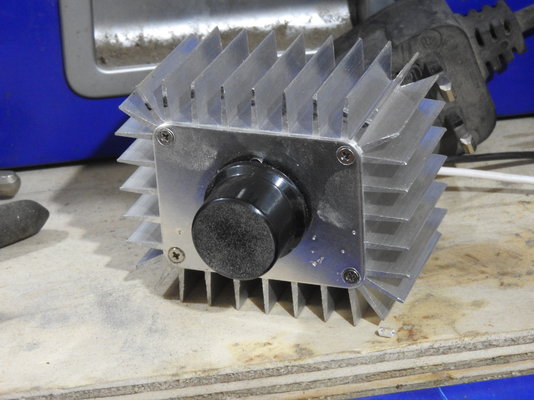

@rtbcomp That looks too much like hard work- you planning a motor?

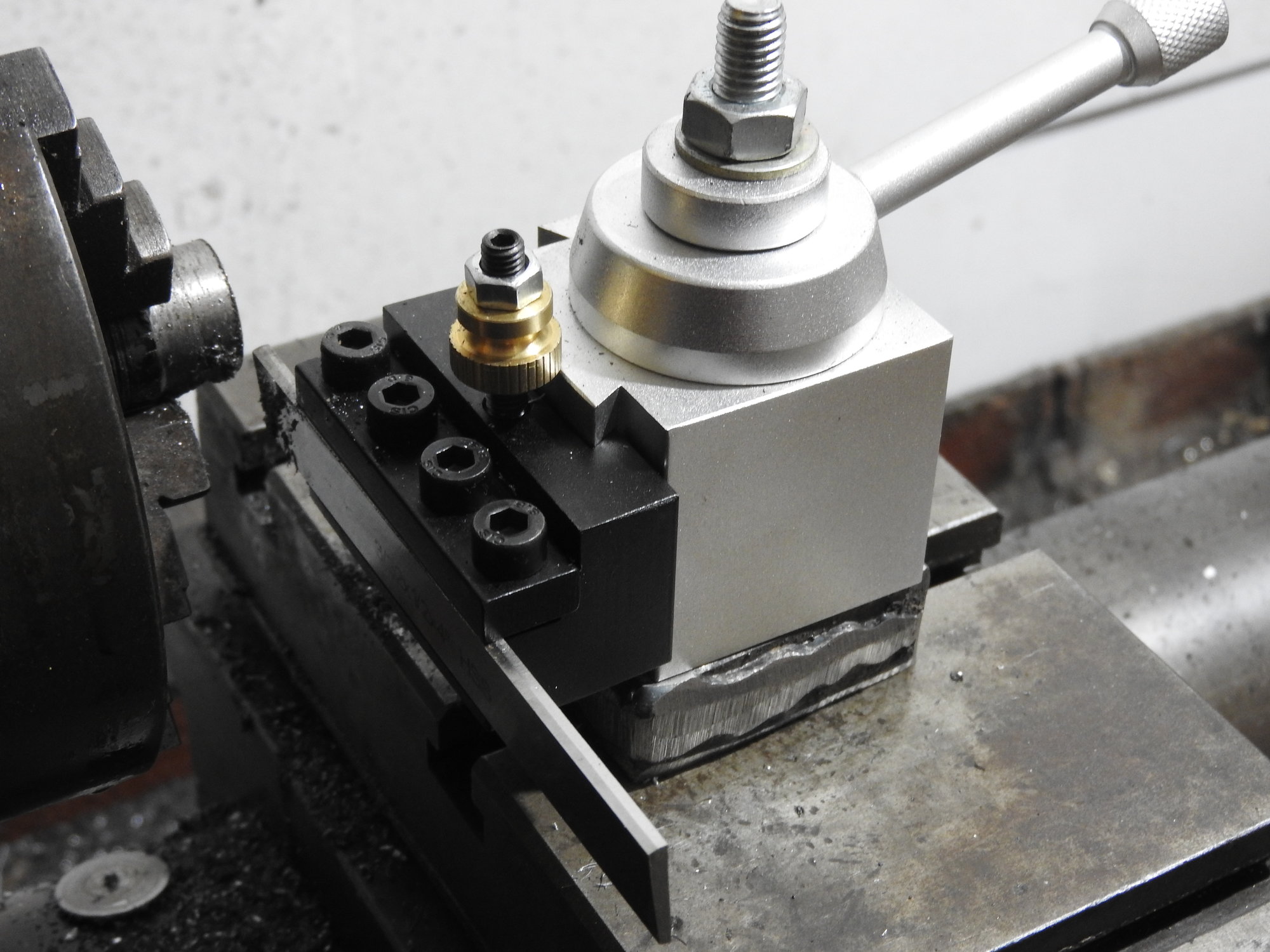

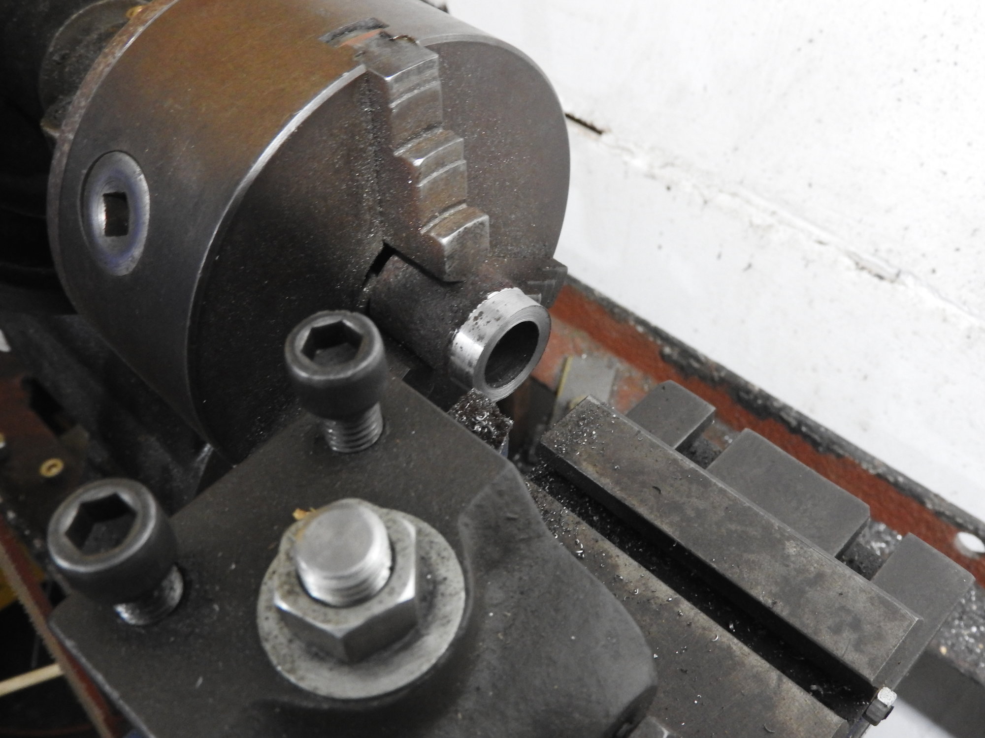

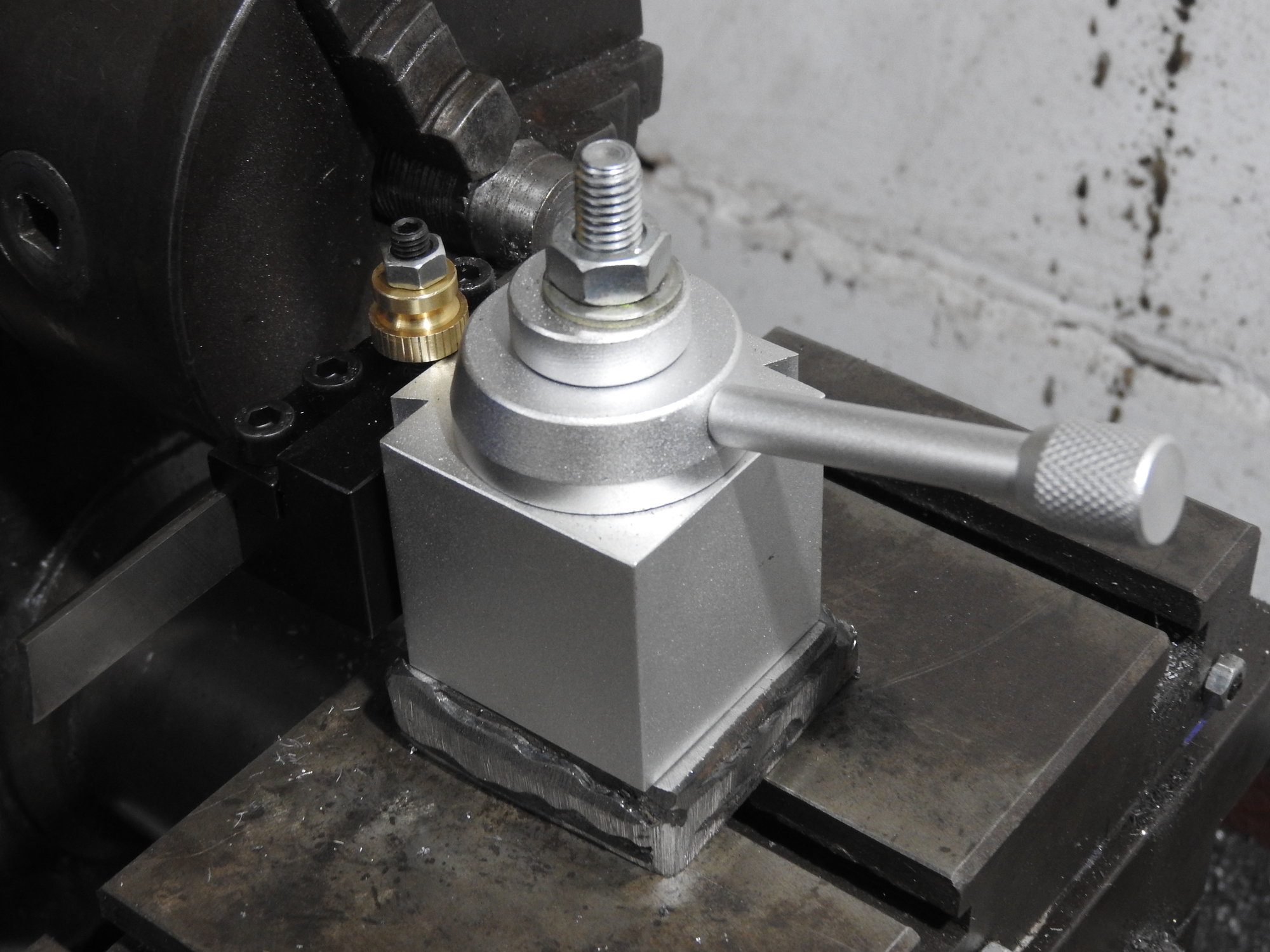

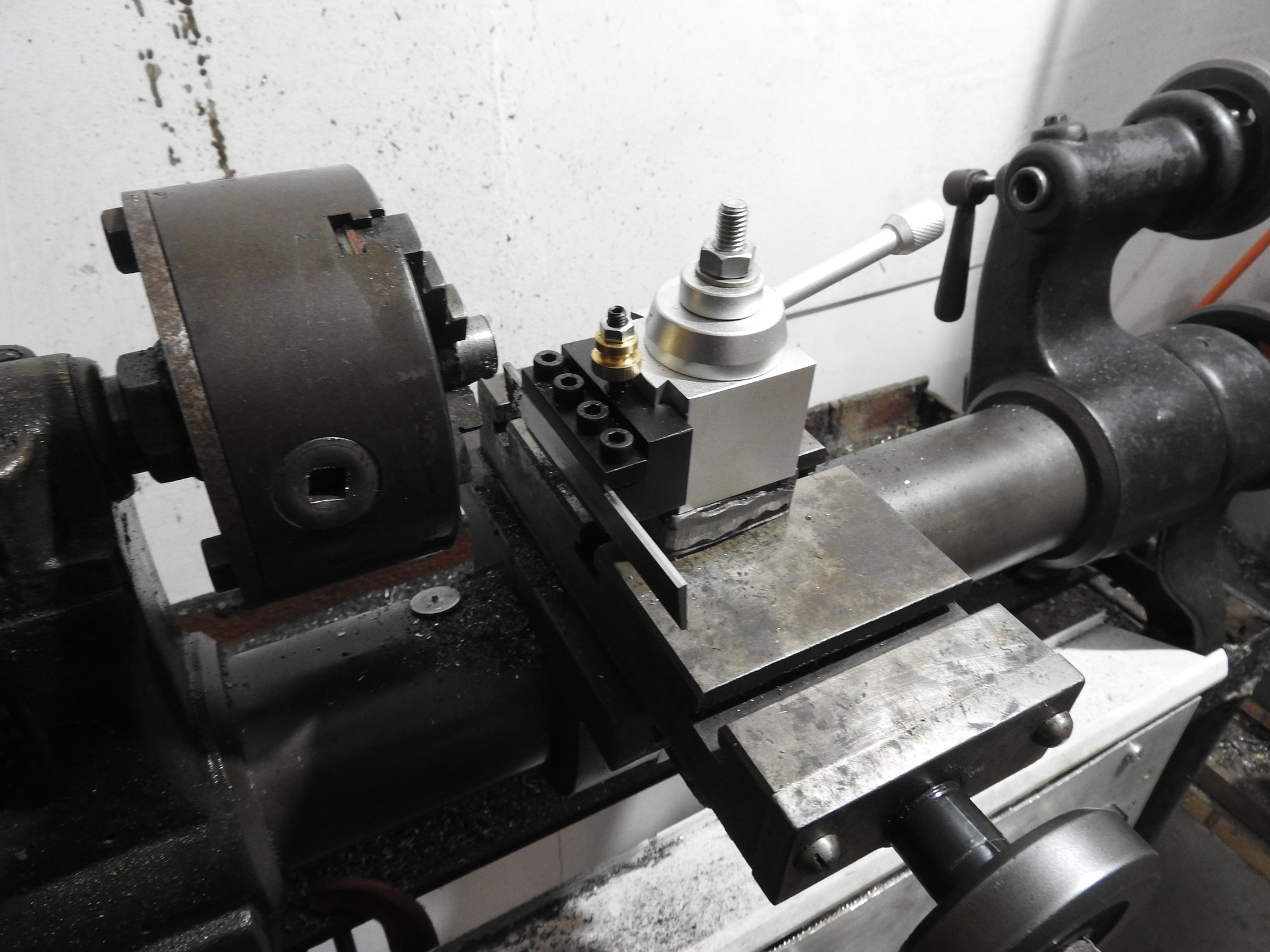

Treated the lathe to a Chinese quick change toolpost (QCTP). I had to make a spacer 11/16ths of an inch thick to stand the QCTP on so the tool lines up with the centre of the workpiece with the height adjustment mid-range. It's made a big difference to getting the tool height correct, no more faffing with spacers.
View attachment 150243 View attachment 150244 View attachment 150245
I also had to find a longer fixing bolt.
