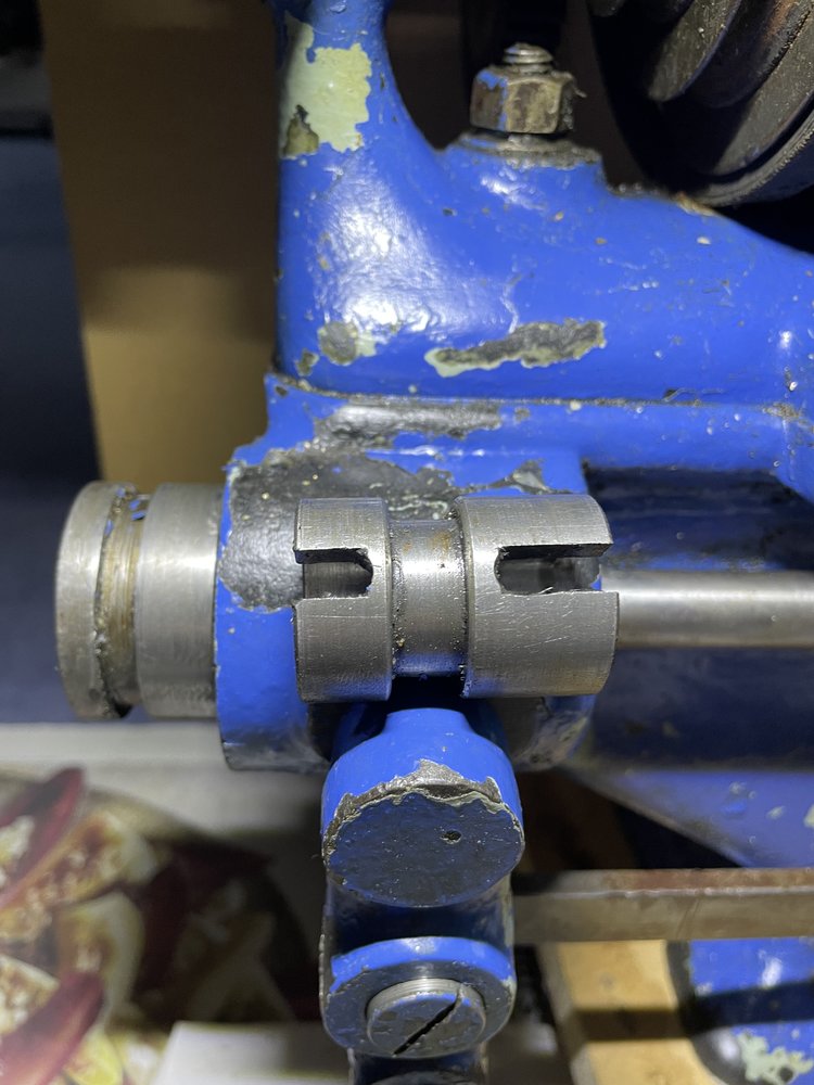

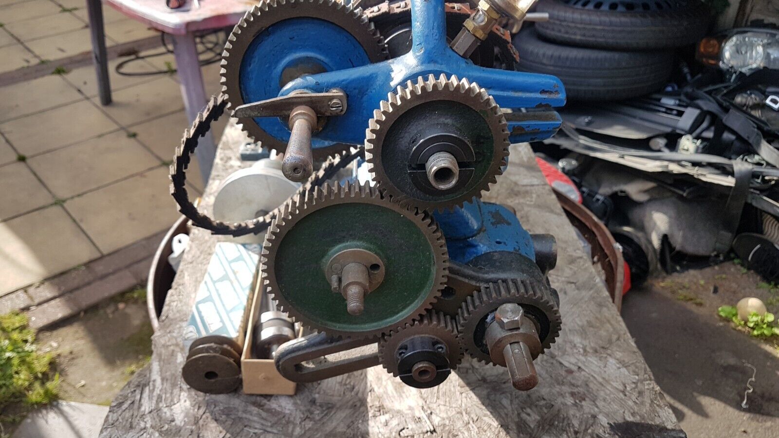

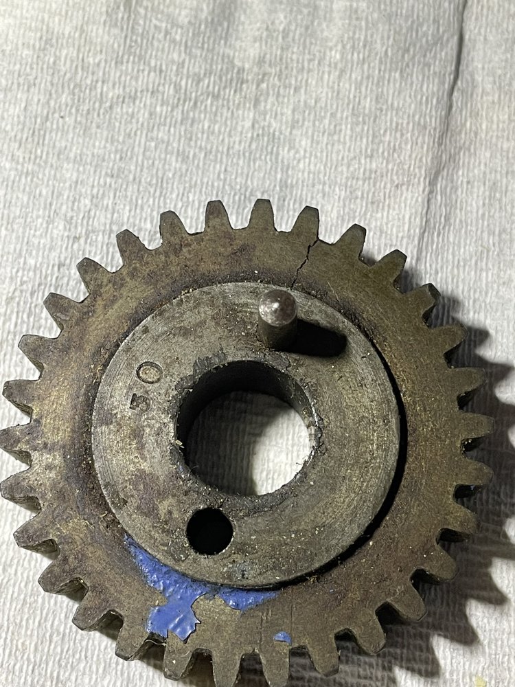

thanks for confirming, so from the picture would some sort of grub screw/ rod insert go in to the .250 through hole that would fit in the key way of the coupler to drive it. this was confusing me because i couldn't see a wedge in the drawing that would connect to the coupler. Also at the cog end what kind of attachment was used to connect this piece to the cogs as the cogs all have a pin insert in them as shown below.
