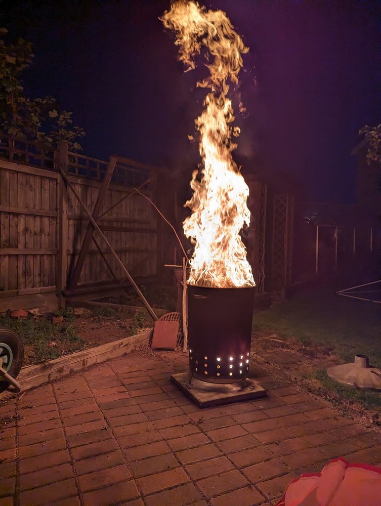

45 gallon drum:
Fill with water (safety)
Plasma cut top off
Tip out water
Plasma cut a few holes in the bottom and sides
Place on three bricks
Light whatever you will with a Rottenburger propane torch through side holes
Works a charm.
Remember to empty ash out regularly ot drum will rot as it gets wet.
Yep, been there, done that.
I was after making a lower one that I could place over a stump. As smokeless as possible.
