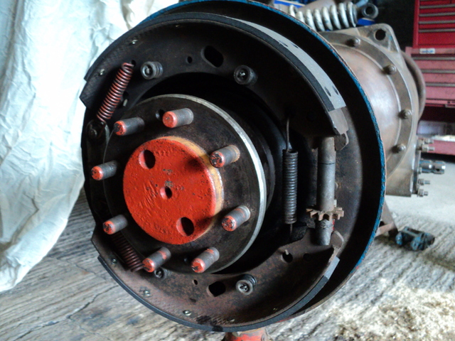

Done loads of these in the past but on MF tractors which have the same set up.
Large flat bladed screwdriver through the end loop of the spring and under the pin then lever it on, there is a technique to it and it will probably not work every time but will eventually. (watch your fingers they are strong springs).
Not my picture, but the same set up. Fordson Dexta tractor.
