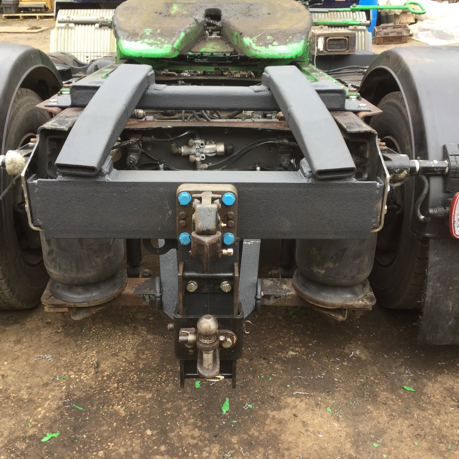

ive seen a fewThere is nothing wrong with drop plates whether fixed or adjustable as long as they are supported top/bottom and the ball hitch stays within the scope of these supports/stays. Beggars belief anyone would hang a hitch lower than the stays

When we go out and recover cars and caravans on a "tilt and slide 7.5ton recovery truck"...
An adjustable drop plate is a "god send" - without it - we would be dragging expensive caravans about at silly angles.
Getting trailer "nose weight" right is the key...
