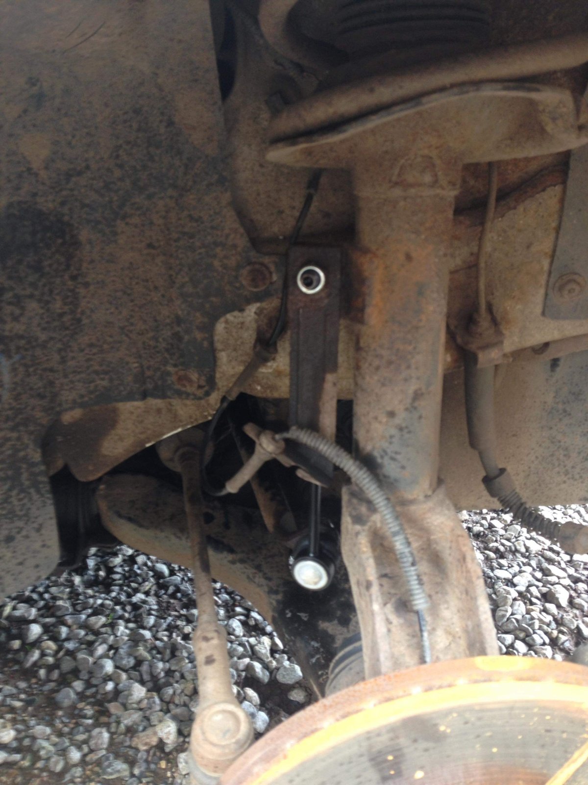

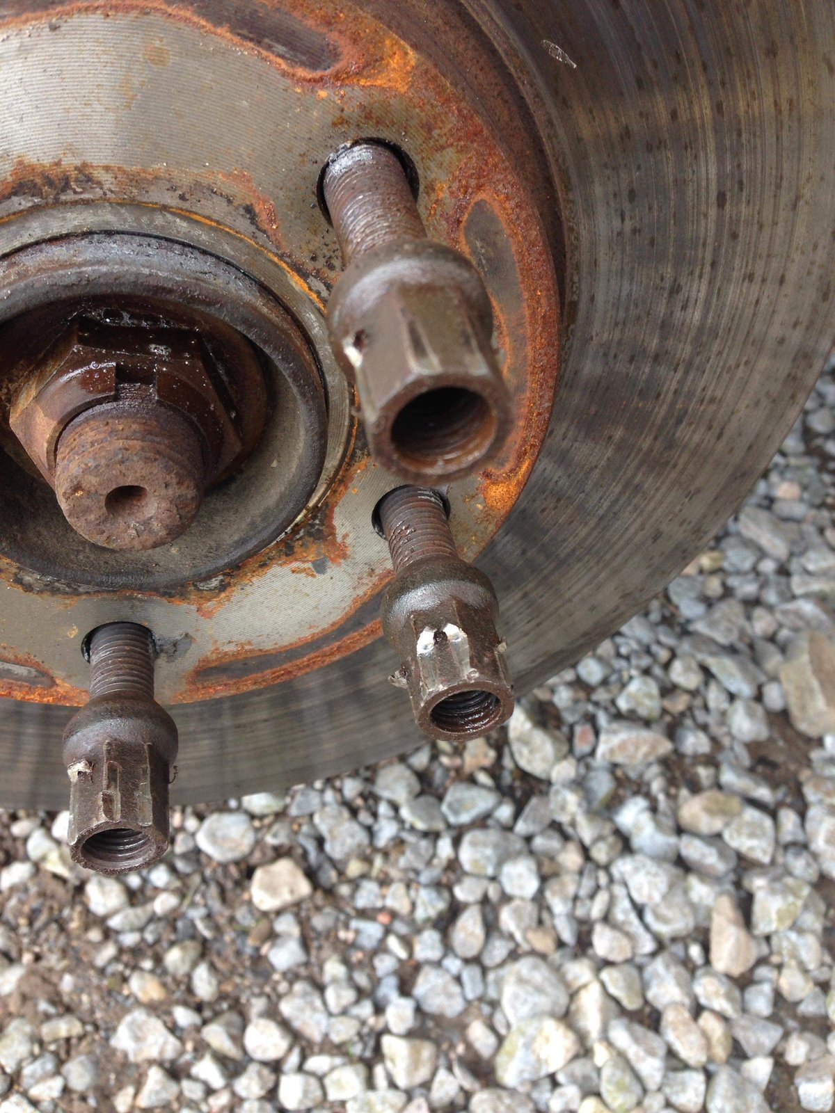

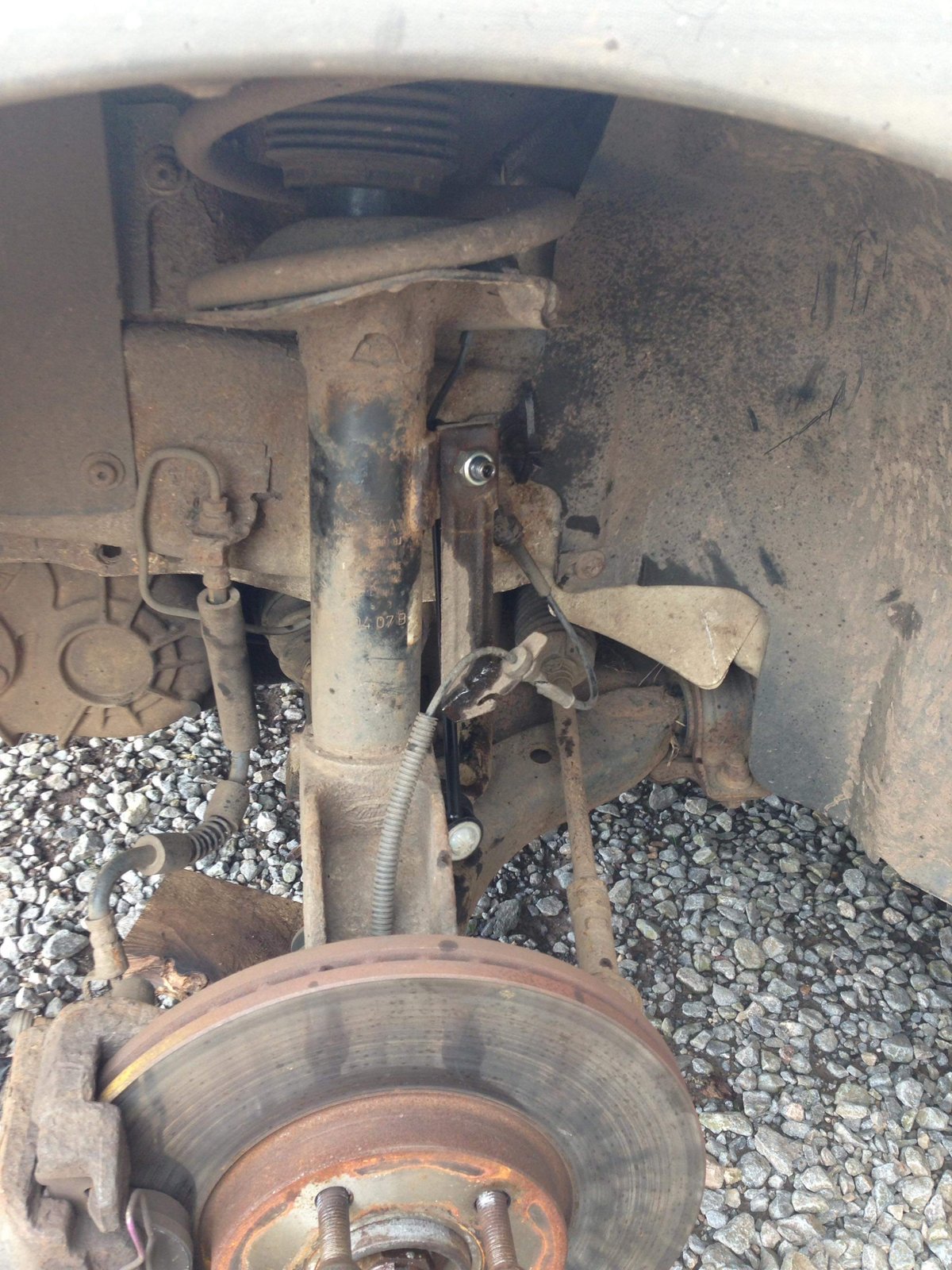

Son asked me to change the drop links, I’m on holiday. Agreed to do them
Went out this morning to get them done. Wheel nuts are seven sided Mac guard ones, of course they are worn as is the socket. Got one off, it gets stuck in the socket. Eventually get it out. The other four nuts just spin in the socket. Ok I’ll drive a 15mm socket on and get new normal nuts. Every nut had to be driven out of the socket, 10 min job turned into an hour job to get two wheels off. The drop links were a doddle
Think number one son knew there would be issues!
