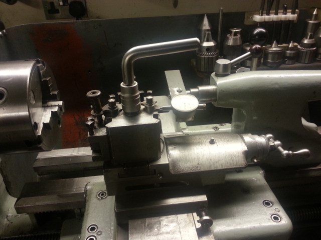

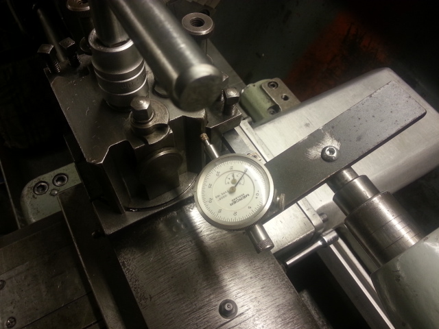

Because ime a tight a%$e i had to make a new bearing for the wifes tumble drier which needed precise shoulder measurements so i made a poor mans DRO
...put a flat on a taper and fitted a bit of old flat bar for a magnet base. Anyway was able to machine down to a precise thou or two and it got the job done
. What has anyone else came up with to get over a problem with a bit of temp tooling??
