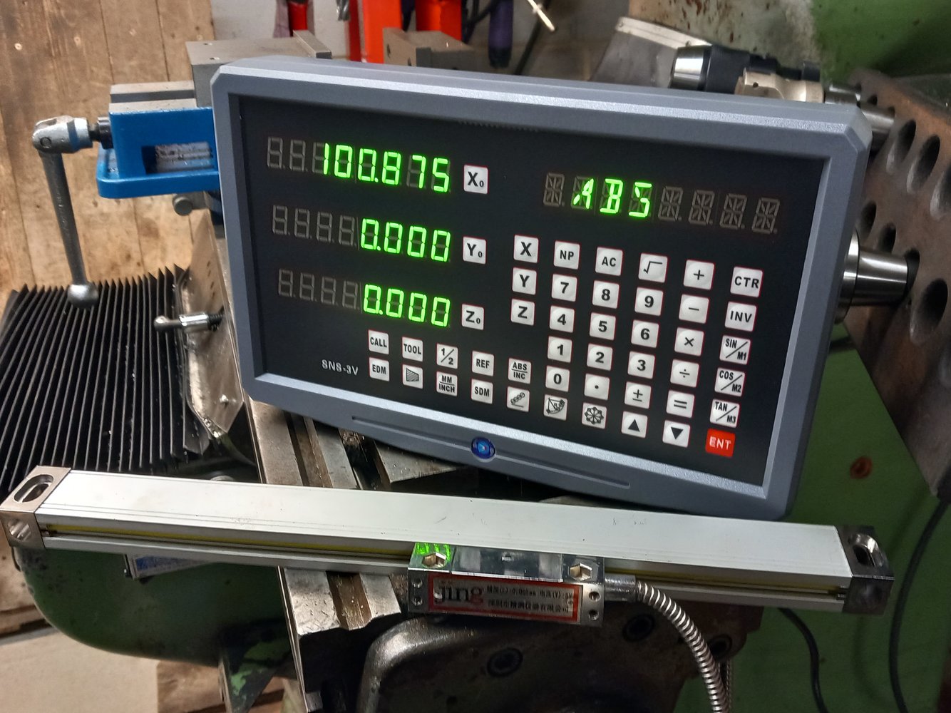

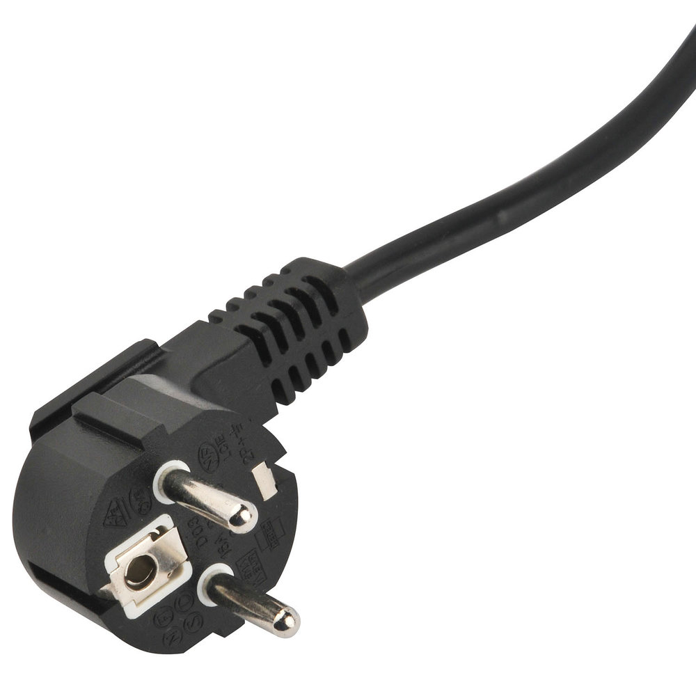

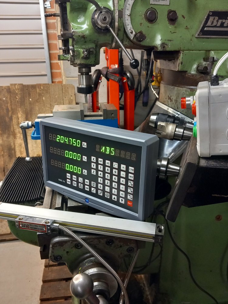

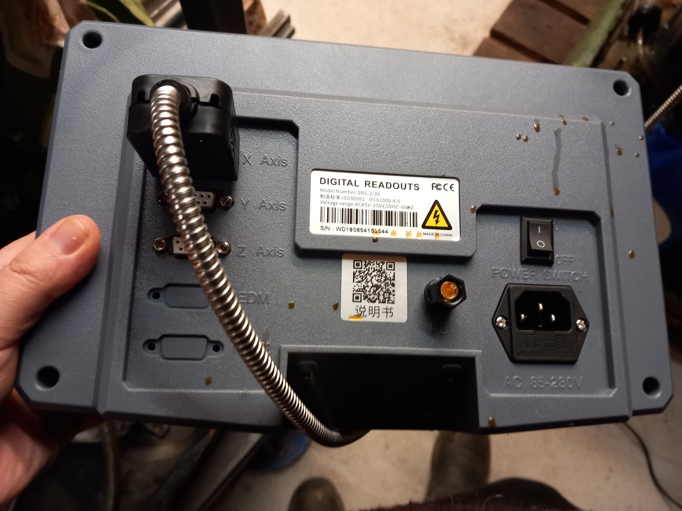

That would maybe depend on a shield being in the cable or you not having a cheap VFD radiating rf turned on at the same time. Your 2pin plug has no earth so there is no shielding either and may have no fuse. There may be no earth contact in the back of the DRO anyway.
I have a cheap 'they're all the same' older type DRO that has a separate earth tag as well as the mains earth which I connected to the machine earth.
This stuff is made to Chinese electrical regs not UK. I don't think it's double insulated due to the D types on the back.
If the read outs are not stable you may have local interference
