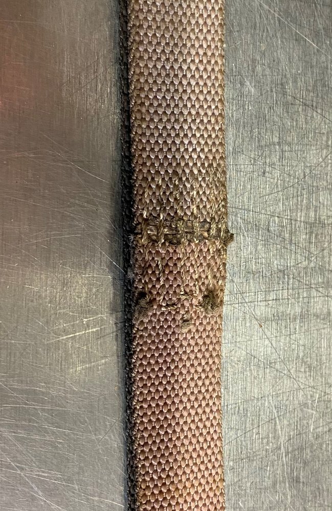

I did get a decent brand synthetic from bearingboys endless and while it performed well/good grip, the slightly odd sizes of the flat pulley steps interfered and deformed the belt hitting the upper step.What about a more modern flat belt that can be bonded with an almost invisible join, or do you want to keep the originality?
the slaping joint on overlap wont hurt the bearing but may drive u nuts.......
the join would hit the pulley in different place due to gearing......
dont know how u expect grip from that kinda belt anyway.......
You can hand stitch it with a reasonable heavy needle,
Thanks a lot for for that, much appreciatedIf so, I have several spares here, what length do you need?
Some valuable advice there re pattern and spacing - thanks a lot!Info from 11Edition Machinery's Handbook (1943) war time edition
And this is so obvious lateral thinking to be brilliant! and why we come here - I will do the butt stitch and add an outside piece to make it bomb proof, I could take it to sewing machine man but will show off with what "I" came up withButt the ends together and sew another bit onto the outside?
It could be sewn so the belt curves appropriately- so more tension on the inside of the two belts than the outside.If you sew another piece to the outside will it stiffen it up too much or flatten it out?
