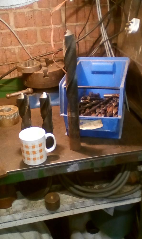

But one gent i have done a few jobs for has always brought me some bar ends, well this time he brought me some drills that he had stored somewhere, all Imperial I believe without checking everyone yet but there one in there that I may struggle to use.

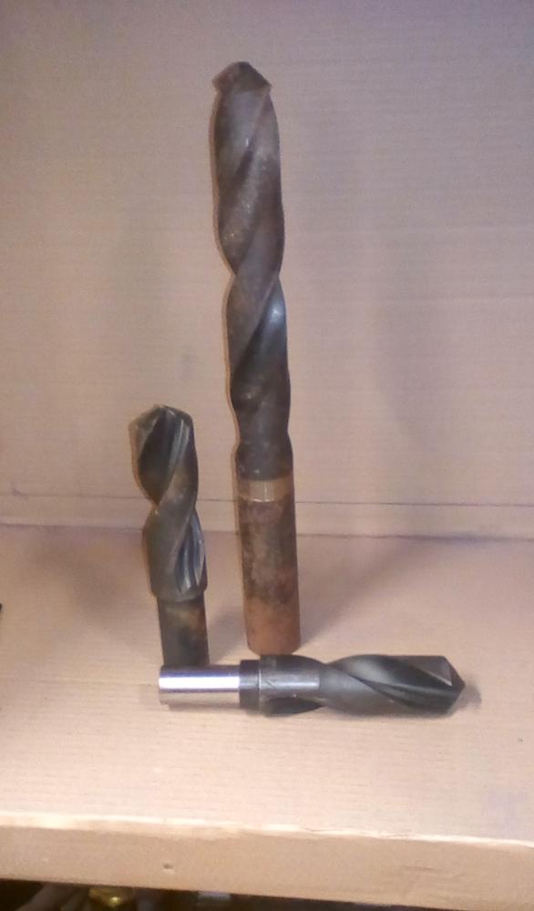

The large one is 14.5 inches long, Dormer and the three large drills are 1 5 inch diameter.
The two smaller ones are FB some English make.

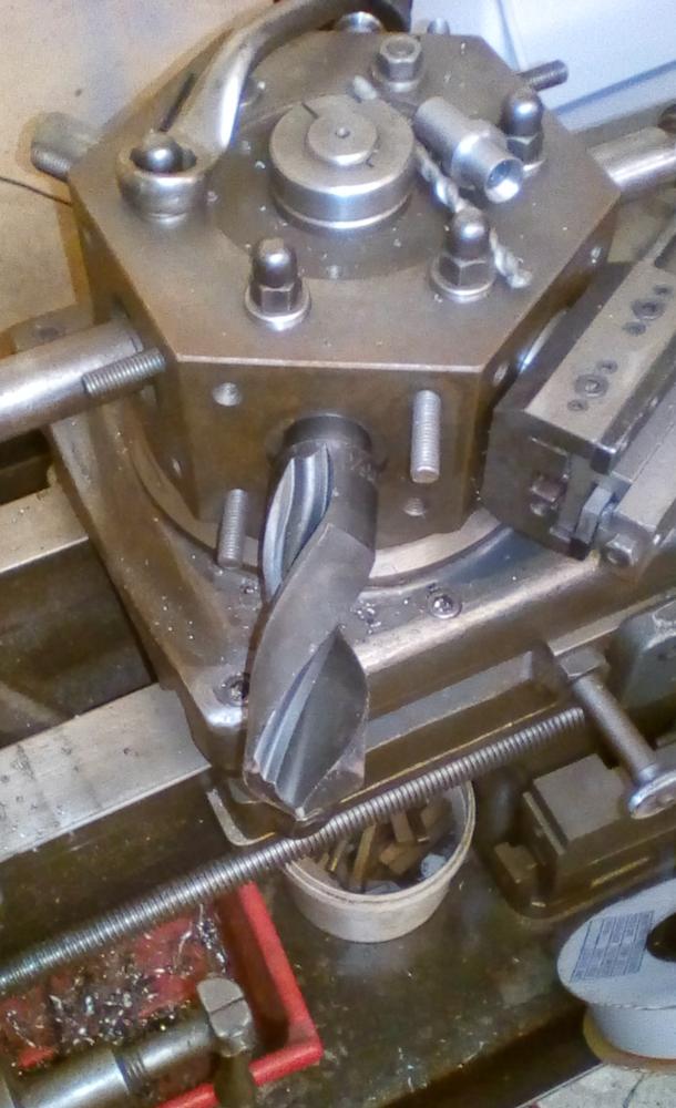

Now I have to try to put things like these to good use, so I check out the smaller, large drills and they have a reduced shank of 1 1/4 inch. So bit of very careful holding in the 3 jaw in the lathe and turn one shank down to 1 inch.
So now it fits in the Capstan/turret on the lathe!
So when I need to bore out something, I have a drill to do some large scale removal. Love it.
