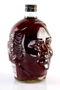

You should just go for it, think of all the rum you could drink until you get it right![]()
I stop drilling as soon as it's through and finish it off with a cheap set of diamond files. You can also sharpen the drill bit with them.best carried out while on last glass, drill on hammer![]()

I've drilled holes in window glass with a masonry drill & a hand drill, just gone gently & very little pressure, just let the weight of the drill do it.Ok, project now complete and I will post up some pictures latter on
The proprietary glass drill was rubbish, was just skating over the glass.
I used a tipped masory drill 8mm diamter, built a well with blue tac and went very slow cooling the drill bit as I went along. Took a couple of mins
The liquid also absorbs the shock wave created by the drilling & this is why the glass would shatter. See you tube for video of cutting a glass disc with a pair of ordinary scissors. Easily done as long as the glass is submerged in water.Go slow, use a hand drill.
White spirit or meths as a coolant will help.
Build a wall to keep the liquid in. Let the bit do the work.
Use masking tape to mark the spot, drill through until the bit has made a mark, remove tape, build the well and away you go.
