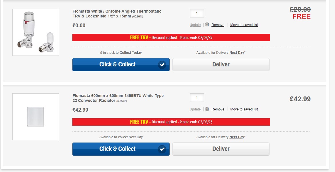

I may have ordered a small double radiator to route the exhaust through for max efficiency. Drying car towels etc.
Free TRV to use elsewhere!!

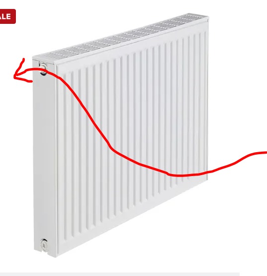

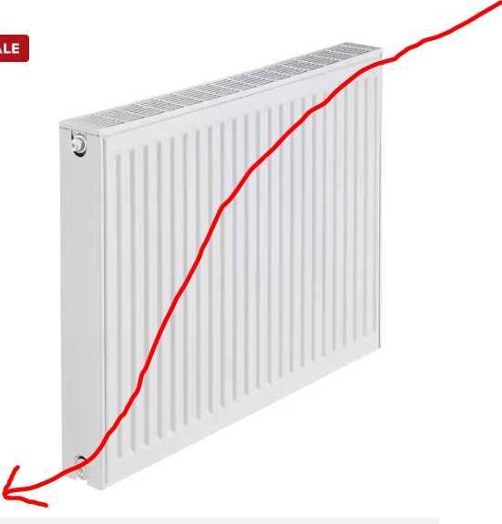

I'm thinking best to route gases in from bottom out top?
That's a nifty idea, but get a Carbon Monoxide monitor and take lots of care with sealing and corrosion control.
The bspp fittings on a radiator like that won't be 100% gas tight without suitable seals/sealing compound, and there's not many thread sealing compounds suitable for the high inlet temperature.
It's also not intended to have high temperature combustion gasses with Oxygen, Water Vapour, SOx and NOx inside it, increasing the rate of corrosion.
Your intuition that counter current flow (hot gas in bottom, and cooker exhaust out the top) would be the most efficient is correct for a well designed heat exchanger, however...
I'm not sure that will be a very efficient air-air heat exchanger though.
You would normally want each path to have the smallest feasible hydraulic diameter (4 times the area divided by the perimeter) for a given flow rate to force conductive effects (heat going from the gas to the shell) to predominate over convective effects (hot gas warming cold gas inside the shell).
The smallest feasible hydraulic diameter for a gas is much smaller than for a fluid, so I would expect a lot more heat to flow through the radiator than is transfered to the environment.
But, because of how convection works you could somewhat mitigate that source of inefficiency by using a co-current setup (hot stream enters at the top and the exhaust leaves through the bottom).
Like your first diagram.
This would end up heating a smaller volume of room air to a higher temperature (but in a well designed heat exchanger does so at the expense of transferring less enthalpy overall).
More importantly from a practical point of view, a Co-Current configuration would allowing condensation to naturally drain to the outside via the exhaust, reducing both corrosion risk and maintenance requirements.
