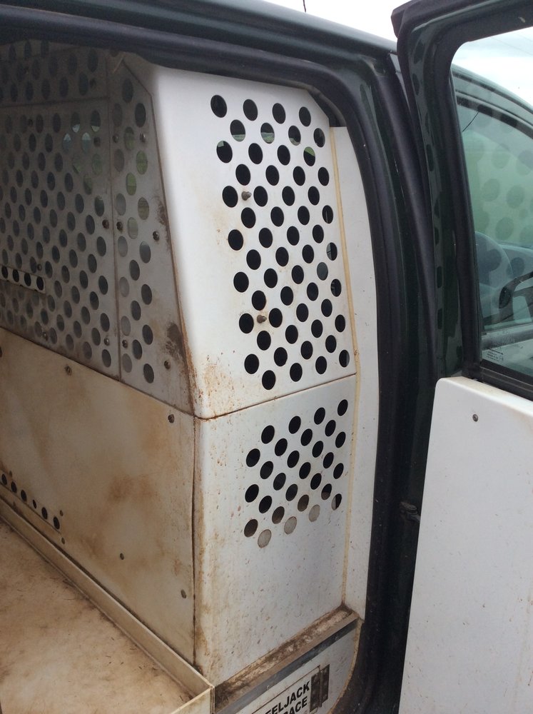

Its a double cab where the back seats have been chucked out and replaced with a flat floor

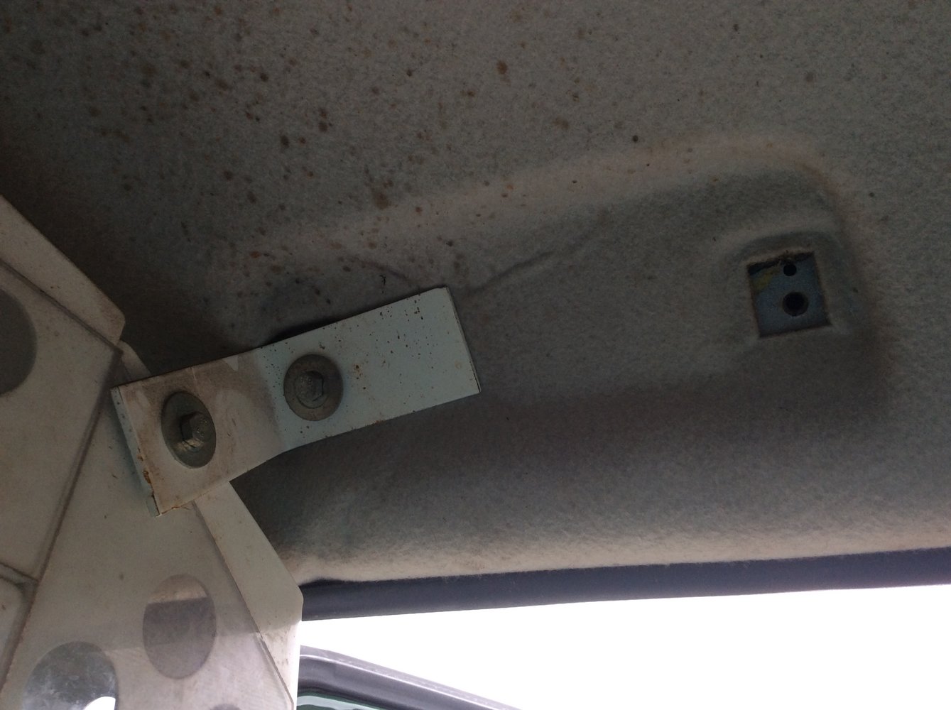

I think the plan is to put the guard just behind the front seats rather than just behind where the back seats were,,If the seats have been taken out, you dont need seat belts. Remove the seat belts and then use the seatbelt holes to mount the dog guard.
