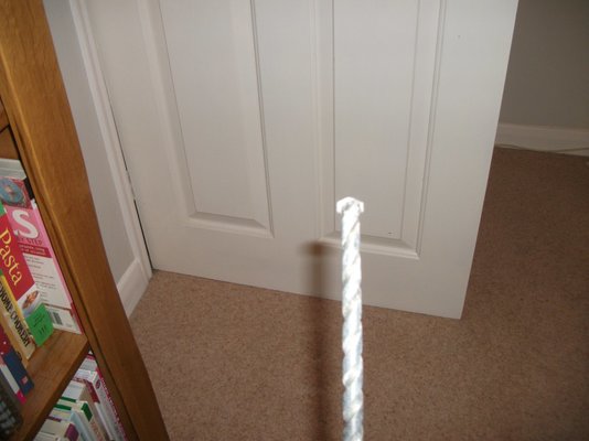

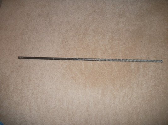

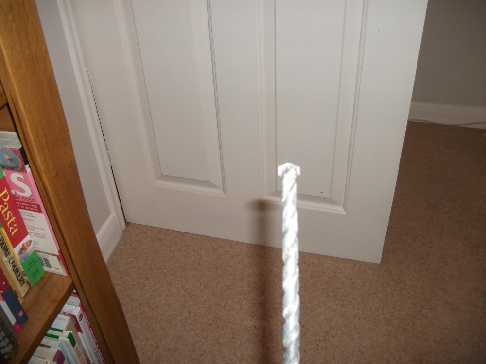

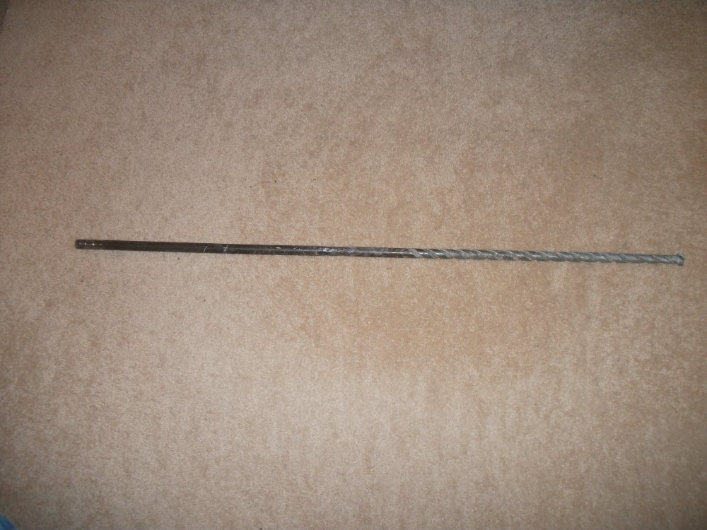

The reason I had to start drilling from the inside was because I used a 100mm x100mm box section post either side, one side had the hinges, the other side had the locking mechanism.
Welded to the back of these posts were two plates approx. 10" square, with holes in each corner for drilling, 8 holes per side.
The posts acted as a spacer to give clearance from the shutters
