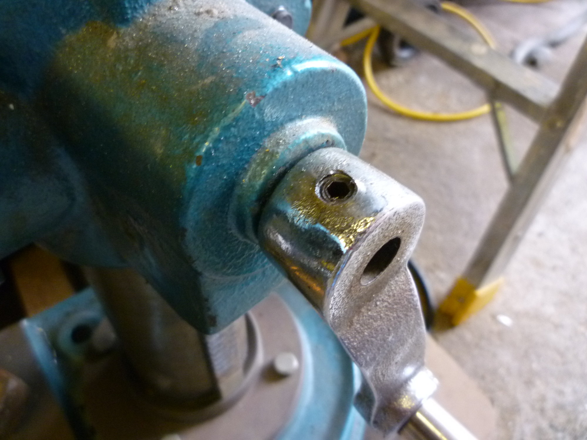

I've had a bit of time on the clarke drill press I got first of the crank arm for raising the table the grub screw was duff ( to many times with the wrong size allen key ) managed to remove it and redrilled and tapped for a new m8.

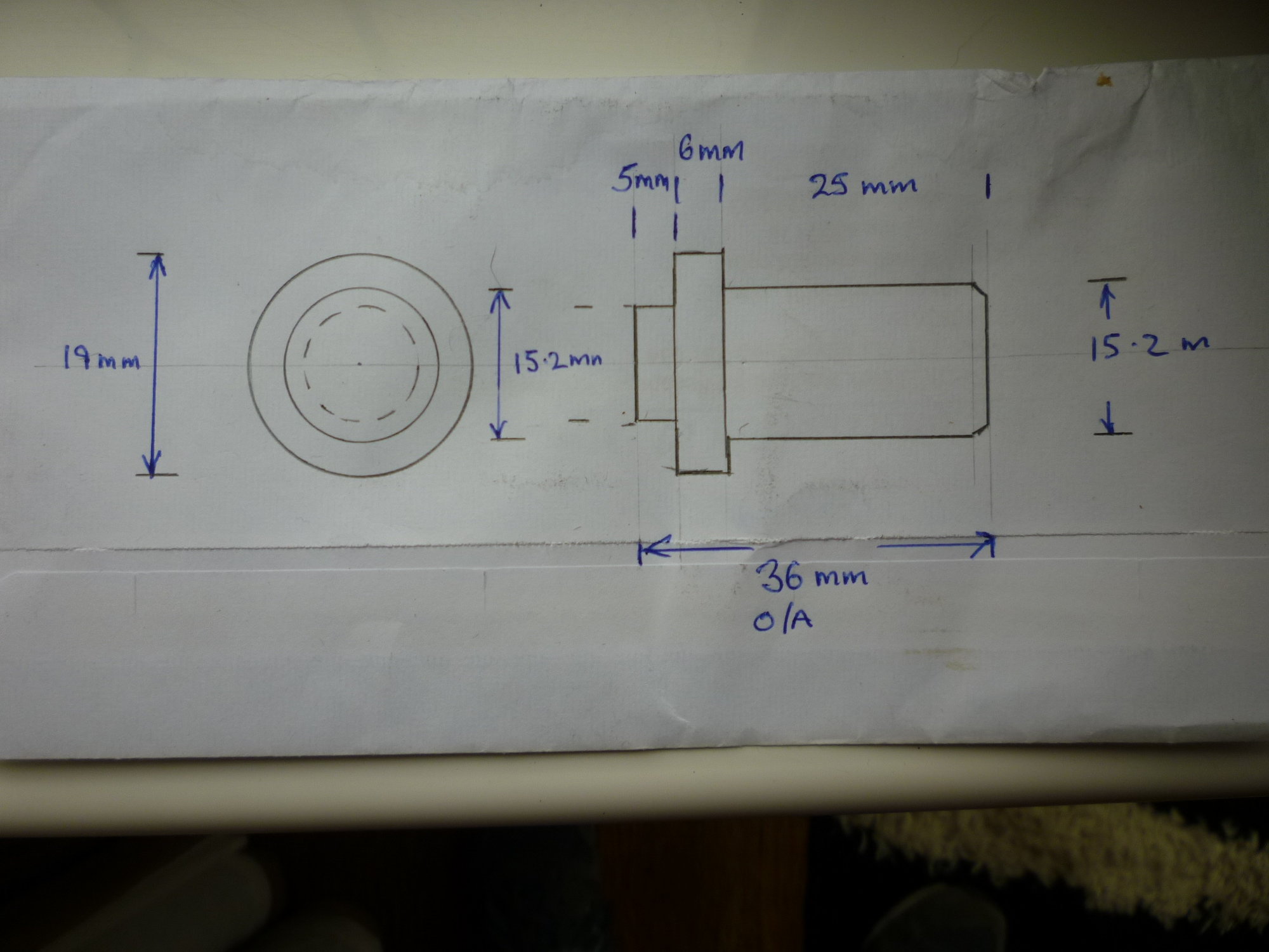

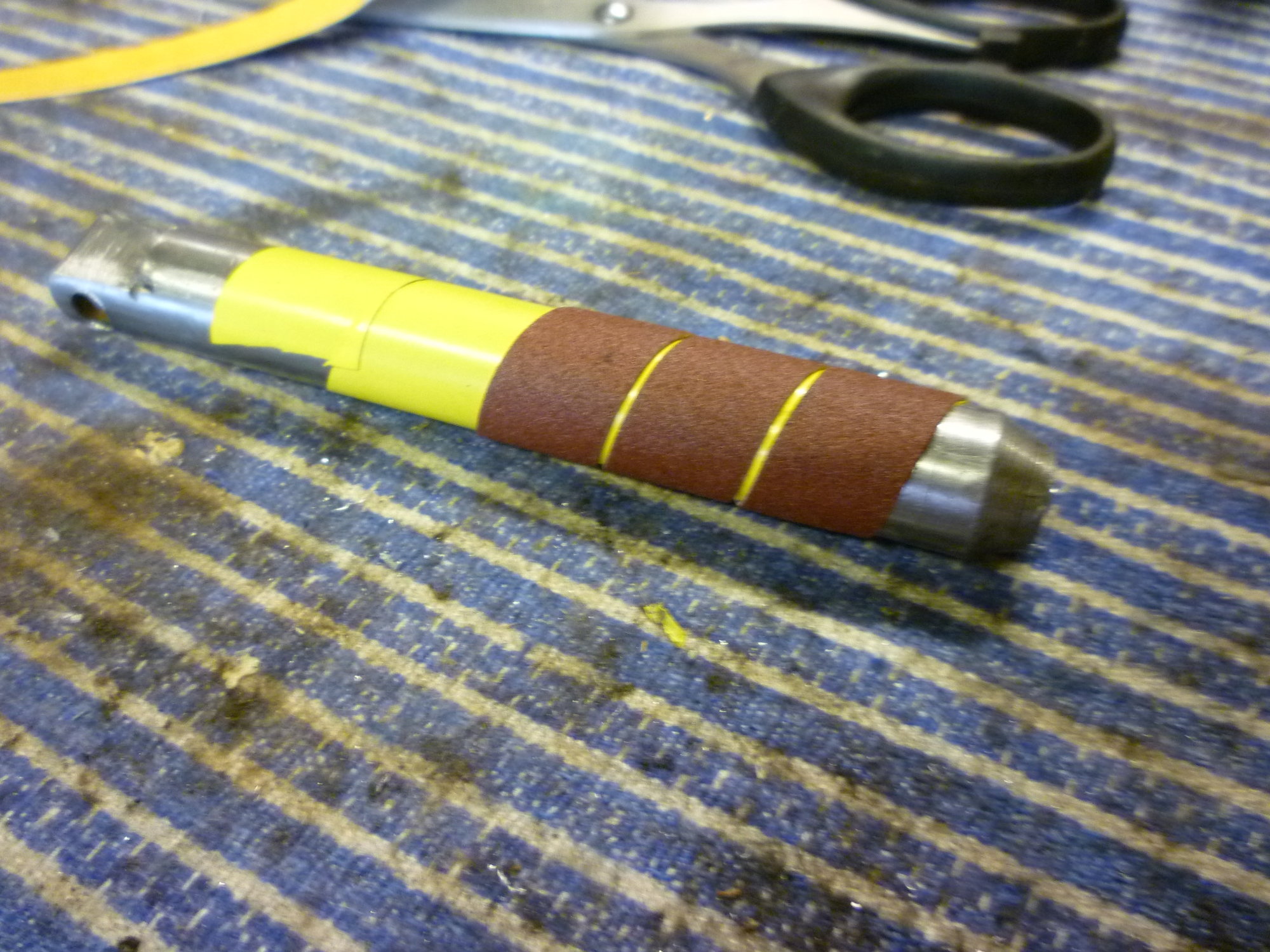

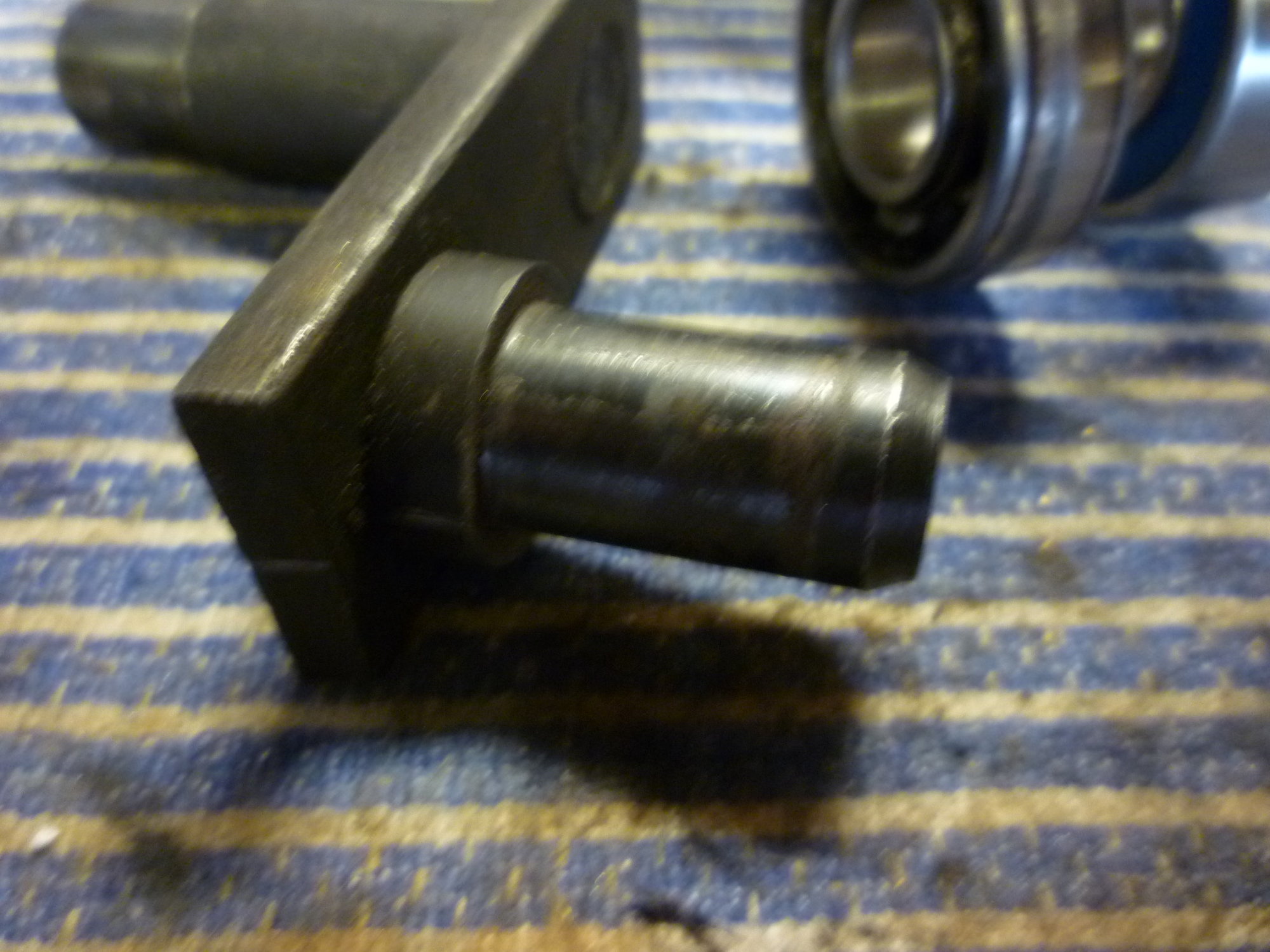

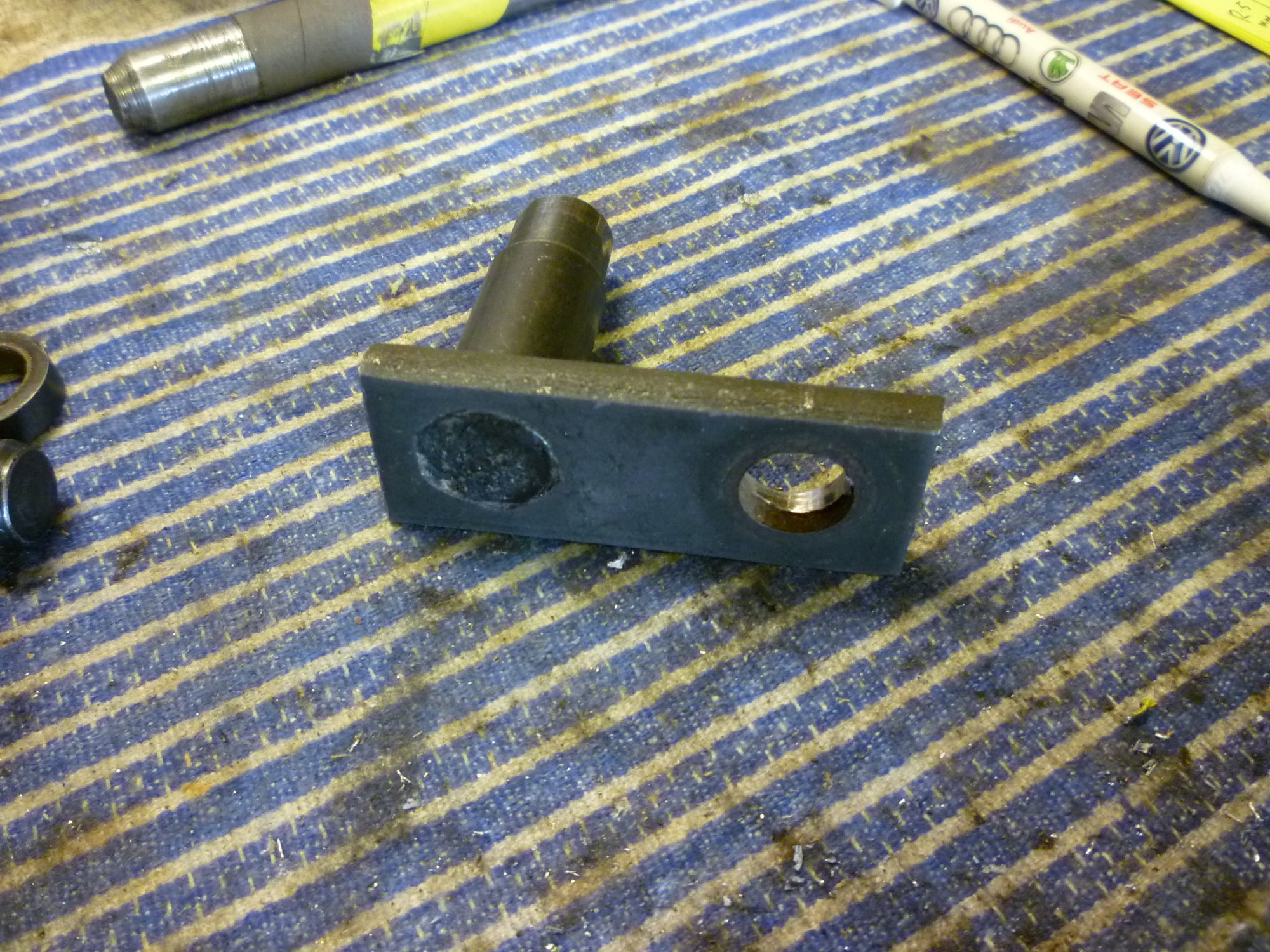

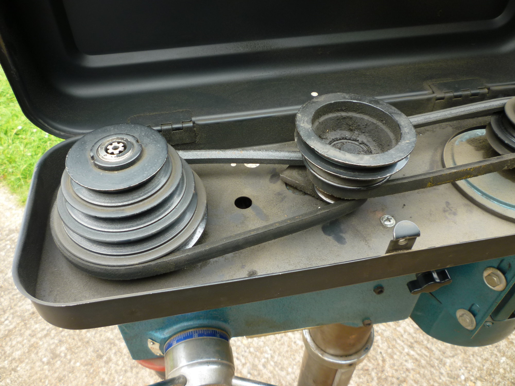

next the pin holding the idler pulley wobbled in the hole like a sausage in a bucket I've reamed it to fairly straight with what i've got .
Now anyone in or around Newcastle who could machine me a new pin to weld in the pulley arm ? beer tokens obviously.

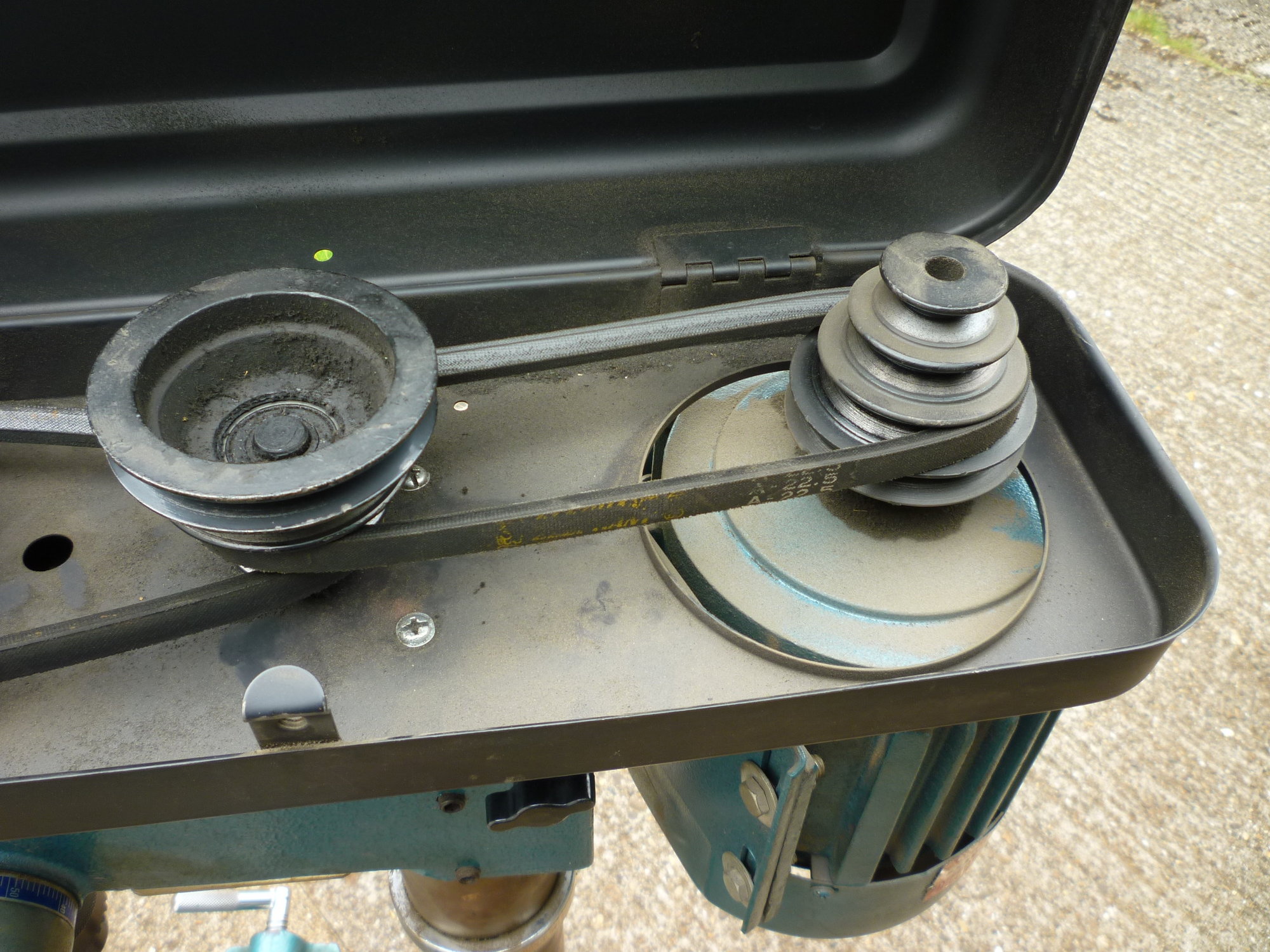

The bearing in the pulley itself was also duff so a new deeper bearing has been aquired for that . lastly the two belts aquired of fleabay are way too short even though they are supposed to be correct for the press a CDP 12 EB struggling on the net to find belt type and length,
any help with the machining would be great.

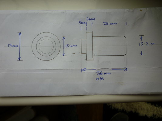

The bearing in the pulley itself was also duff so a new deeper bearing has been aquired for that . lastly the two belts aquired of fleabay are way too short even though they are supposed to be correct for the press a CDP 12 EB struggling on the net to find belt type and length,any help with the machining would be great.
