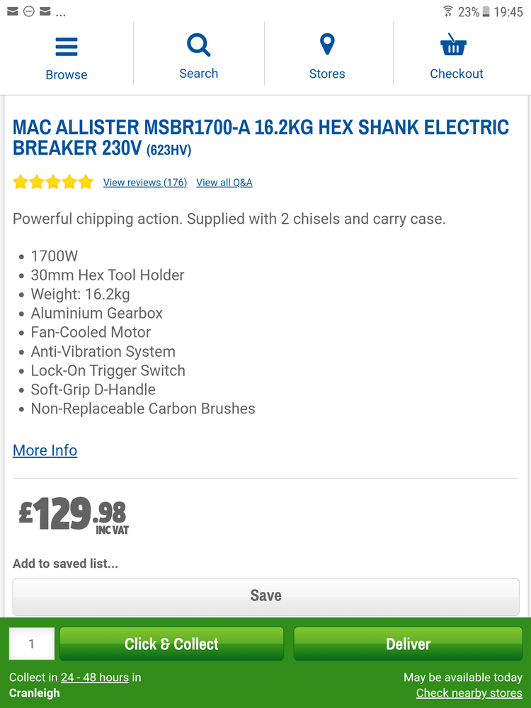

Realistically I only need to break concrete. Of the two machines linked to, the MacAlister seem to be a decent breaker, 1700w motor. I did feel a bit unsure about the non-replacable carbon brushes?? What is the fix when they ware down?Do you want to drill and break or just break.

Electric breakers come in roughly four sizes: SDS plus, SDS max, approx 15kg (e.g. https://www.screwfix.com/p/mac-allister-msbr1700-a-16-2kg-hex-shank-electric-breaker-230v/623HV) and big (e.g. Hilti TE2000), equivalent to a road breaker.

I've got one these and they're a great bit of kit. I believe the brushes are replaceable.Realistically I only need to break concrete. Of the two machines linked to, the MacAlister seem to be a decent breaker, 1700w motor. I did feel a bit unsure about the non-replacable carbon brushes?? What is the fix when they ware down?
This is a good endorsement for the Erbauer ebr1750. However, having read the reviews on the Screw fix site it is a 'mix bag'.It depends on how thick the concrete is? The small 7ish kg "breakers" are good for hacking off render or chipping through small areas of concrete, dig out the odd fence post etc.. but they're just big drills really. If you've a big slab of 4 or 6" thick to break up you want one of the 16kg ones. I had a Macalister one I gave to my dad which was ok but got the Earbauer ebr1750 from/by Screwfix to replace it which is hands down better. I'm a builder and have used it extensively on many jobs. It's been reliable and goes through slabs with ease. I've even used it to break up a 15" strip foundation, I thought it would struggle and only gave it a go on the off chance fully expecting I'd have to hire something more heavy duty. There's nothing so far it hasn't done! It's £200 at the moment and will have saved 1000's hiring breakers at £50 a time. That is incredible value for the performance, which is only marginally lower than a hydraulic breaker, and it saves lugging a hydraulic pack about. It probably had a decent warranty too but it'll be way out of date by now. I really can't rate it highly enough!
