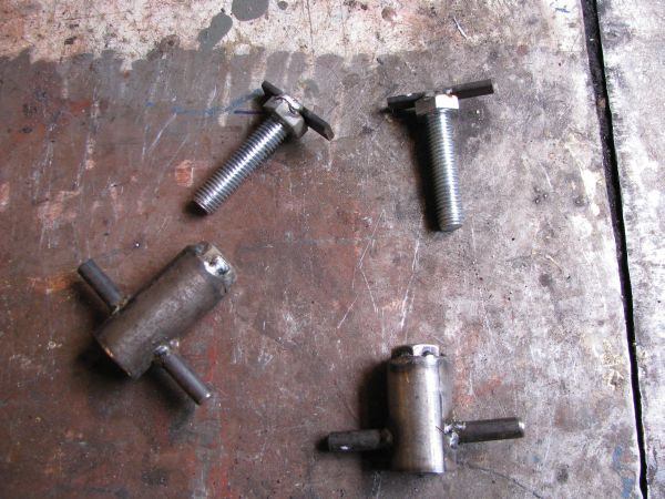

damn cold over the weekend, freezing north-easterly blasting into the workshop doors so I didn't fancy being out there much. I was poking around the worktop, cleaning up, and I found a bag with a couple of biggish bolts that I'd bought a few weeks back to attach a clamp to my drill stand. The drill's a big old American thing that I've had for a few years and some months ago I picked up a sliding clamp off a car-boot for a couple of quid.
It's been attached with M6 bolts since, but they're too small, bending the washers into the holes, plus it needed two spanners, one on the nut and the other on the bolt, to make any adjustments. I was looking for something with 'wing-nuts' to make adjustments quickly. The problems would be that wings on the bolt-head would foul any metal in the clamp, and there's a couple of strengtheners underneath (would webbing be a good word?). So I decided on the bolt-heads having a bit of flat on top that would foul against the clamp sides and the nuts would have a tube spacer above the washers.
I grabbed some 1" tube and found that the nuts just slipped inside, so I changed the design a little and came up with this...

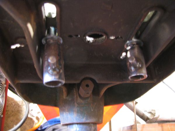

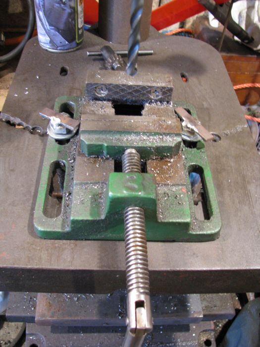

the slots in the table were just a little out of line with the clamp so I ran the grinder down the inside of each for a minute to take a couple of millimetres off and clamped it all up.
![drill2.jpg drill2.jpg](https://www.mig-welding.co.uk/forum/data/attachments/8/8498-ff9e8b48e53a00286050601a87982b7a.jpg)
![drill3.jpg drill3.jpg](https://www.mig-welding.co.uk/forum/data/attachments/8/8499-de7610e936bb5d91ec9ecbdd44db7605.jpg)
Not much of a job really, but it got my brain working for a few minutes and it does what I wanted it to do!
