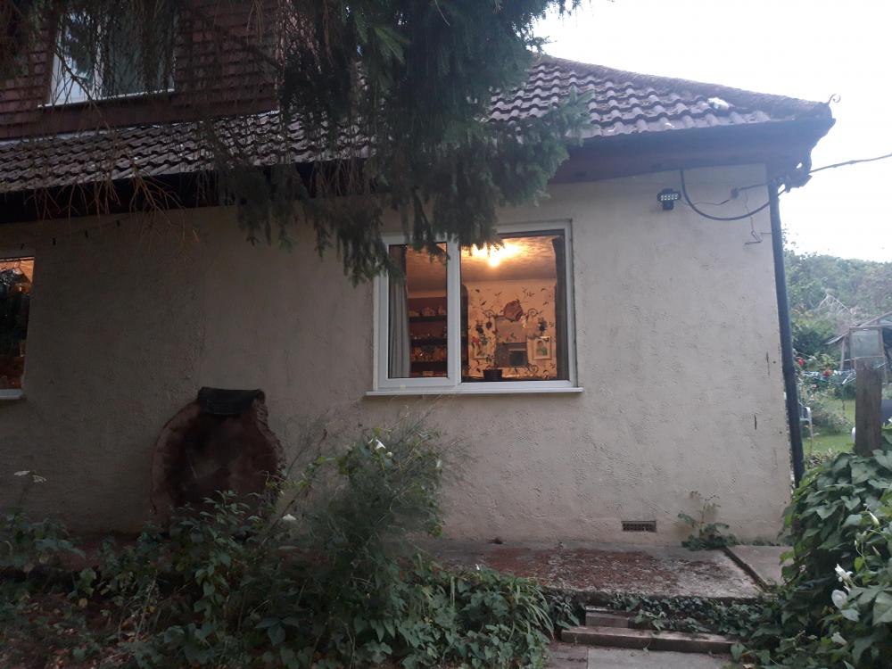

That picture suggests the downspout water isn't being moved away from the house?This is the same window from the outside. I need to whip the external beads off the top and sides then foam the undoubted gaps. I'll then have to chisel off the old super glue and fit wider beads. Around the corner from this window is a set of ancient Everest patio doors.

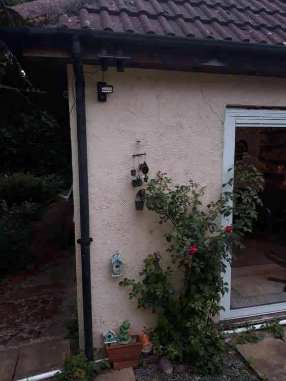

Tbh I think this room might be falling off the corner of the house. See the nice crack?
These doors need to be changed pronto. Trouble is the ground is too high outside. Well, the lounge floor is too high and when dropped level with the rest of the house, the outside ground and inside finished floor will be about the same level.
Broken or missing pipes?

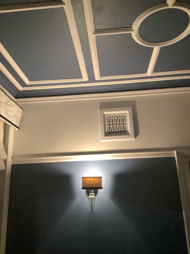

You could look into a thing called, if memory serves, "passive stack ventilation" it's basically what you have. But in more recent times, the chimneys are combined with valve that opens/closes based on humidity. So, once the house is adequately (in terms of humidity at least) ventilated, the vents close up and draughts reduce. Might be a relatively easy to retro fit the valves to yours.I have 4 of these in my house, passive ventilation shafts, each one leading to its own chimney pot. I feel like I’m heating the the outside world, they might be to let out the fresh air coming in through the sash windows

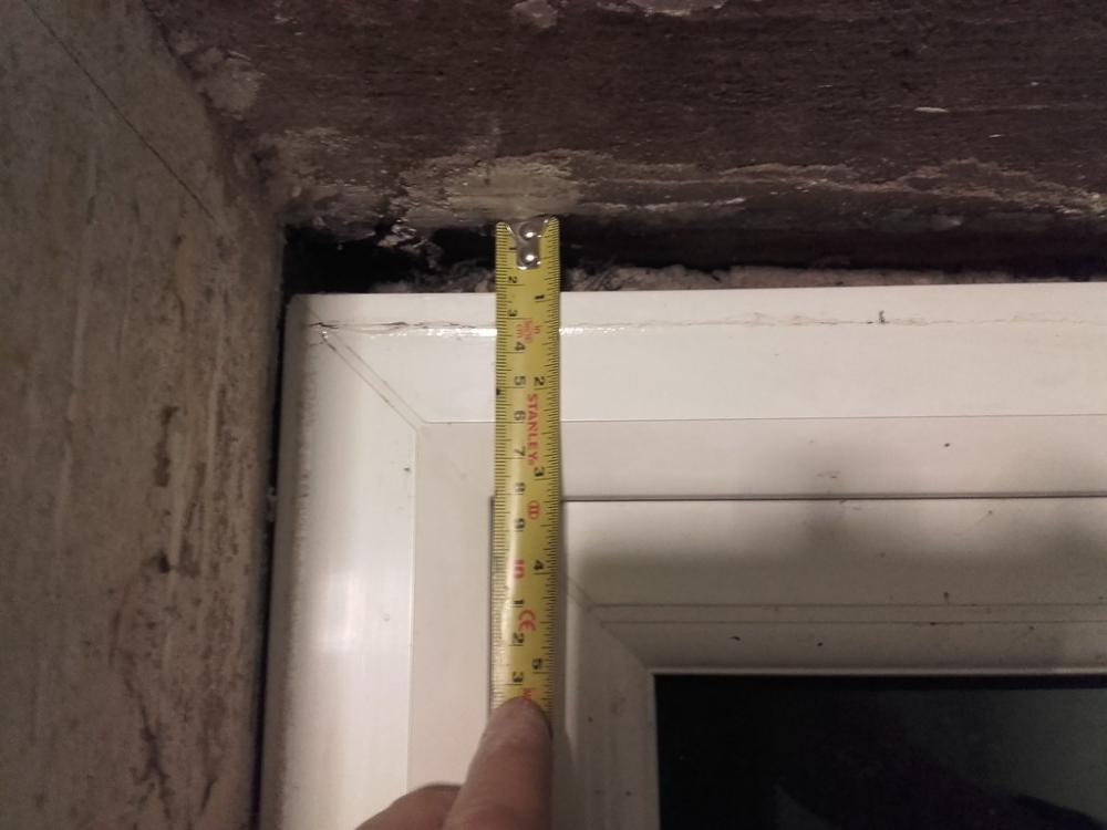

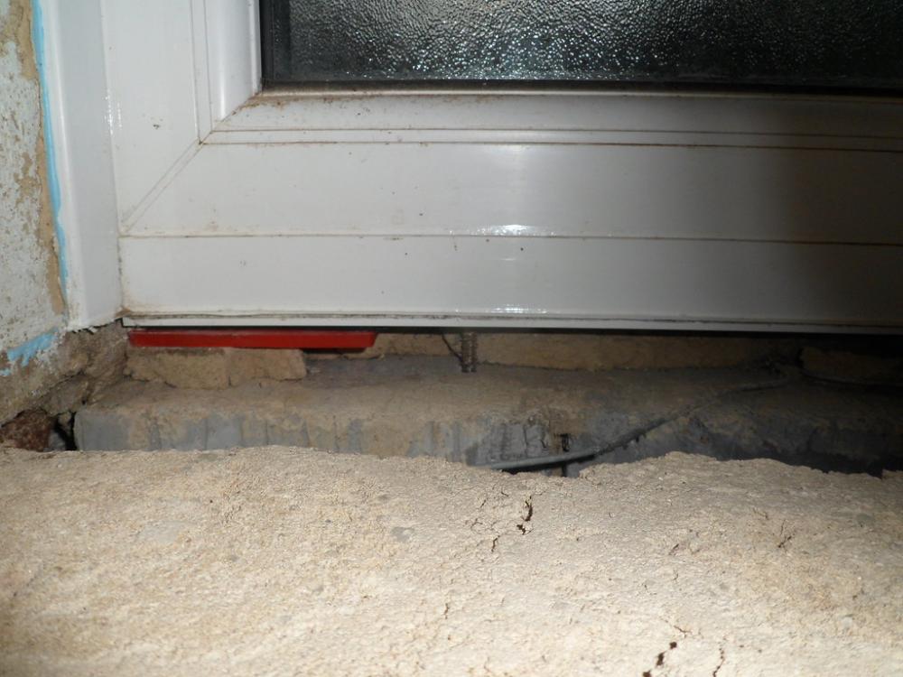

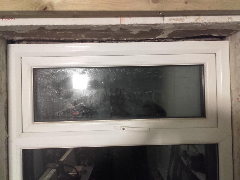

Modern plastic windows, Ummmmm
I blame the fitters,
Yes,
All of them,
Absolutely shocking workmanship throughout,
I have never seen a well fitted plastic double glazed window,
Ever !
Only the ones I have fitted myself![]()
