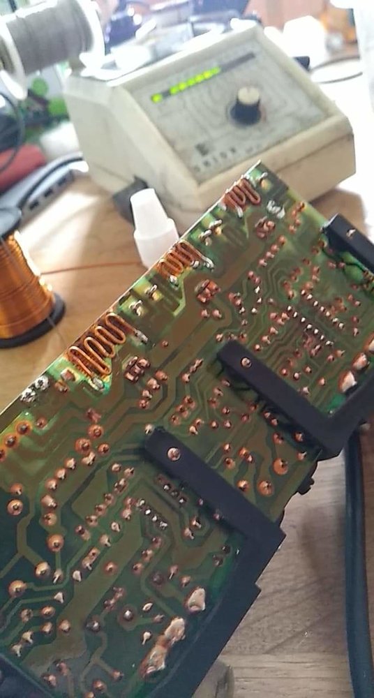

Yes, that is a short, there should only be conduction in one direction - Gate positive to Cathode negative should conduct, reversing the meter leads, it should block.Could somebody confirm for me please on the scr's. If I take a diode reading between cathode (K) and gate (g) in both directions and get a reading, that means there is a short
