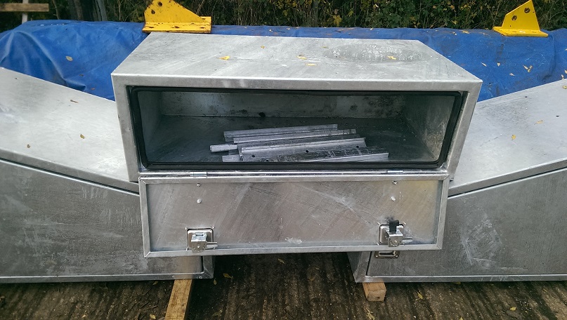

I need to design some doors into an enclosed trailer I'm building and haven't done this before. Which design approach would be best here, to ensure it's waterproof. In either approach I'd be buying some form of plastic seal but I'm not sure which frame design to use to start with. So my question is:
a) which frame design to use?
b) what plastic seal type to use with this design? (seems to be heaps of types)
c) any implementation advice welcome
As an example here is a diagram of 3 types that come to mind. First with flat bar as door stop, second with angle, and third using channel...
