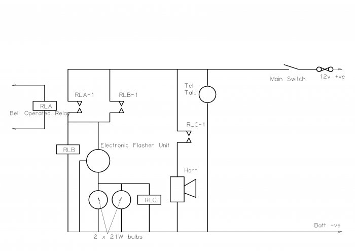

I made my own out of a few relays and a car flasher unit. Once the bell is pushed it keeps sounding a horn and flashing a pair of red lights until I stop it.
All the parts were taken from a Rover Metro, which is probably the best use to which one of these cars has ever been put.
I can let you have the circuit if you like,
