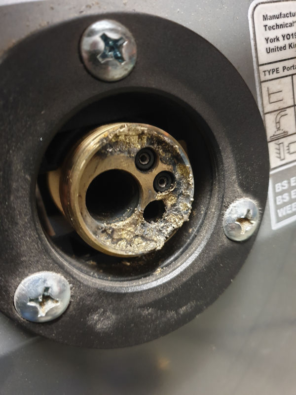

Oops. Welder was misbehaving all day and I couldn't figure out why until 200 amps went up the trigger connector and took out the circuit board. Torch connector wouldn't do up any tighter, but I'm guessing it wasn't tight enough.

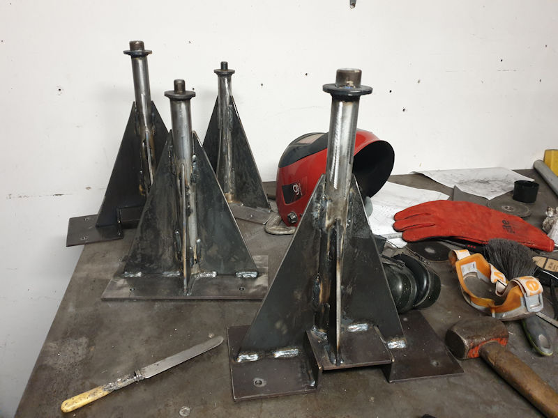

I made beautiful things - stands to hold a car up on the body jig holes. Had almost finished them.....

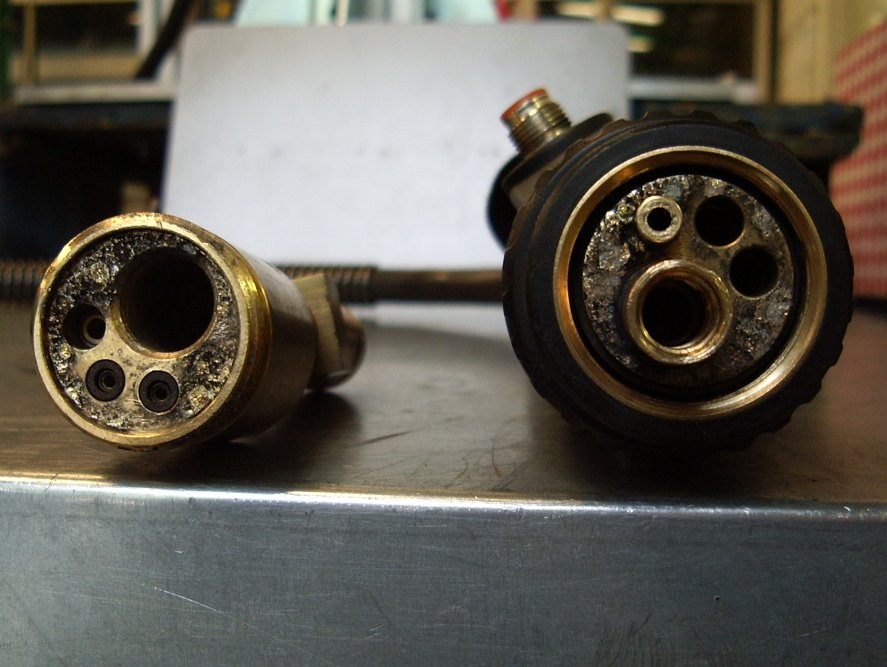

good reminder to check mine!
