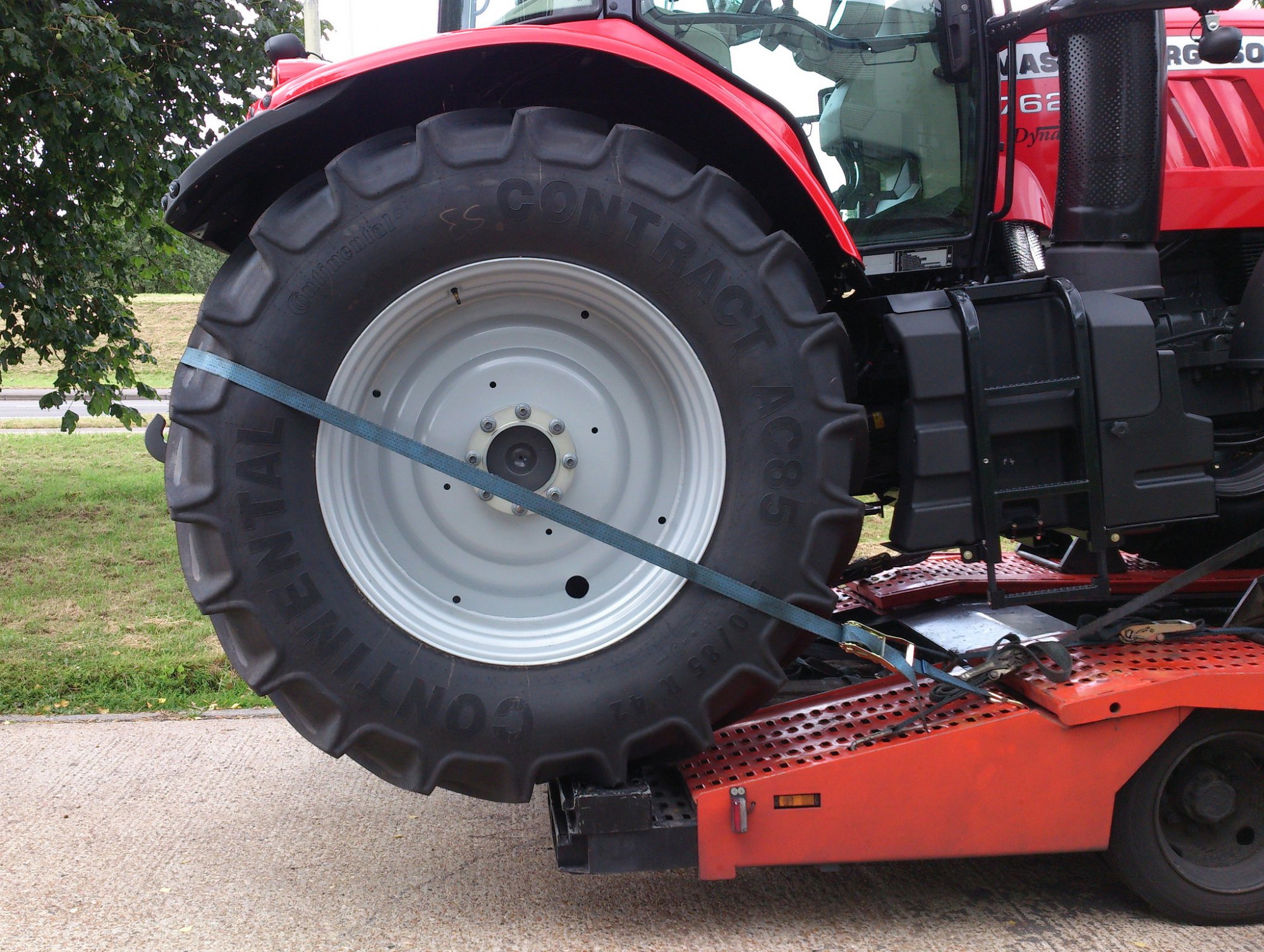

That's exactly who I thought of as well, when I was at LT they would have atleast one driver a week stopped by Police/Vosa for an illegal load, usually like that with it hanging off the rear of the trailer.That looks like 1 of de rooys trailers, they transport most of the new lorries into the uk, you often see them with what seems like an impossible load.
8I agree to a lot of that, but gravity pulls straight down irrelivant of the slope on the trailer, which makes the centre line with a plumb bob directly on the end of the trailer, undoubtably the front is very secure, to my mind would have been safer to let the ramps out another 4" or so, cant see any chains though.....he is unfortunate that rims are solid so cant chain there.
Oh and the centre line of the hub isnt over the backend as the tractor is sloped up hill not flat
So if a line is drawn from the rearmost part of the trailer at 90 degrees to the bed it will go behind the axle also the strap is not on the rearmost part of the tire so would tighten if it moved backbot slacken like stated above
Im not sayig it is perfect but i fail to see how it will go anywhere especially if a towhitch strap is used
