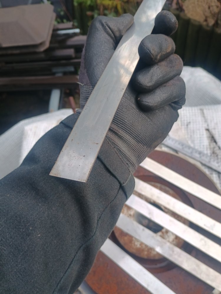

For 1.5mm sheet, I usually set mine (the one with a built in compressor) to about 2/3 max amps which I find gives a narrower kerf and a cleaner cut with less dross at the speed that I move.I have the amps to max
