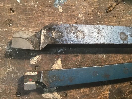

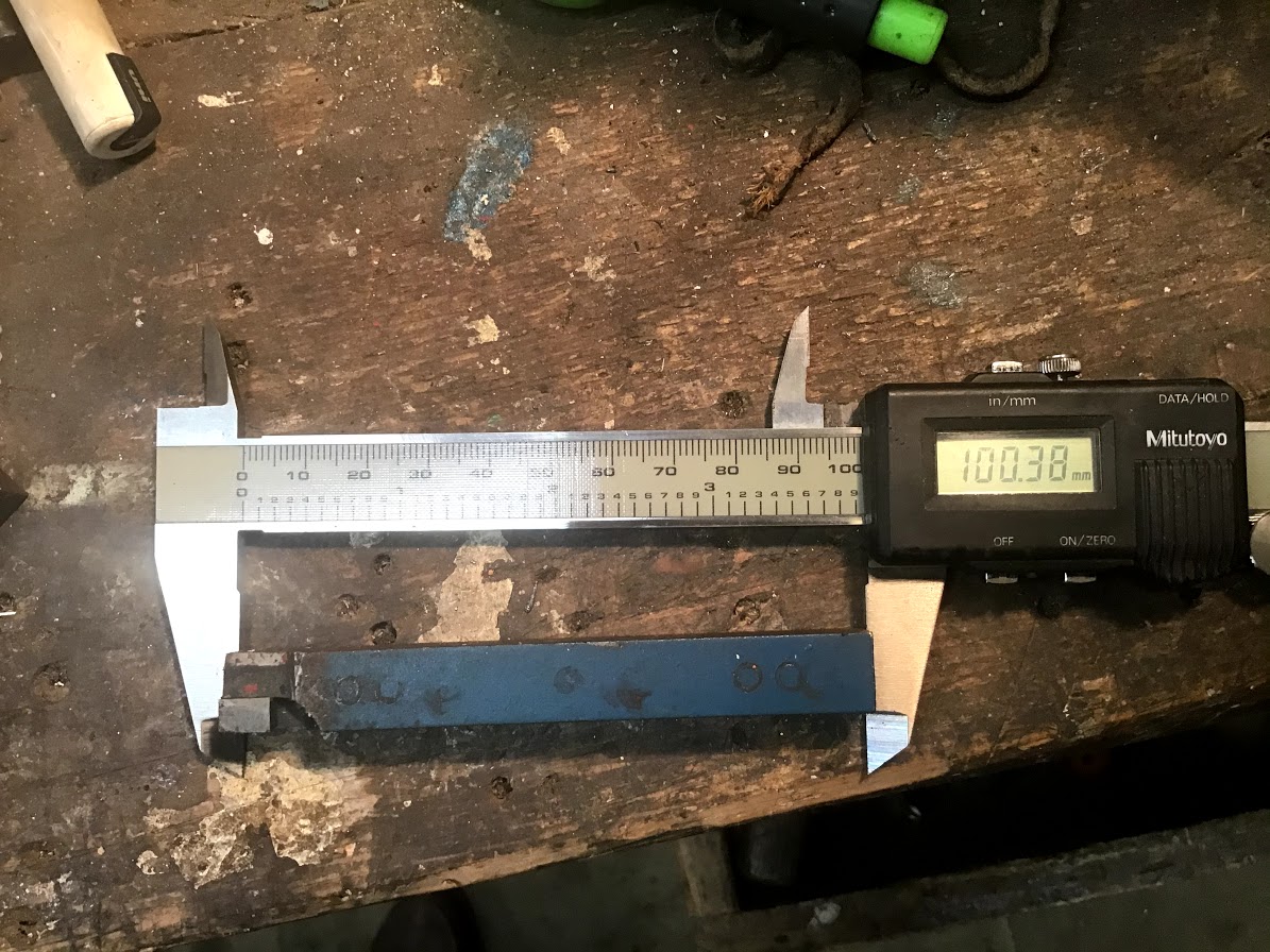

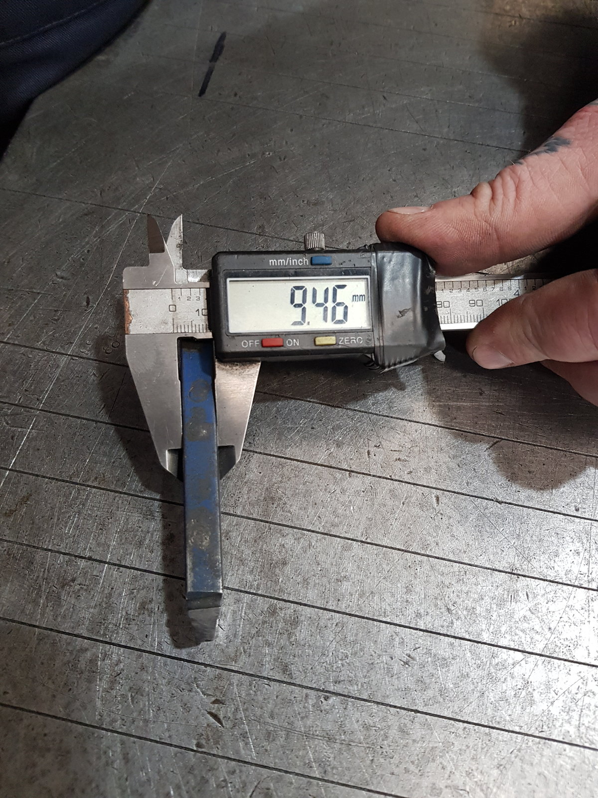

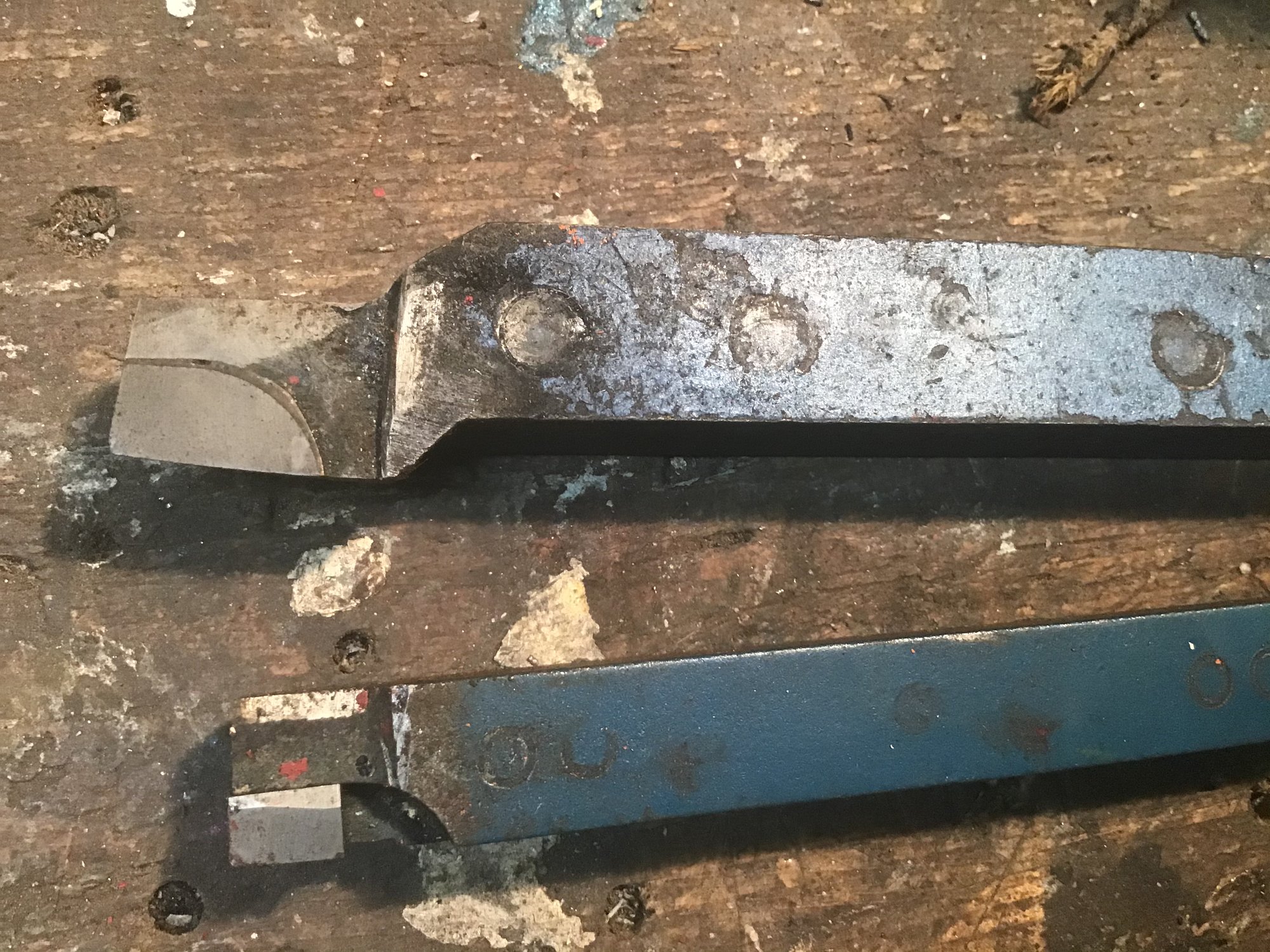

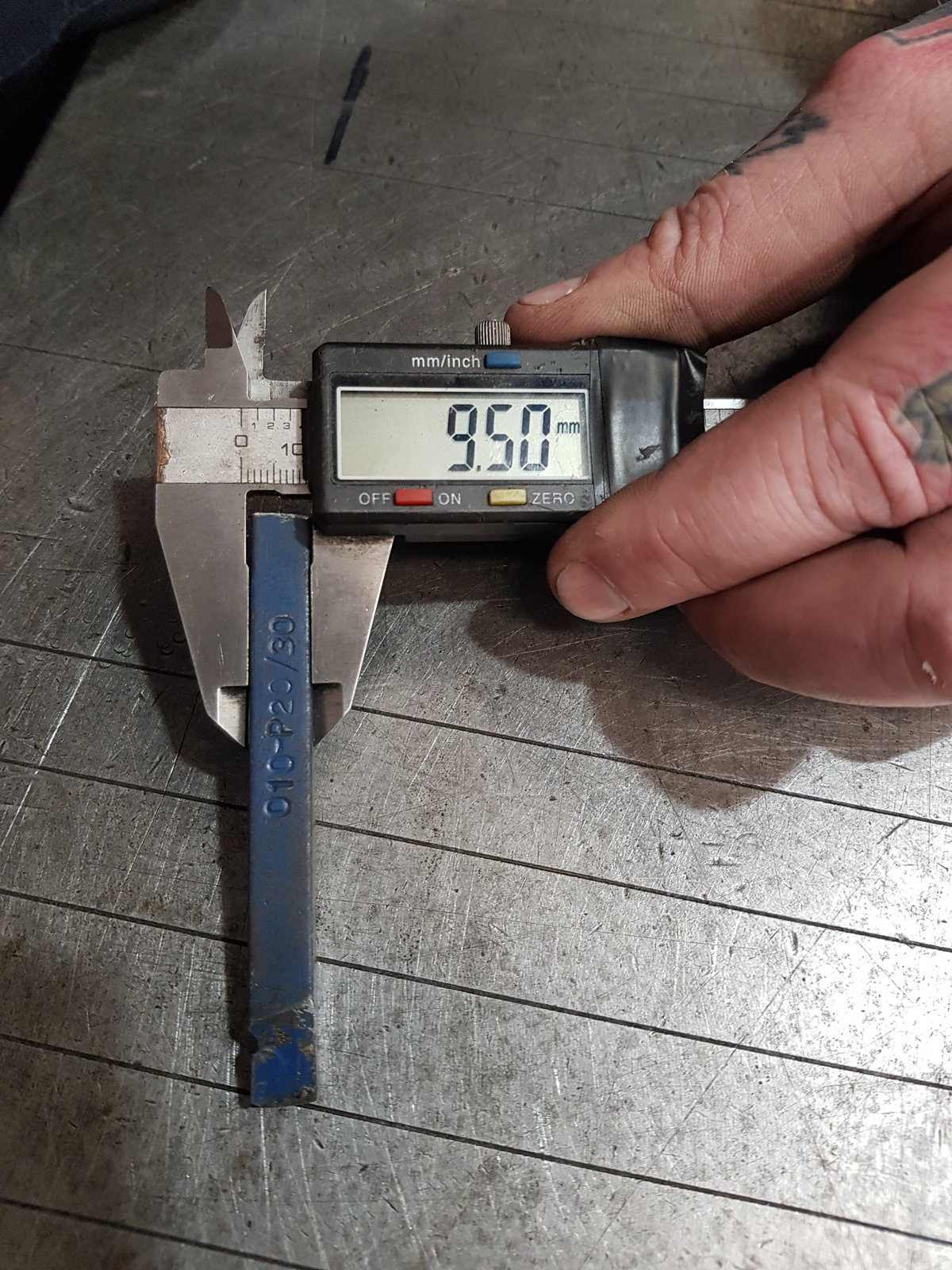

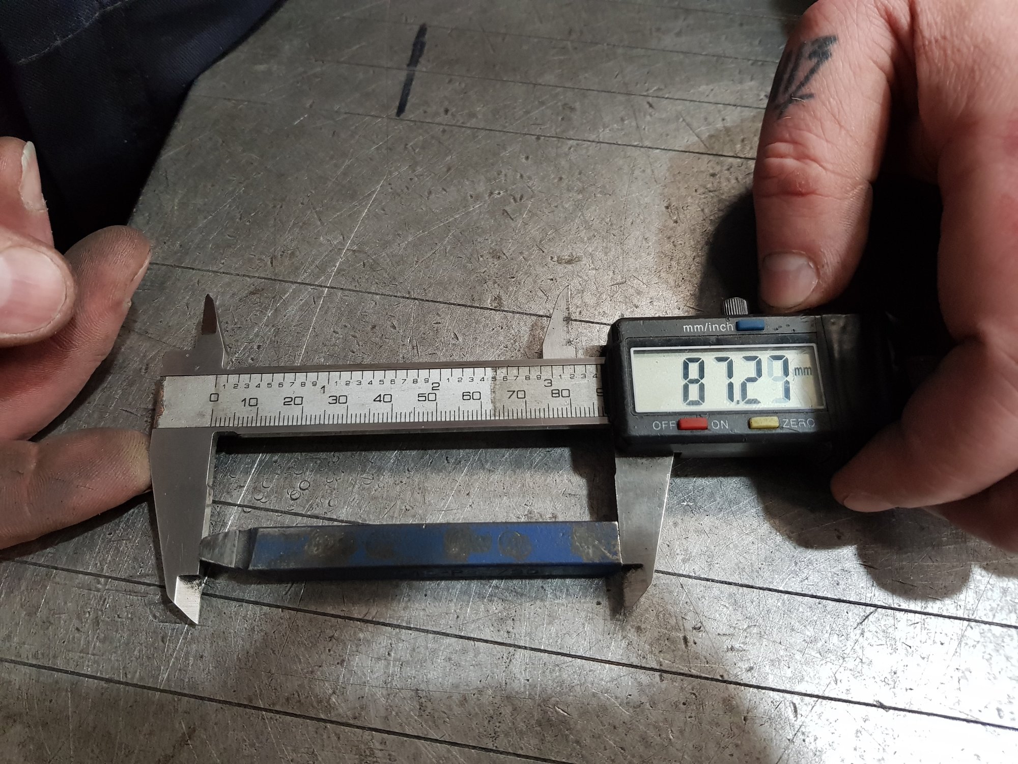

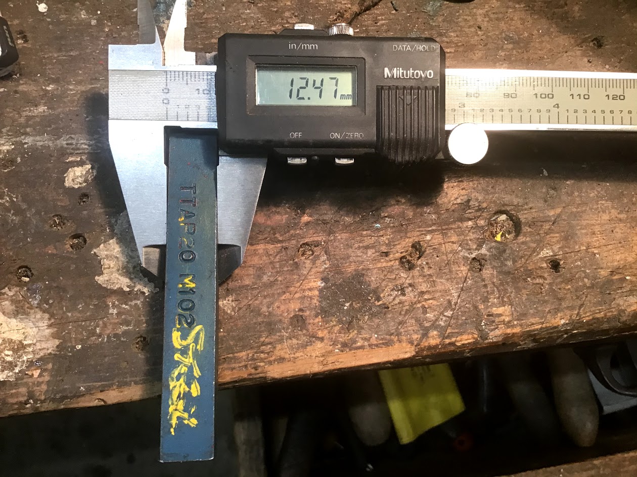

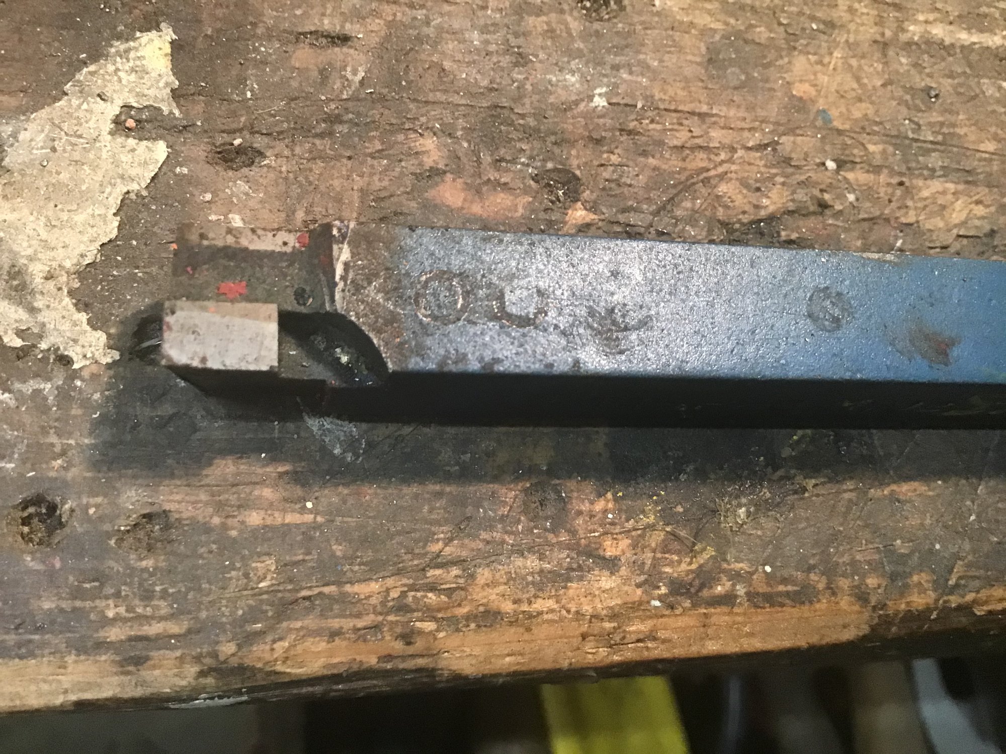

I'm after one with a flat end instead of rounded. We only use the lathe to put a couple of spring holding grooves into some 12mm bar occasionally so just want a couple of cheapies.

Can't tell from the images in the op.
Are they brazed tct
Yeah, brazed bits.

Would they cut a groove into a bar?
Runni is, we only do about 100 cuts every couple of months. We have had the lathe 8 years, it came with 2 of these tools and the second one has just died.I've a full set of original Myford brazed tip tooling that came with my lathe. Unfortunately I'm not selling it as it's part of the lathes history & it will be passed to the next owner.

OP - tools are carbide tipped:
https://www.rennietool.co.uk/collections/brazed-carbide-tipped-turning-tools
