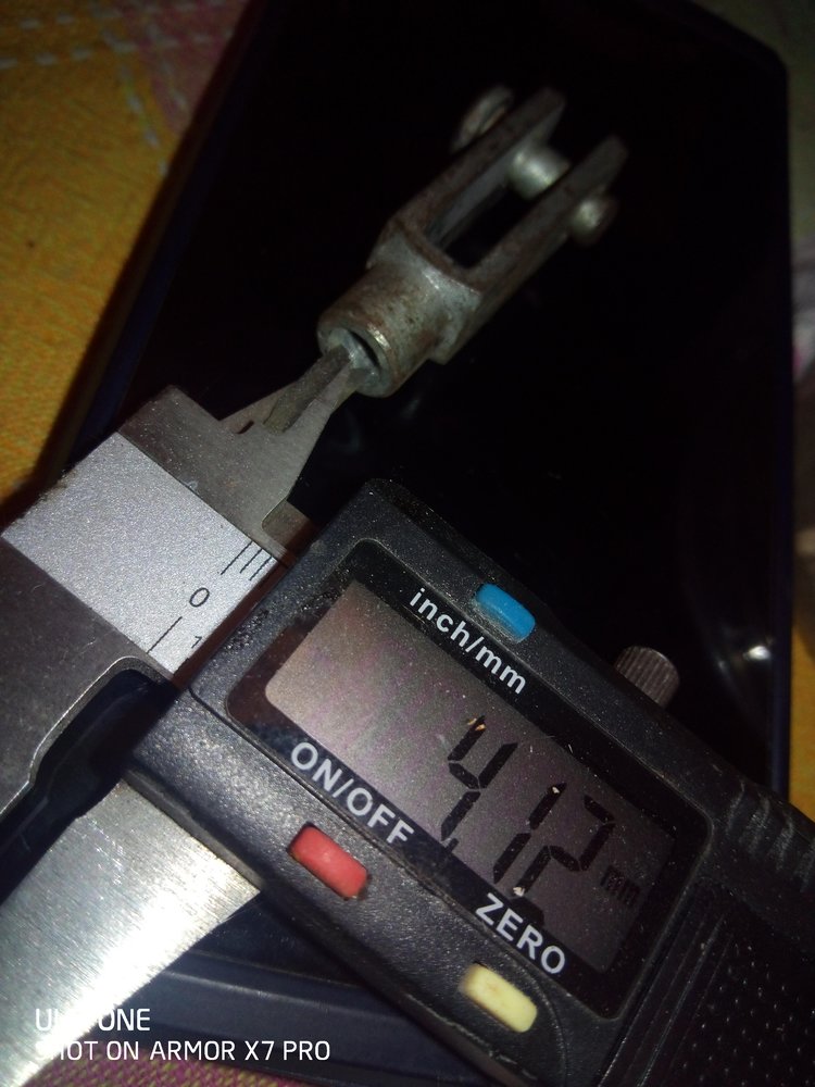

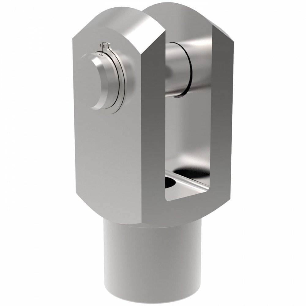

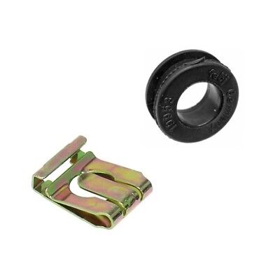

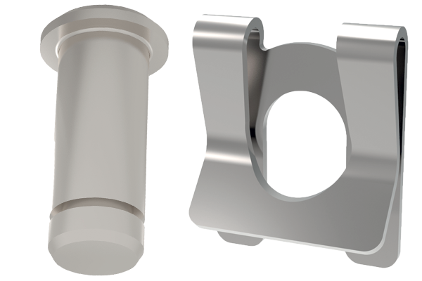

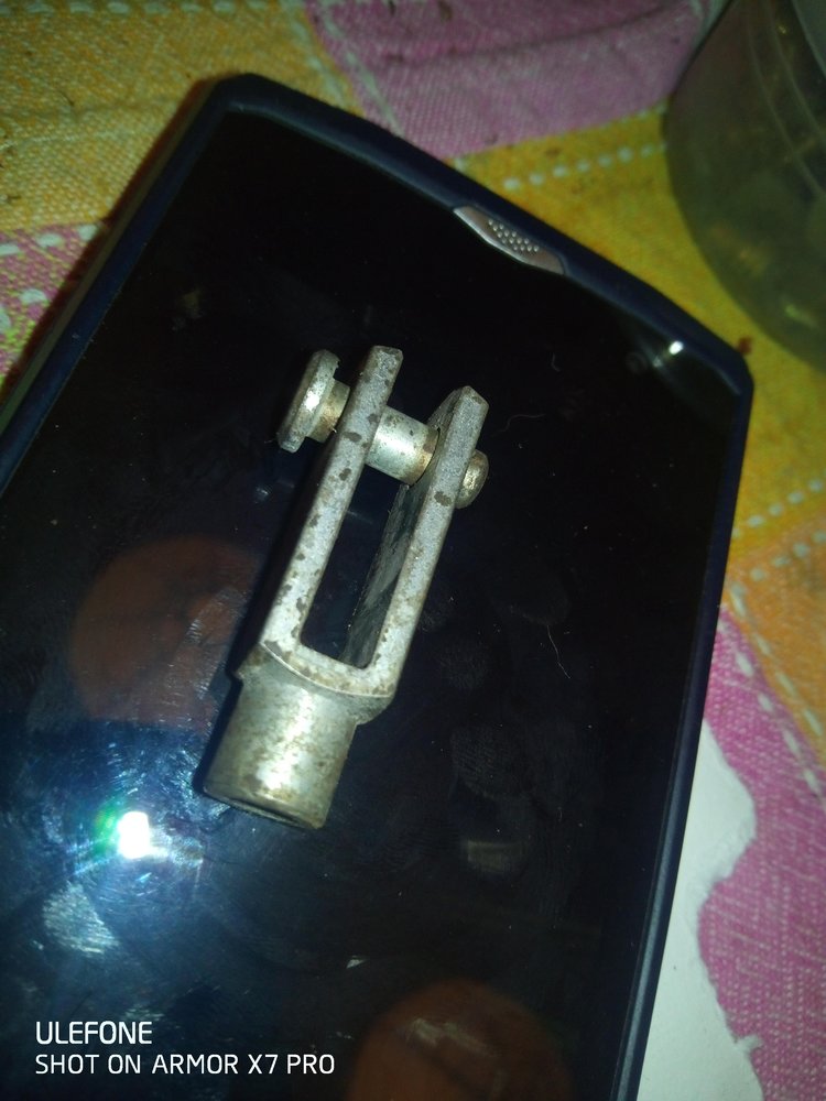

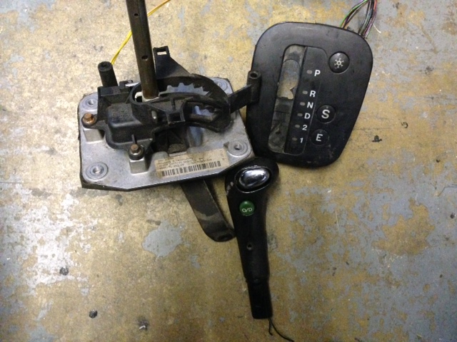

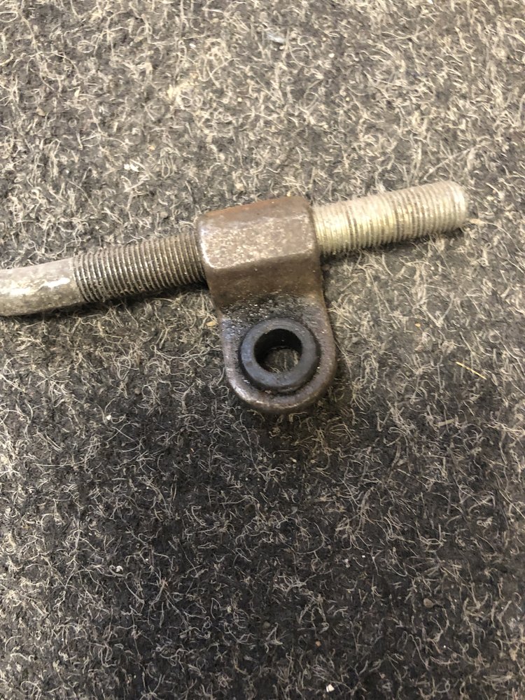

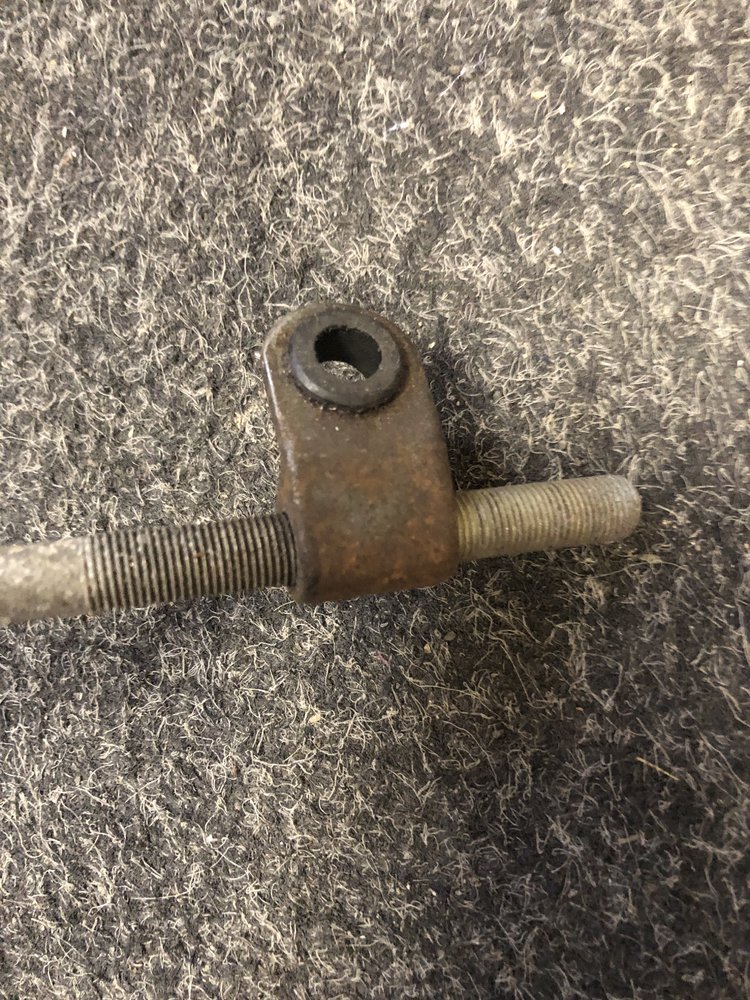

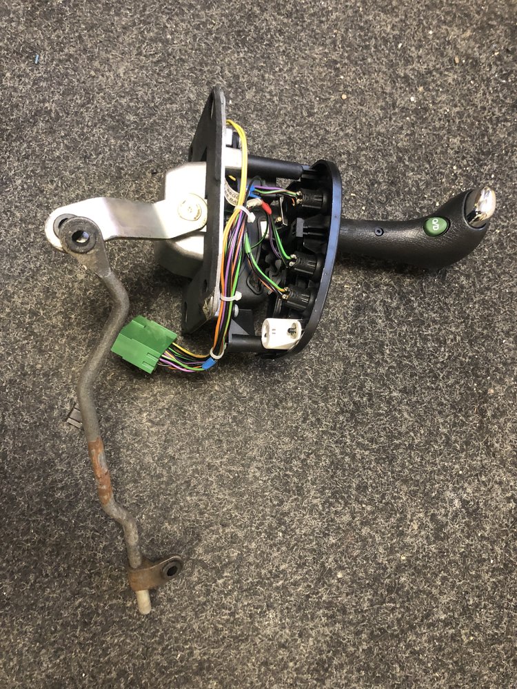

I am having a couple of days working on the project Scimitar GTC and one of the jobs is to replace the Granada shifter with the later Scorpio type. The issue I have is that the Granada shifter is male on the output lever and the Scorpio is female so I now have two females at the shifter coupling. It's not actually a rose joint but a stiff grommet in a hole that accepts the pin of the male and is then circlipped with a retainer. As I now have a pair of females, I could rectify the matter with a "back to back" male, sort of a pin with a washer halfway along it to act as a bearing surface.
Trouble is, I want it tomorrow so that I can get on with testing the shifter's physical position and get the mounting plate glassed in.
