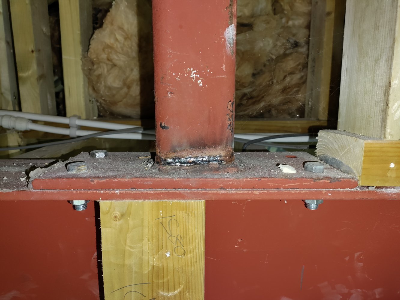

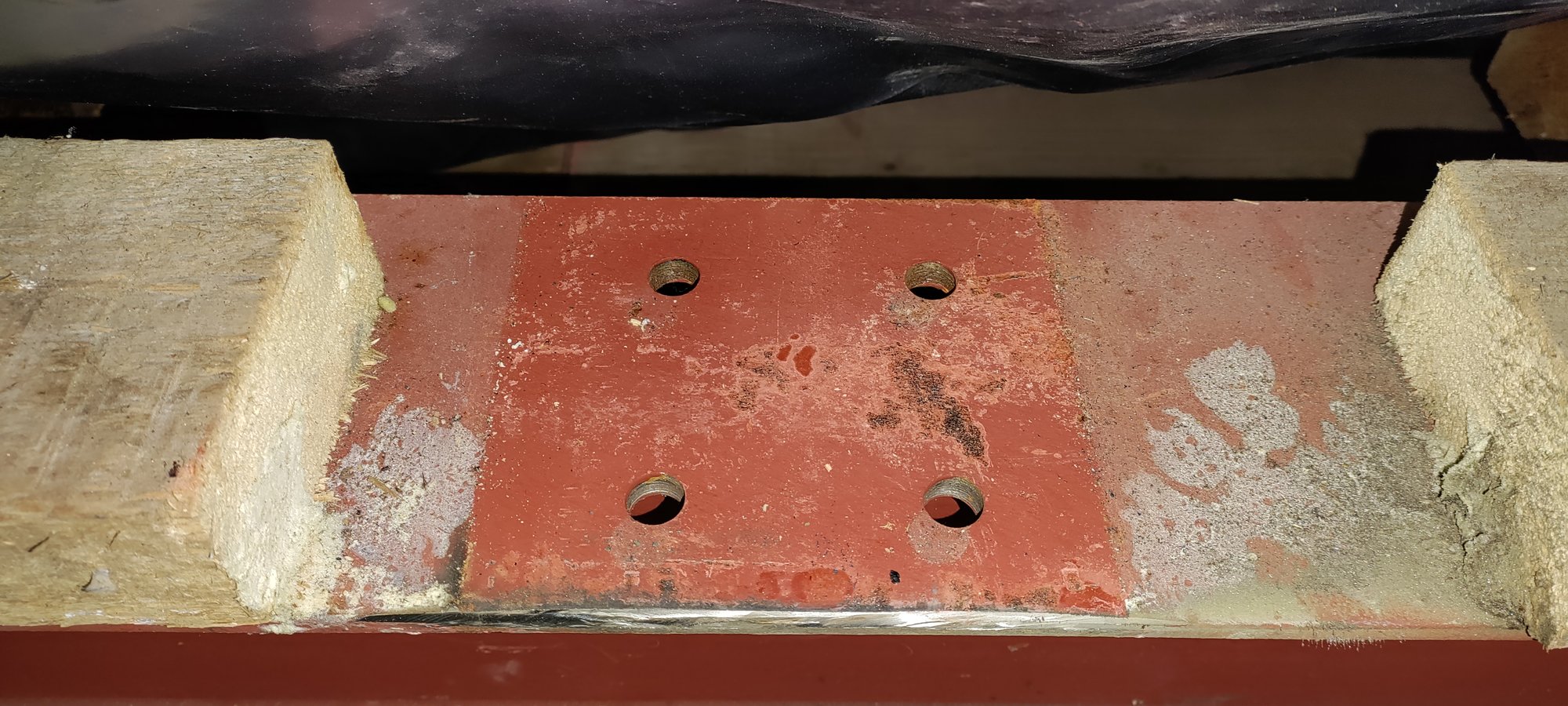

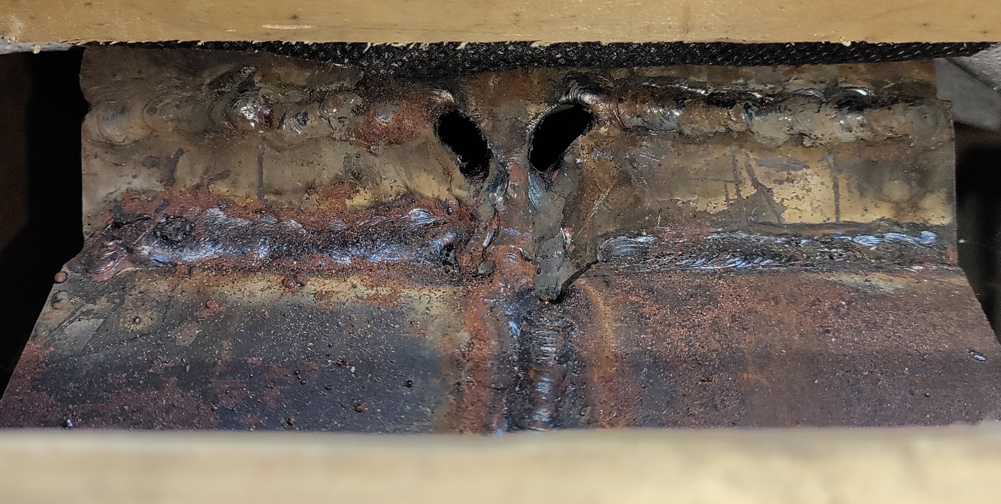

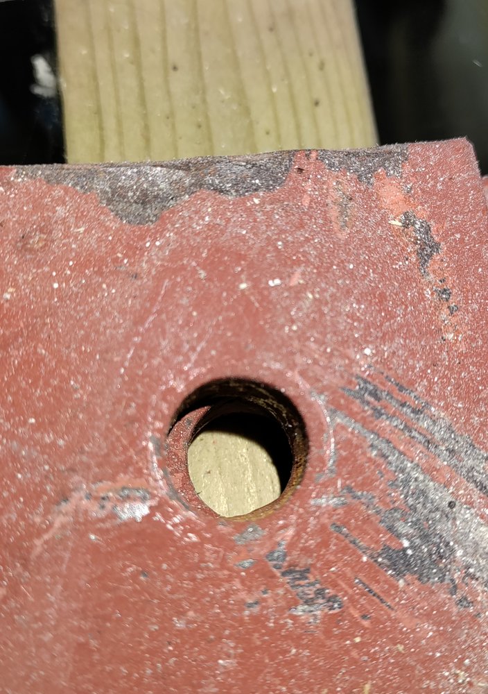

The load is straight down so that missing bolt isnt going to make a difference.I was just going through some emails between the engineer and the steels company and spotted that the engineer said that with the post supporting the cranked ridge beam, the baseplate is missing a bolt to fix it to the beam below, and they should do that... The steels company responded that they couldn't get access for the bolt, so it was welded instead.
The bolt hole doesn't look welded at all, so are they saying the plate was welded to the beam below? If that's the case, the only place it looks like it could be done is through where the upright post joins the plate?

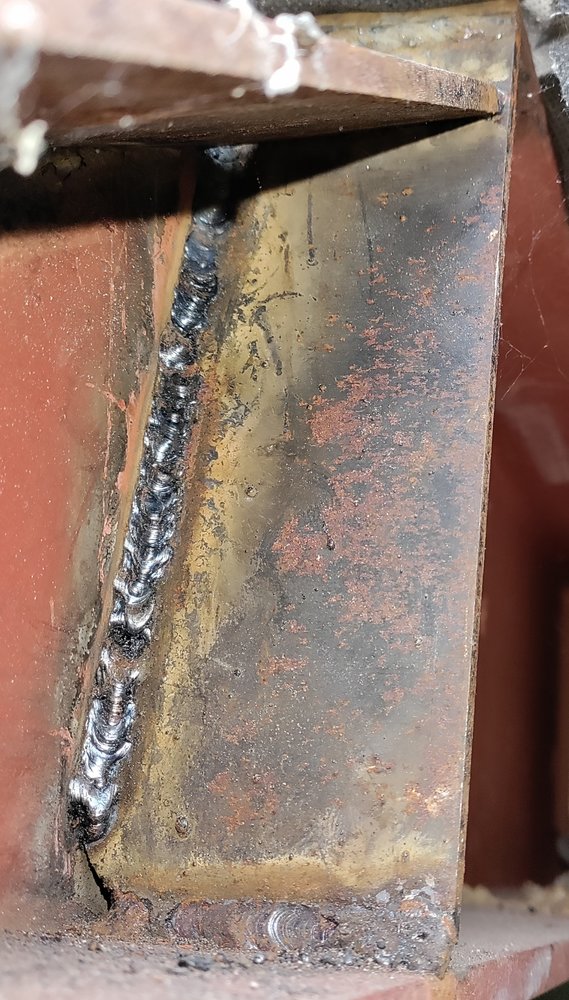

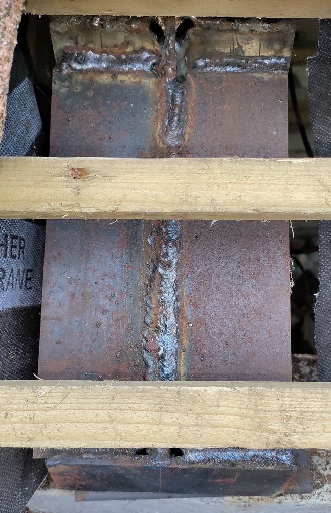

View attachment 411026View attachment 411027View attachment 411025

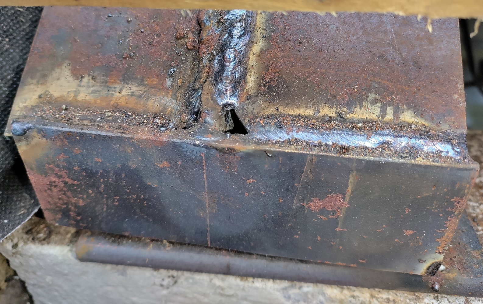

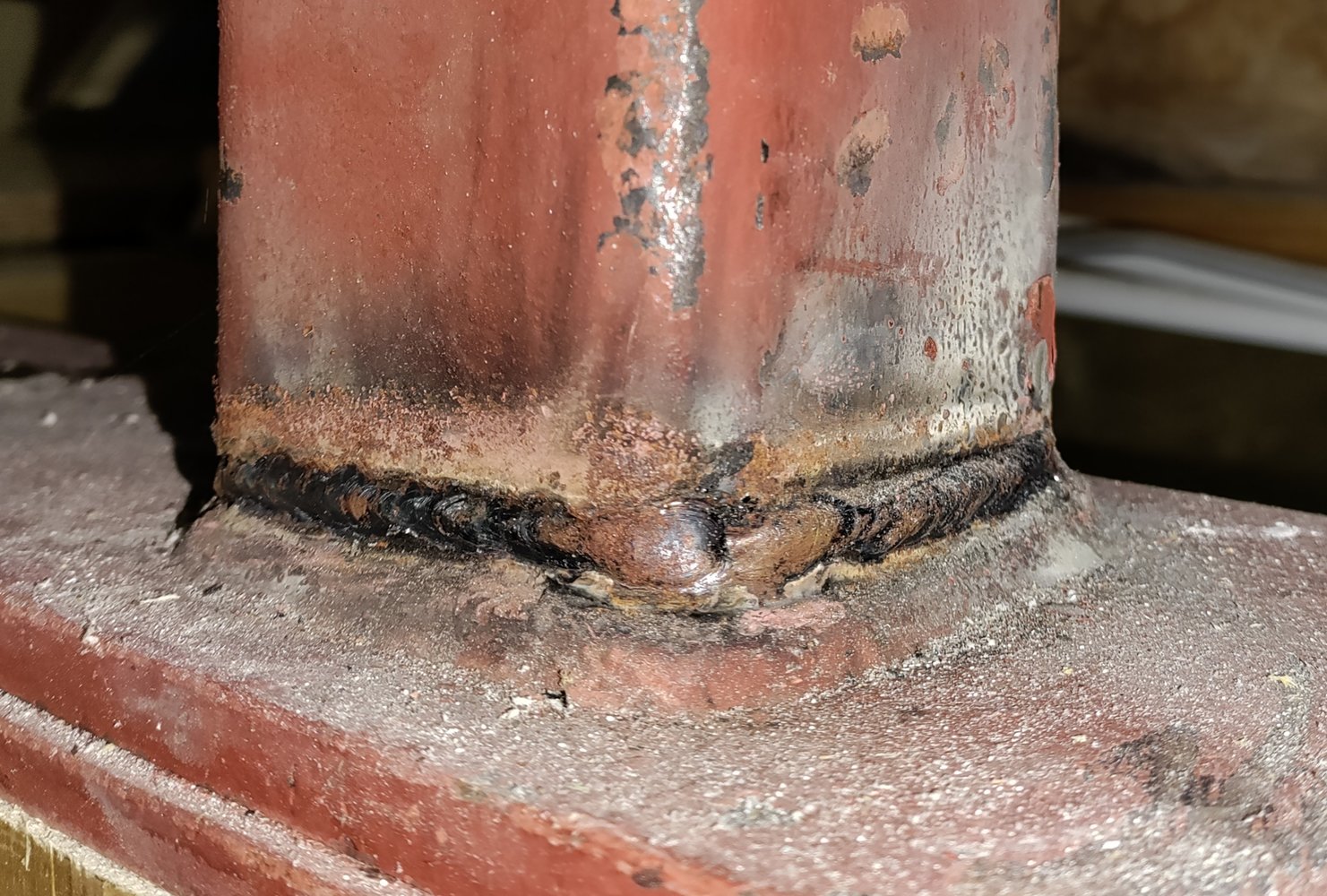

I think that's down to the plate they were using, maybe, or because that end is right up against the breather membrane under the roof?That second picture in post 48, looks as if they've not even cleaned the slag off.
And for new work, why all the corrosion? Post 46, specially second photo.
Too bone idle to clean the mill scale off before welding!I think that's down to the plate they were using, maybe, or because that end is right up against the breather membrane under the roof?
They left the rest of it behind and it looks a bit rusty -

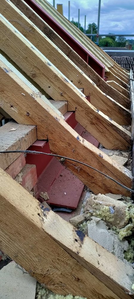

Nice to see an update, all too often we never get any closure. Old steel fab company want shafting royally, the work done is embarrassing!Apologies for resurrecting an old thread, but I thought it'd be worth updating...

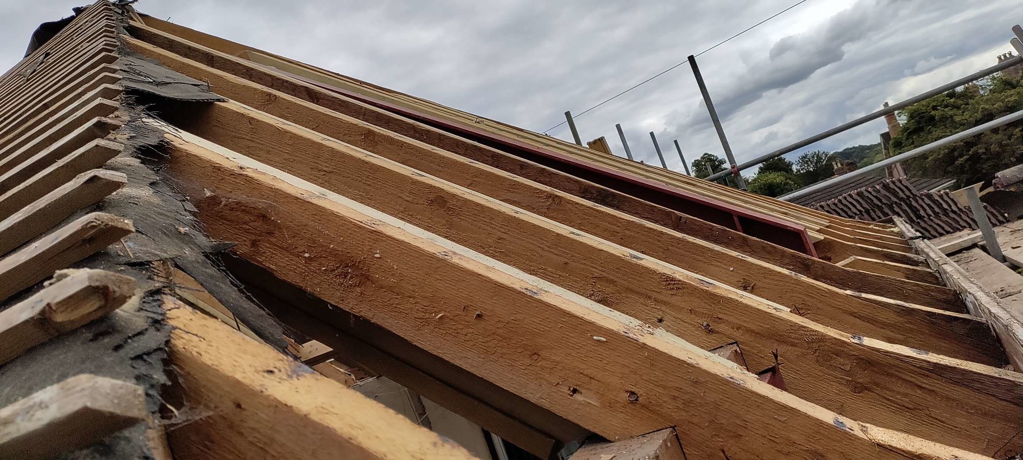

Thanks to the rest of the building work being so bad, everything down to the tops of walls had to be taken out and rebuilt... so it's been a bit busy here!
The new steels look... like they actually should. fitted without a hitch, and now have the proper bearings, and real pad stones, rather than brick-sized chunks of lintel. All coated and rather pretty looking - it's almost tempting to leave them visible, they look so good! The steel company was happy to talk to both the BC officer and structural engineer to confirm everything, and building control have checked everything off and are happy.

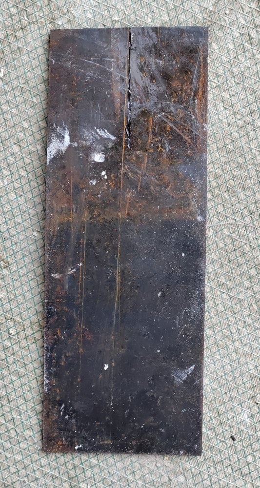

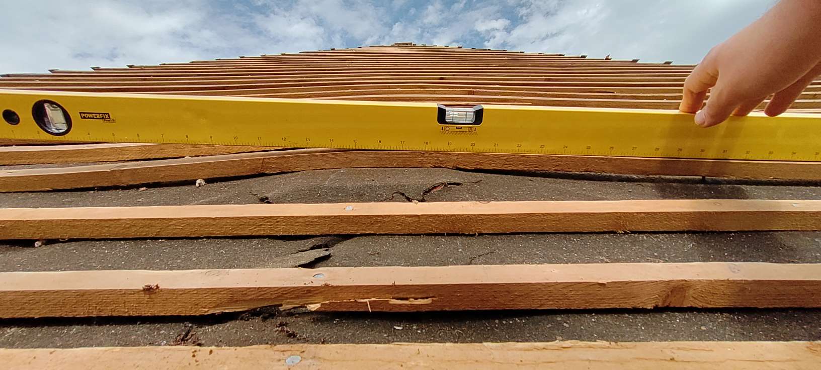

As for the old steels lot... turns out it was worse than I thought even up to that point. It had been fitted/measured so badly that bottom of the cranked bit had actually been forced through the front of the roof, tearing the felt and breaking and bending tile battens. It looks like maybe it was the wrong angle, too, as by the top of the roof, it was below the rafters...
At least that explains why they were hitting that upright post hard enough to cave it in - they weren't just moving the steel, but the roof as well!
View attachment 444386View attachment 444387View attachment 444389
On the plus side - it came down very easily!
They've had a letter before action, and have agreed to a meeting to discuss... Fingers crossed they do the decent thing. View attachment 444388
