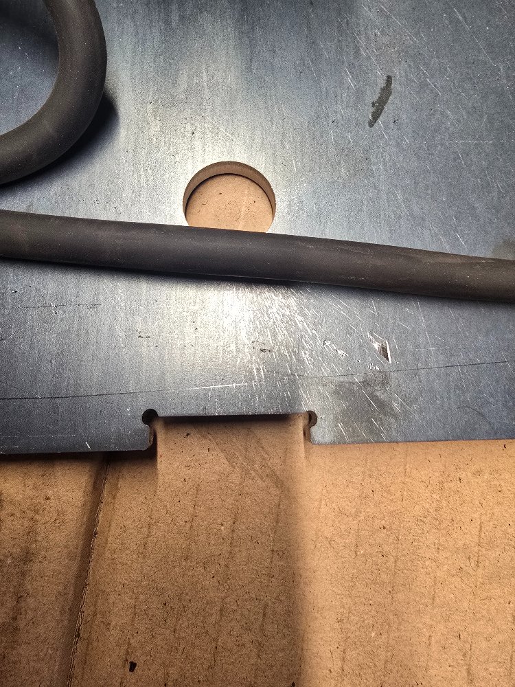

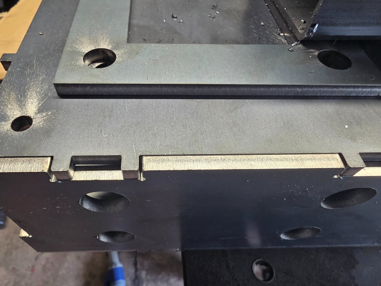

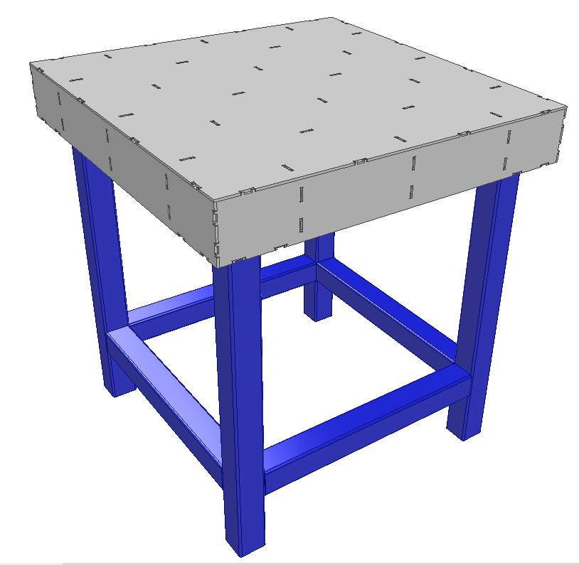

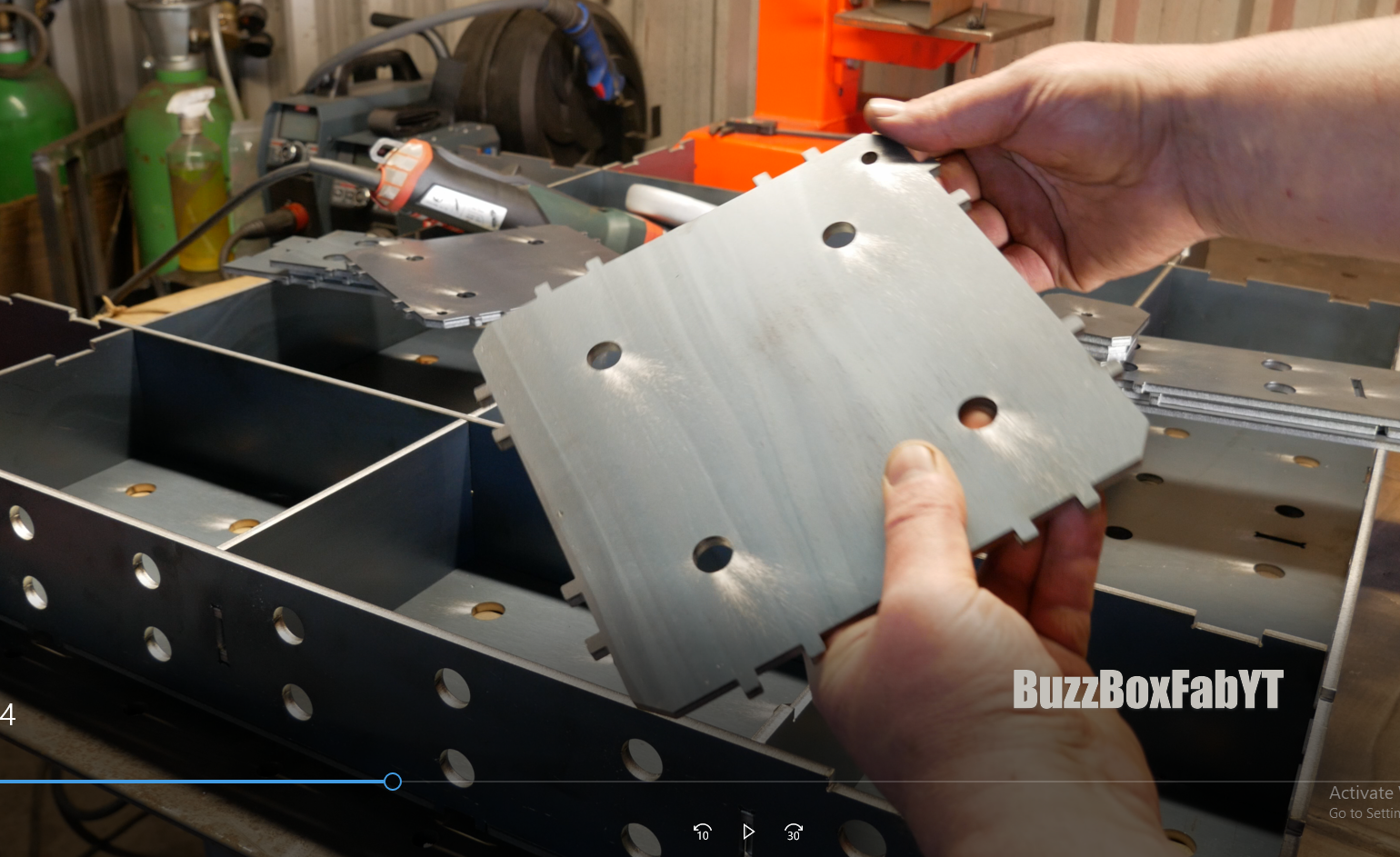

This has been at least three years in the making, and during that time, it’s changed quite a bit. I finally got the parts laser-cut; I just need a spare day or two to throw it all together.
I realize there are 'welding tables' and then there are welding tables. To be honest, I never really needed this—for me, it’s just the fun of building things and playing around in CAD—but it will get used.
The pictures show it loosely mocked up to check that everything is there. I still have to break it down and do a little bit of prep work. There were some strange goings-on with two of the slots (see images); it won't affect the assembly, but I’m guessing the issue is in the drawing, so I need to check and correct that,I think I was a little too generous on the slot size to but it will be ok,
Total so far:
£306: Laser cutting materials (plus VAT)

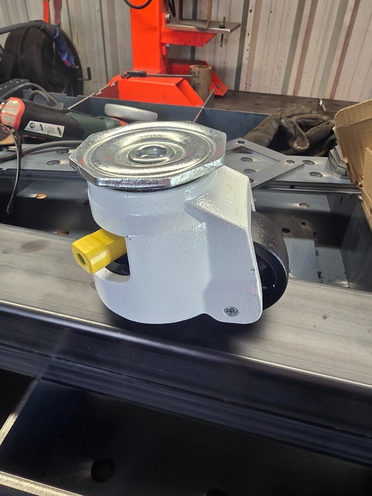

£129.24: 7.6 meters of 80mm x 80mm x 3mm tube (inc. VAT/delivery)
£53: Caster wheels
I might knock up a 1x2 meter version using a thicker top and a smaller hole arrangement at a later date. We'll see.
