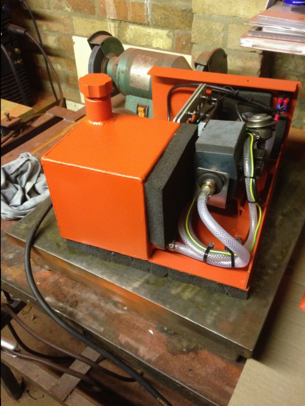

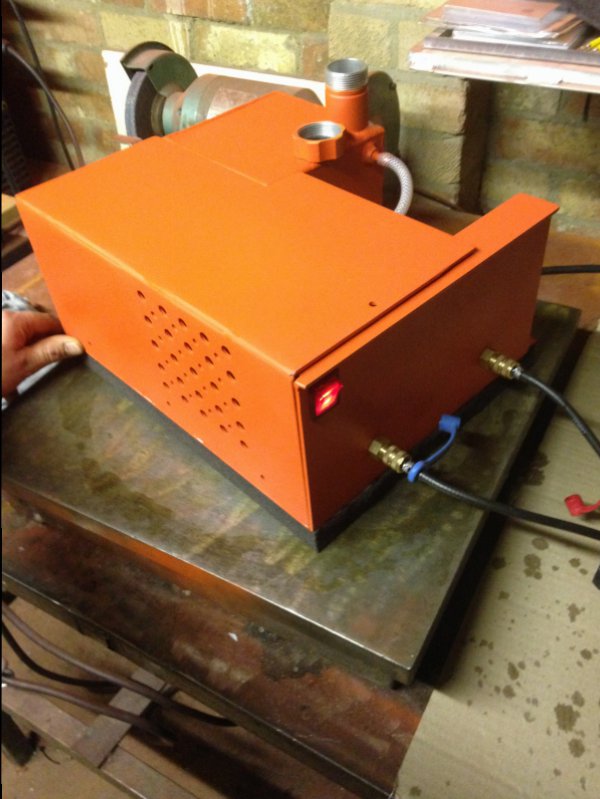

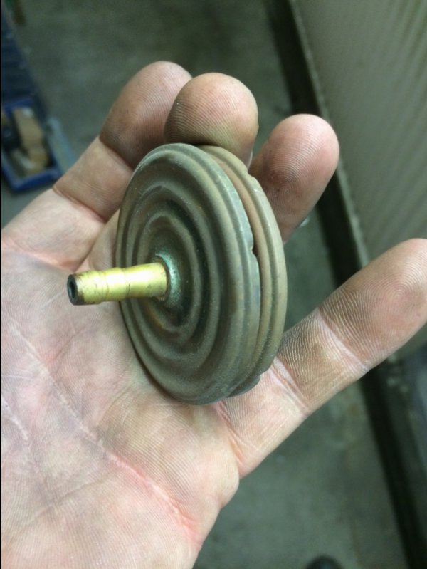

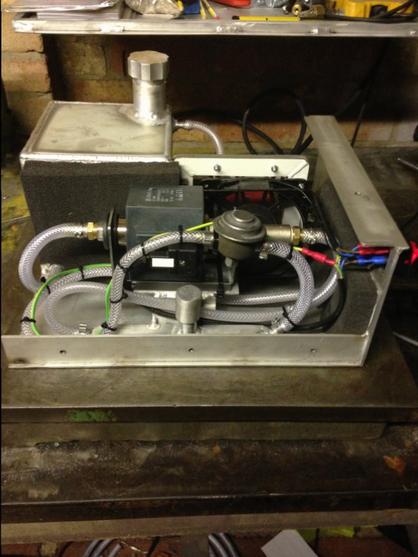

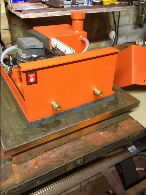

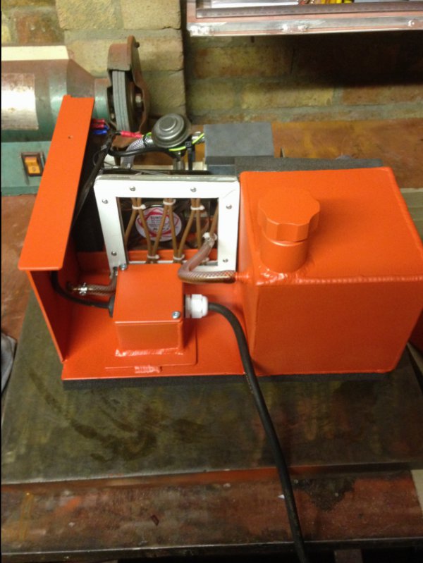

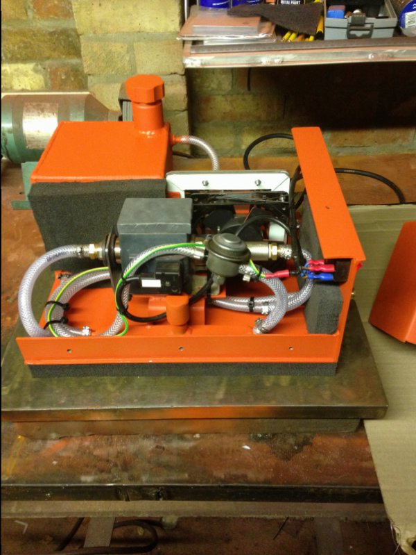

You were dead right maker! I was just reading through the thread and an accumulator is exactly what it needs to quiet it down so I was wrong. The home made dampener does a job of keeping the vibration down but I'm still not happy with the noisy pulsing effect. It's really the only downside to this delightful little pump as it's brilliant in every other way. Gonna be a hand in pocket moment I'm afraid and get one on order. Space is getting Tight right now so I've selected a small Bosch fuel pulse accumulator and hopefully that will be it. It should be completed and ready by end of month easy. Fitting in the odd hour on it now is getting difficult but it's almost there. If the pulsing wasn't an issue she's be painted by now.Could you reduce the pulsing of the output with a small accumulator?
The colour gives it away but it can't have the name

Nope no names. Little "made in England stamp maybe ".The colour gives it away but it can't have the name
Home made damper has eliminated it all together. Took 2 different design types to do it mind but learnt a lot about how they work. Thanks anyway though Jim. Very kind.If you didn't get over your torch pulsing issue there is an off the shelf part that solves it if you're interested?
