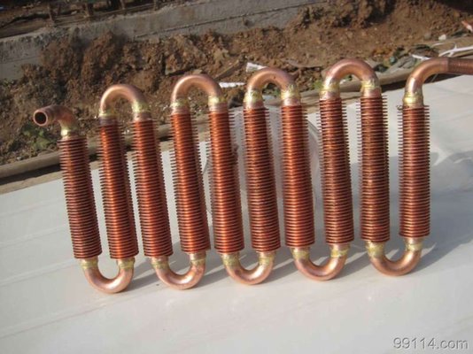

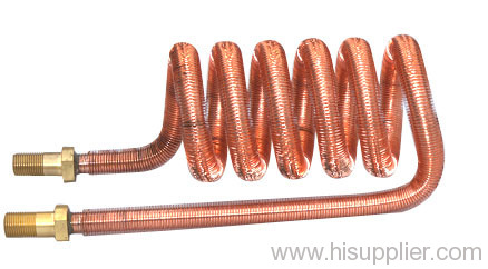

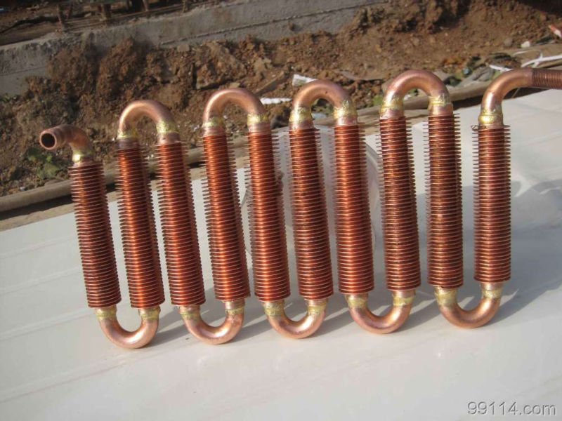

Computer brushless dc pumps and heat exchangers would be very good for this. I'd recommend using 6mm OD hose, it will be adequate and give a lot more freedom at the torch end. What are you using to cool the torch?
