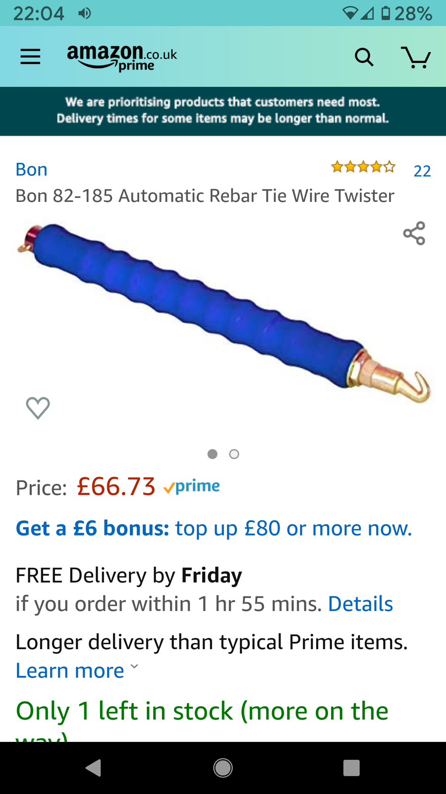

Aye. Not sure why the pic I posted above says 66 quid. Range between 12 and 40But they already exist and are very cheap

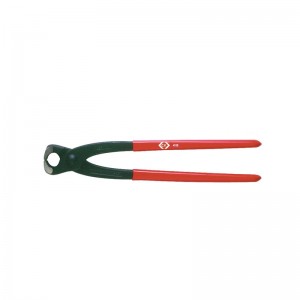

im a end cut pliers man myselfAye. Not sure why the pic I posted above says 66 quid. Range between 12 and 40
See I prefer these .View attachment 224653
Once there tied squeese harder and they cut.

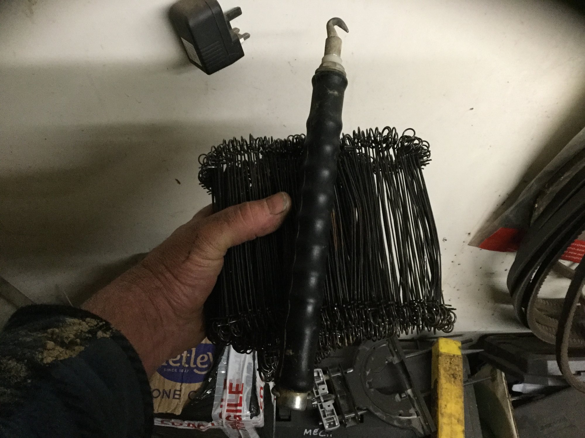

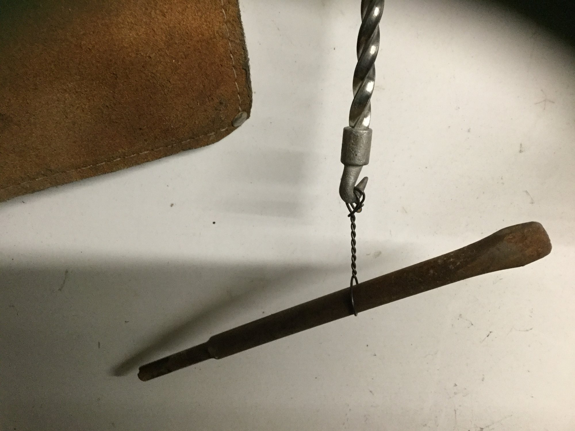

The proper tool is only about a tenner https://www.ebay.co.uk/itm/Rebar-Ho...514257?hash=item56cc952691:g:wSoAAOSwKKZdnGAs
Nothing quicker and easier on reo than buying the looped tying wire pre made and one of those tools. No need for snips.
Bob
View attachment 224654 View attachment 224655

In addition a drill with a rod in the chuck and a hook bent into the free end of the rod works really well too if you keep an eye on what you are doing and dont put too many turns on for the continuous loop stuff.
I also have the ties and twisting tool @8ob posted, that may have been found in a clearout at Petter's in the early 80's and that is useful for twisting up Mig wire for Tig welding.
