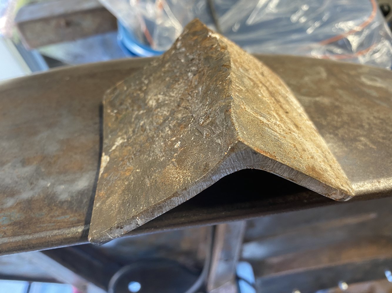

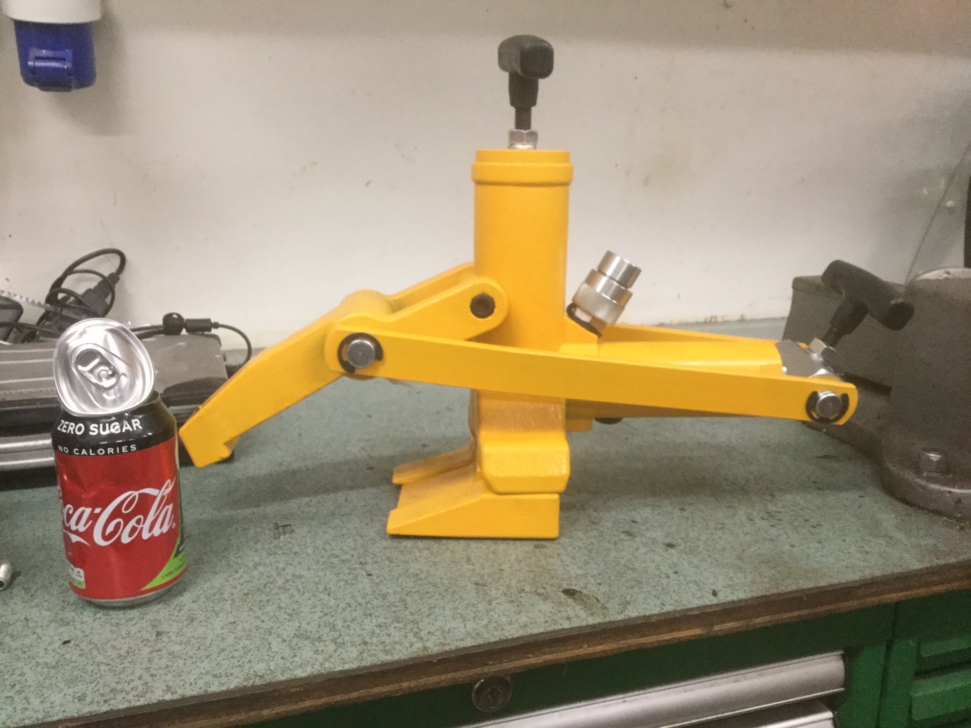

The bead is a smaller diameter than the edge of the rim. If you squash the tyre with G clamps or similar, at the accessable diameter, they will generally slide off, and I tried many ways to try and stop that. ususally takes 3 clamps and still slides off. Hours wasted trying!
I have not tried a vice, dont have one large enough, the wider, grippier jaws of that may be more successful.
If the jaws move in an arc towards the smaller diameter, it works better.
The Stenor is bloody brillant, literally seconds from picking it up, to poping the bead. Some occasions with the clamps took me hours of messing about on the stubborn ones.
) - it was that badly corroded on that it spun the tyre on the machine when I was trying to get the first side off. Got it off but was very close to cutting it off.
