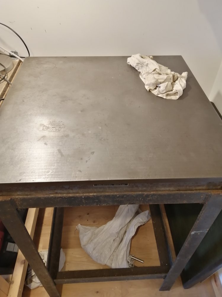

judging by the strokes from the knife, this slab is planed. There is no qualification to check the paint print.ps We picked this up yesterday for a good price - Windley 2' x 2'. There's a few unknown blobs that need to be removed, is acetone the best thing to try to dissolve them?
Yes it’s a grade b plate for marking out etcjudging by the strokes from the knife, this slab is planed. There is no qualification to check the paint print.
“3 slab method.”Yes it’s a grade b plate for marking out etc
The shiny bit looks like its been abused for lapping or something.Yes it’s a grade b plate for marking out etc
That's a reflection from a lamp.The shiny bit looks like its been abused for lapping or something.
