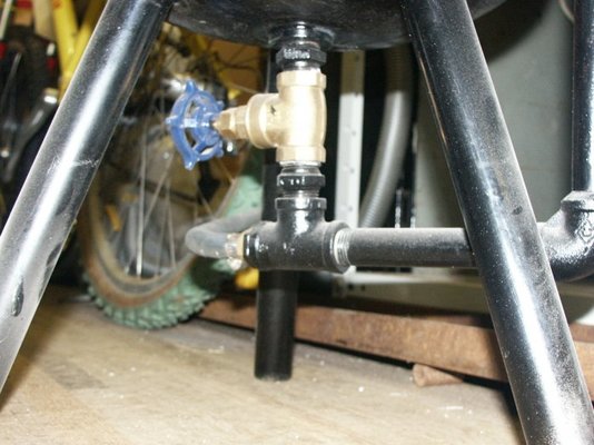

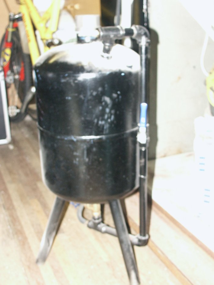

Here ya go. Works very well. The outlet pipe is 1/2" Aircon pipe used in Vehicles just something I had, all the fittings are 1/2"BSP Gas. The Lid is a 2" Gas Pipe Stab Cut in half.
I already have designs on MkII, so I don't have to faff about scooping the media back out of the cabinet
i had a go this afternoon and within a minute or so had turned a manky, rusty old 205 suspension top mount to this
