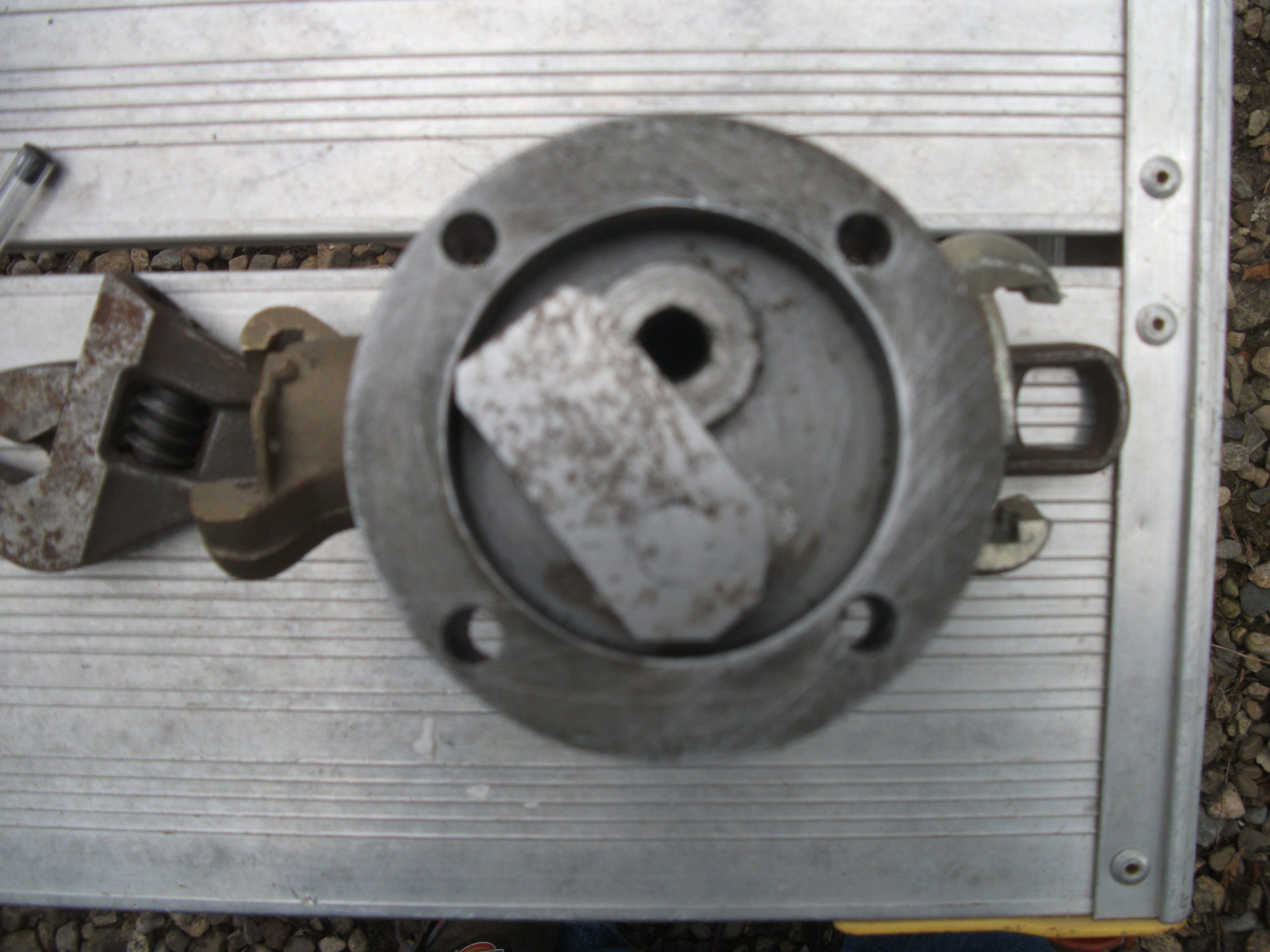

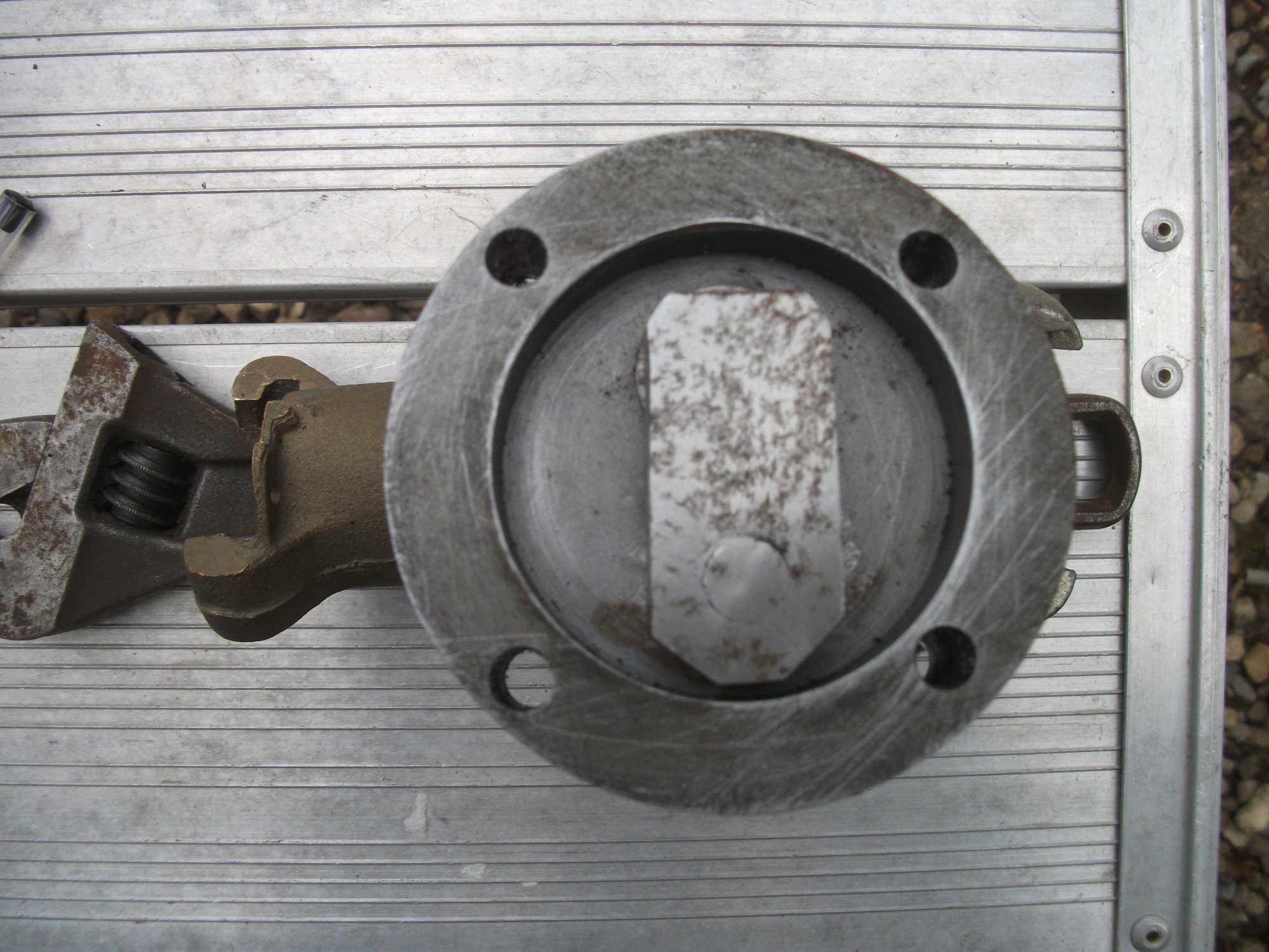

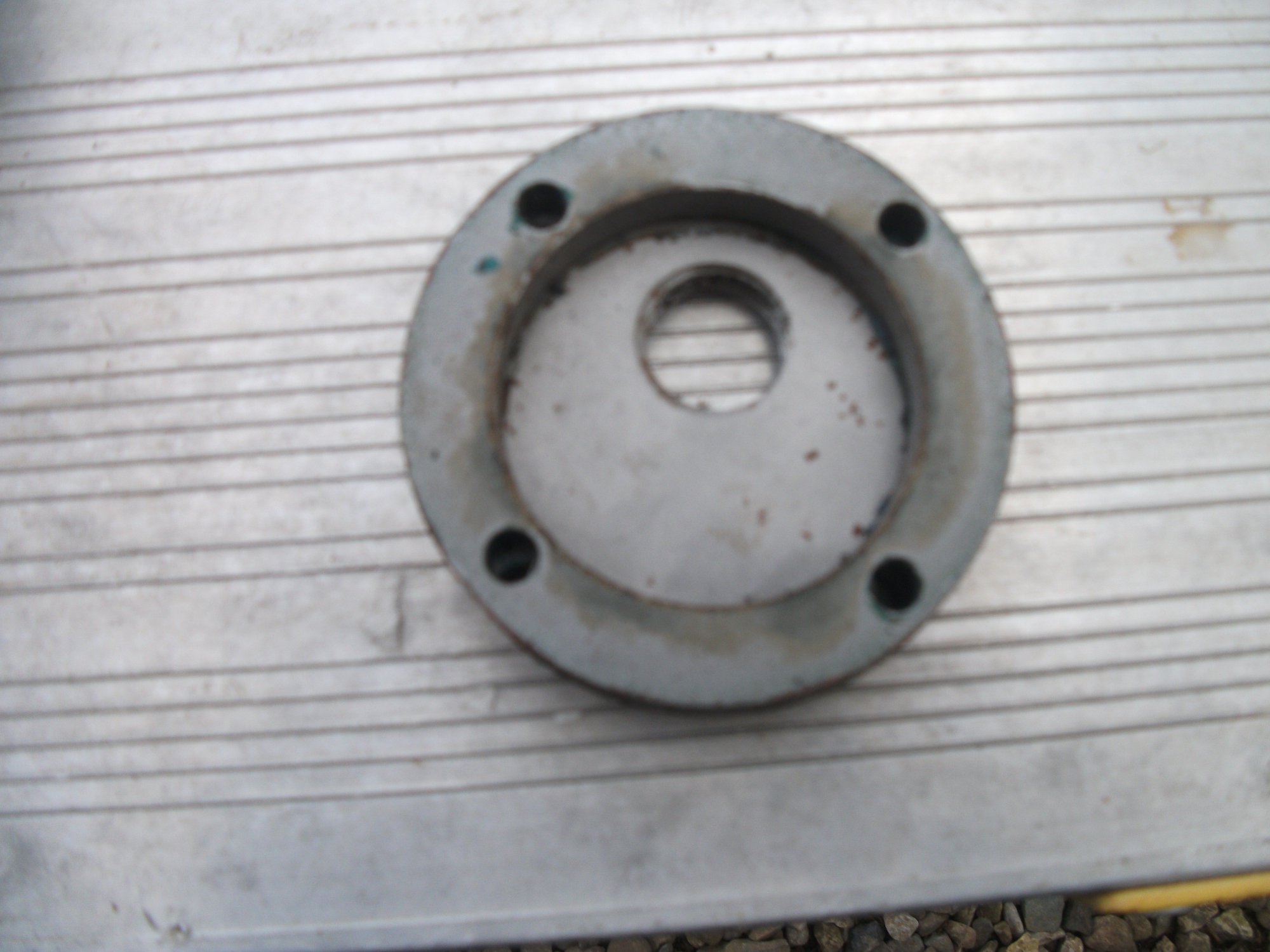

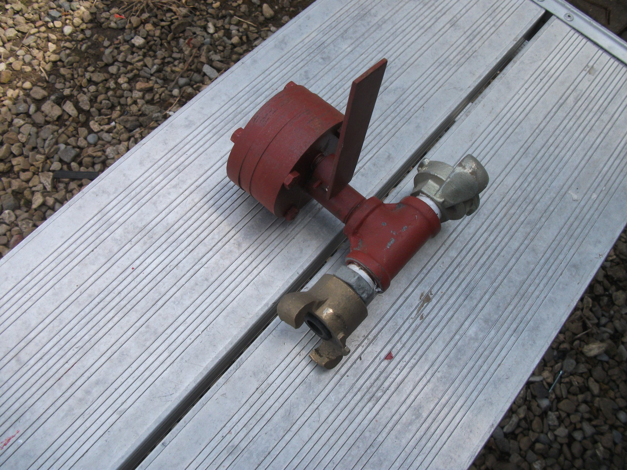

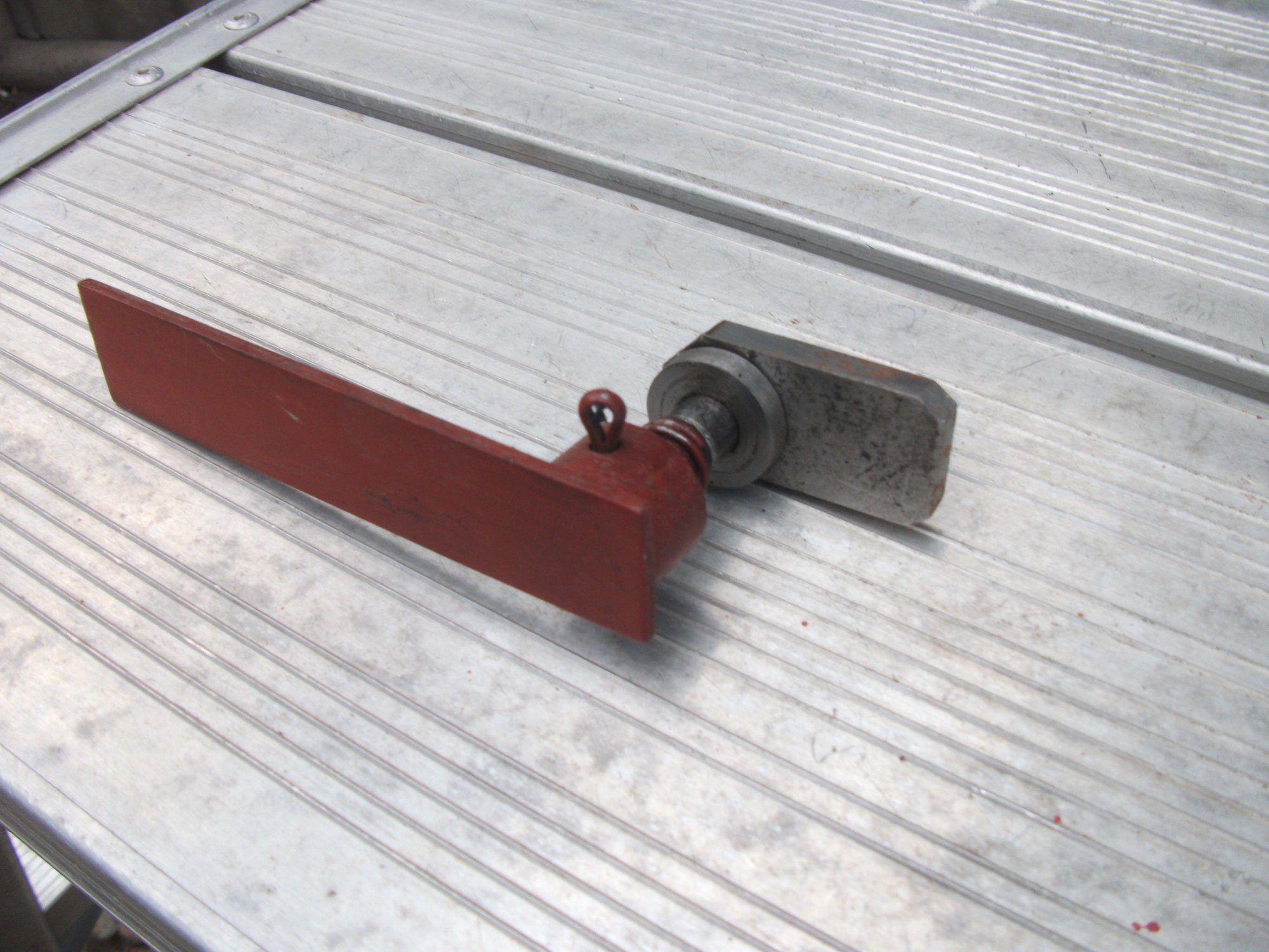

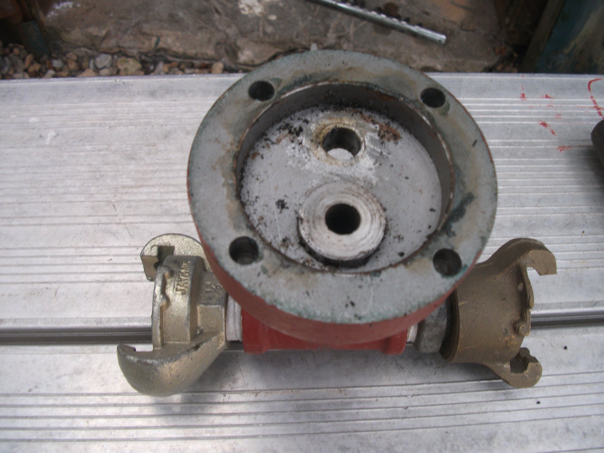

The valve was a bit restricting, though not as bad as the funnel supplied with the pot, and it eventually needed replacing. I didn't have to modify the pot though.
If you're starting from scratch go with a big hole like BS says, but bear in mind the larger the filler cap the more force there is trying to push it off.
