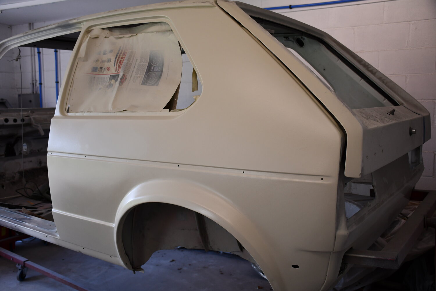

I'm rebuilding a 90's Lancia and approaching the end of the bodywork stage. I've epoxy primed the underside, applied seam sealer and this weekends job is to apply Gravitex which will finish off that part of the project.
The top side is in pretty good condition with most of the factory paint in place but the plan is as follows;
Strip to bare metal where possible
Epoxy prime with Lechlar 29107
High build prime with Lechlar Green TI then block to achieve a good finish
Epoxy again to seal and prevent water ingress
Top coat with Max Meyer Duralit 2k acrylic solid
Does this sound like a reasonable process to follow? I've read so many threads that my head is swimming and non of the manufacturers will claim anyone else's products will adhere.
