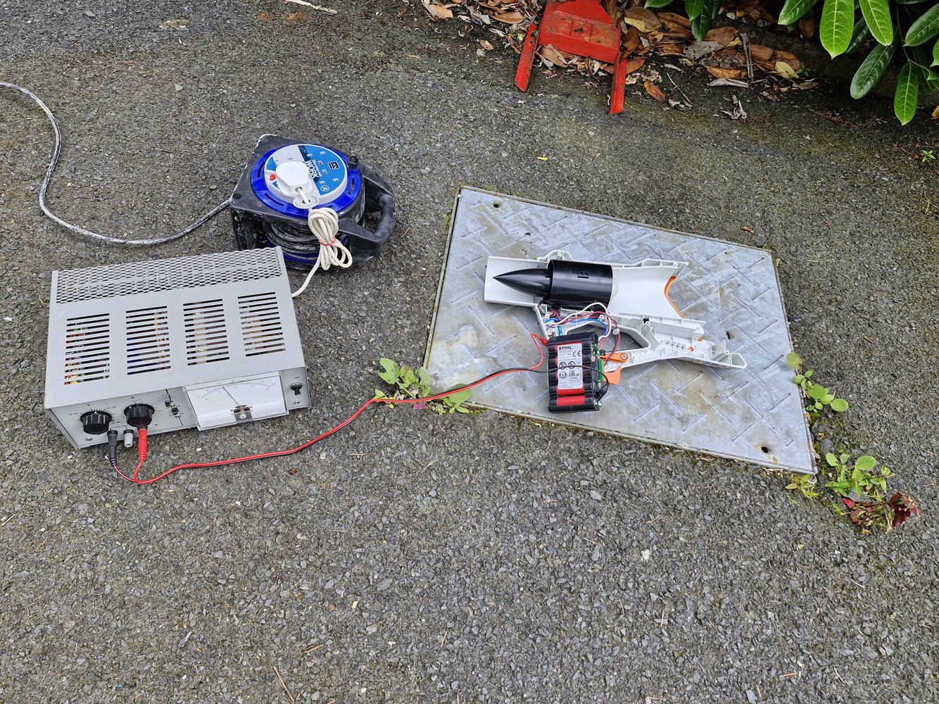

The ideal way of charging singly would be to use either a dedicated lipo charger that has a single cell facility or you carefully use a variable bench power supply with current limiting, set to 4.2 volts and around 200mA…I figure since the cells are spot welded in series I cannot individually charge them? Or how is that done please?

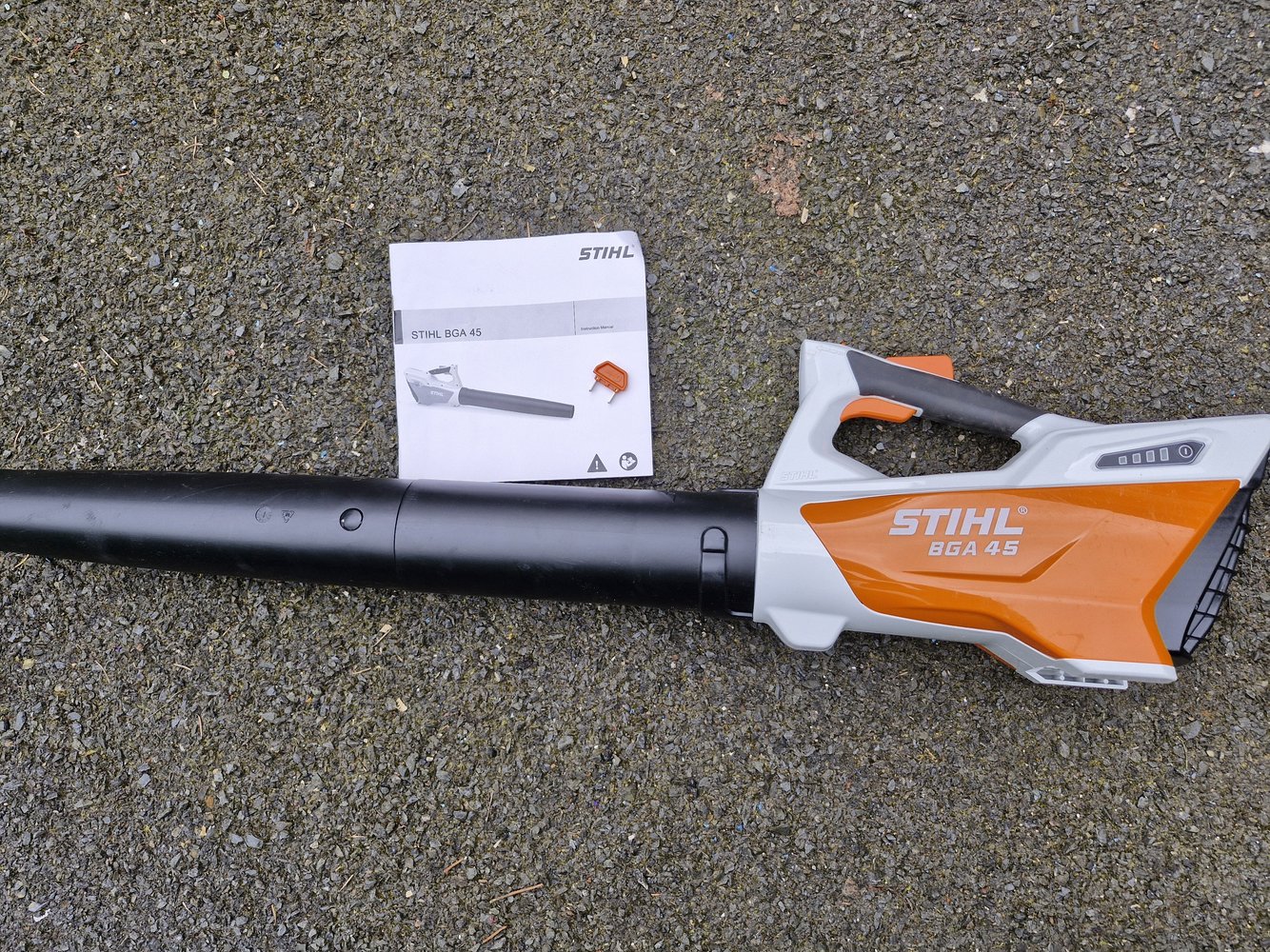

I have 2 of them for my model planes…Thanks for the tips- cost wise don't want to spend too much on this leaf blower so ordered one of these hopefully it's better than the little crappy dc adaptor Stihl supply
How exactly?Are the cells being individually monitored during the charge? If not, then charging a string of Li-Ion cells is a recipe for disaster.

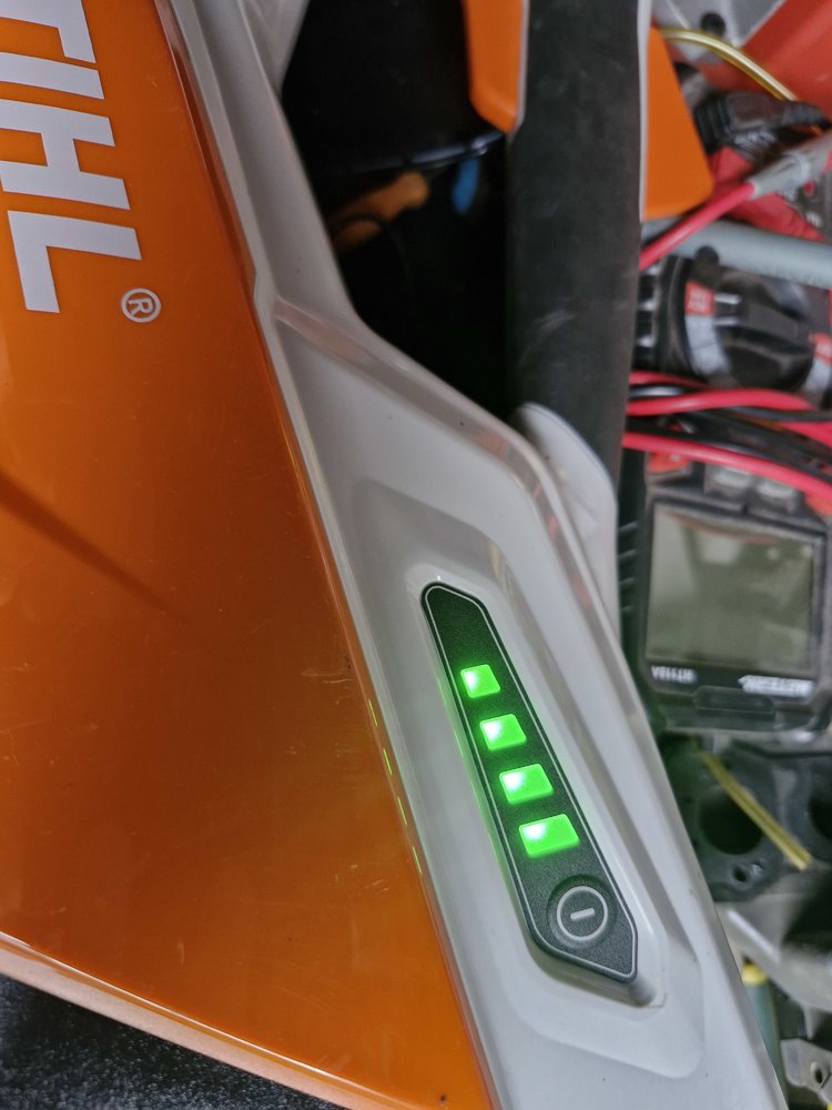

Just been looking at some DeWalt battery packs, and the pin connections on all the packs are labelled: B+ TH ID C1 C2 C3 C4 B-Yep it charged up fully just fine and fully working. Not sure what was up with it as the power supply was only attached for 3 mins max so it couldn't have added much charge. But anyway very pleased it is charging and fully working. If it needed a new £100 battery pack it was scrap so good to save it. And it's actually very handy for clearing out my garage floor too
